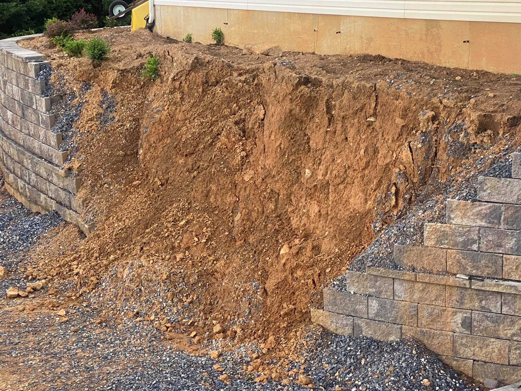

No, not my wall! But rather a new large housing development up on a hill just finished this retaining wall a few months ago... then the biggest rainfall we've seen in years in San Diego came. Could have been worse, I guess but then again this is a pretty big failure in my eyes.
The wall I installed right around the corner handled the rain with no issues. But then again it has 30 yards of crushed rock in it. :LOL:
