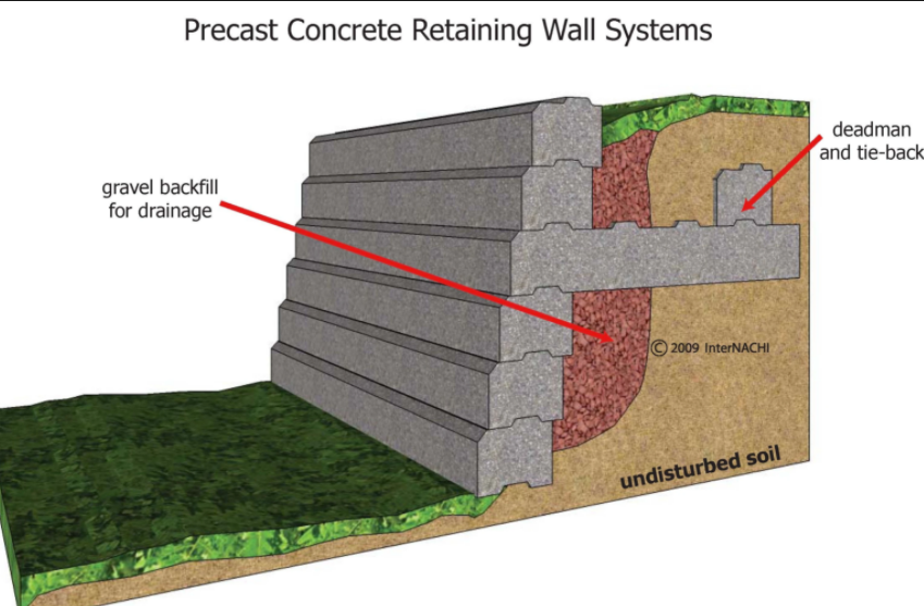

I have always wondered why tall walls do not have rebar and concrete poured into the block plus lots of "dead men"
If it is only about cost, it would have been cheaper to do it right the first time.
/ Retaining Wall Failure #33

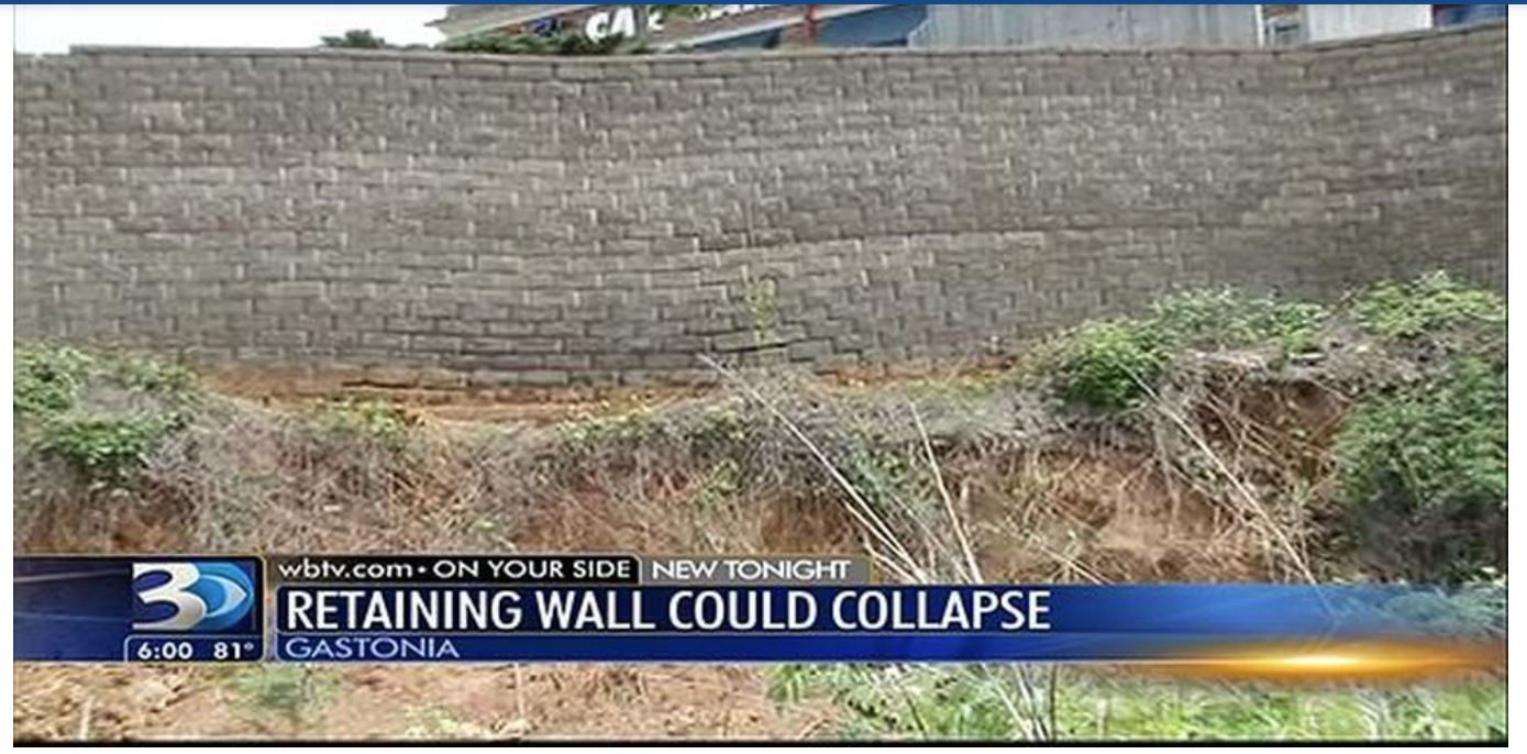

I have always wondered why tall walls do not have rebar and concrete poured into the block plus lots of "dead men" View attachment 728667
Block with rebar and concrete still needs engineering - and they still need proper installation to that engineering.
I have seen many, many block walls fail.
I have seen and built very high segmental retaining walls in earthquake country, used as bulkheads at shore, and other difficult situations. They are usually stronger than block walls when properly designed and constructed.
see post #12

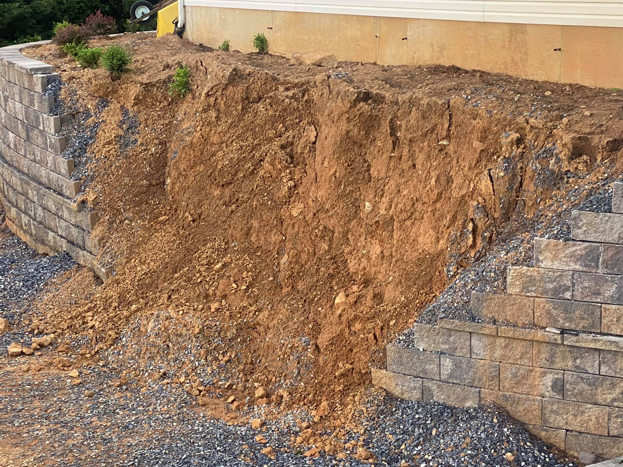

Had a customer call for help this past year. Found this
Wall is about 12’ high. That is their garage that they had built/attached to the house above.
Cost for this wall and another built by the same contractor was about half of what I would’ve expected….there’s the answer as to why.
This is outside my scope of work, so I passed. I’m not a wall guy but I have some knowledge, zero drainage, zero geogrid, not enough rock behind. No engineer involved.
