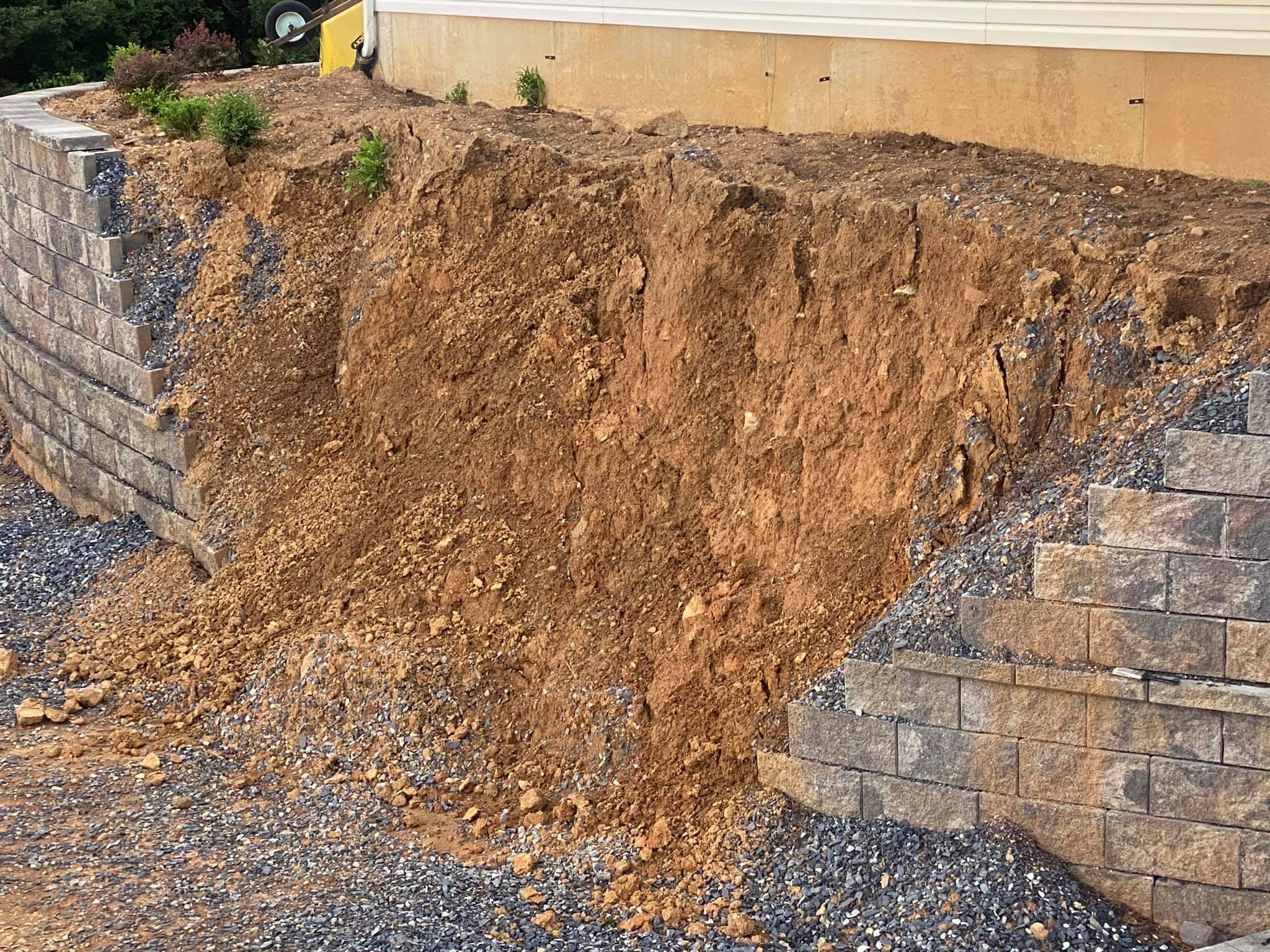

/ Retaining Wall Failure #44
Had a customer call for help this past year. Found this
Wall is about 12’ high. That is their garage that they had built/attached to the house above.
Cost for this wall and another built by the same contractor was about half of what I would’ve expected….there’s the answer as to why.
This is outside my scope of work, so I passed. I’m not a wall guy but I have some knowledge, zero drainage, zero geogrid, not enough rock behind. No engineer involved.
Any weight placed above the wall within a plane of 45 Degrees of the bottom of the wall is a surcharge. That garage places a huge surcharge on that wall. That particular wall is designed to fail!

I don't know if there is a fix for that wall other than taking it all out and starting over. How that ever passed an inspection is beyond me. How they ever got a permit to build the garage without documentation, including permits and inspections, of the supporting wall is beyond me.

Absolutely, I told her to start with an engineer and the wall along with the second one, should come down and start over, but her starting place needed to be an engineer.
If memory serves correct, the garage was built before the dig out, to create the flat area below the wall for a basement walk out and pool area. But no idea on permitting or inspections.
Like I stated I repeatedly told her that it was outside my scope and only shared observations, pushing that she needed to start with an engineer.
Theoretically, the engineer could design a wall that is the same distance from the garage as the height of the wall including the underground portion.
Now moving it that far from the garage would still mean that the new wall would not be on the failure plane of the swimming pool that is in front of it. the garage would require shoring during construction.
I say theoretically because a smart engineer would walk away from this and not end up in a court battle as a defendant or a witness.
These cases get very ugly, with both sides bringing in their expert witnesses.
It could get very expensive and might include at the engineer's recommendation, to remove the garage, the wall and the pool!
You can imagine the expense when contractors figure out that it has to be done and that everybody with anything to do with the project will be looking for somebody to blame.
In my day, I walked away. I wanted nothing to do with these kind of legal problems. I had a long and successful career!
