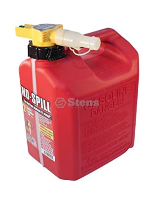

I buy this style gas/diesel can. The nozzle has a good cap, and the button releases gas when and how you want it. The short nozzle means you probably need a funnel to fill your car, but it works great with a tractor or riding mower.
We use these for 2 stroke fuel but what you must be carful and what I don't like about them, is they can't vent any presure if they are allowed to warm. They will blow up. The steel eagle can lids are spring held down and will vent if pressurized.

I have 4 of these...2 for gas (a 5 gallon and a 2.5 gallon), and 2 5 gallons for diesel.
If I see them starting to bloat, I just hit the pour button to vent
FYI, I don't leave any of the cans outside or in direct sunlight
