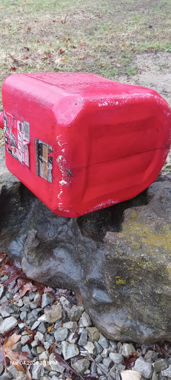

The seam on the bottom where both halves were "welded" together split enough to leak out all the gas. Notice the seam is black while the side seam isn't. The white stuff is where gas dissolved concrete floor sealer, which then dried on the plastic.
/ New Midwest Gas can fail #8
It isn't actually welded, per se. They are blow molded and that is the seam where the parison melt gets pinched off by the mold, prior to inflation. But that doesn't look like a No-Spill brand can. Perhaps just cheaply made?
What brand of can is that in the picture ?
To me it doesn’t look like the No-Spill brand cans I have but maybe it a different size ? The one of mine with one side sucked in is supposed to hold 1.25 gallon, with the side sucked in it still holds over 1 gallon so I’m still using it. But the can happens to be empty right now so I brought it into the house where it’s warm to see if the heat might have any effect on getting the one caved in side to expand back out.
Midwest Can Co. 5G size. I don't recall ever saying otherwise.
