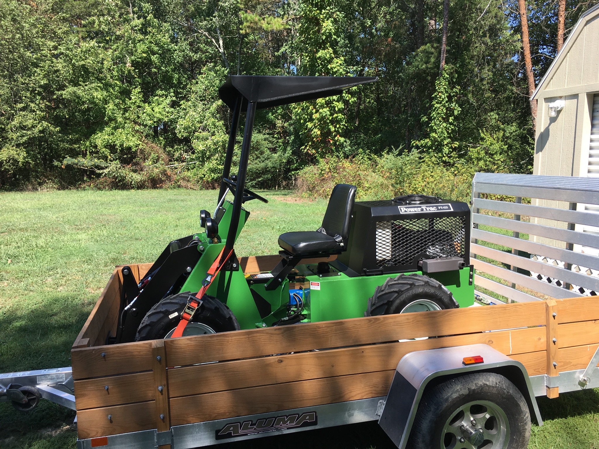

I promised an introductory post once I got to use my new PT a little, so here goes...

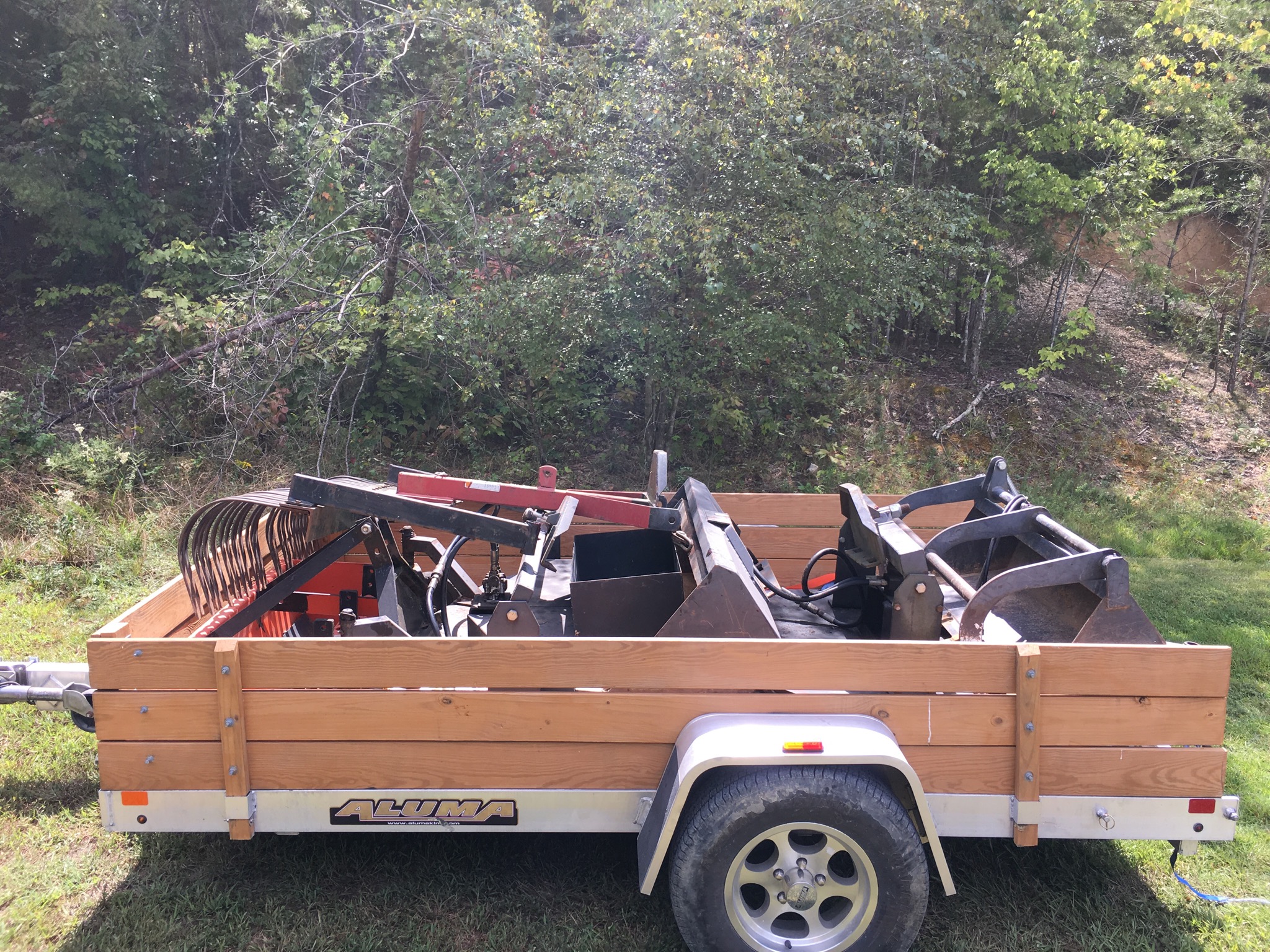

I picked the PT-425 up from Tazewell on 9/2 along with a mini-hoe and stump grinder. The following day, I went to KentT's and picked up his all eight of his T8 attachments that he was selling. I finally got a chance to unload them and check the machine out today... I must say I am pleasantly surprised! It truly is amazing all the work you can get done in such a short amount of time.

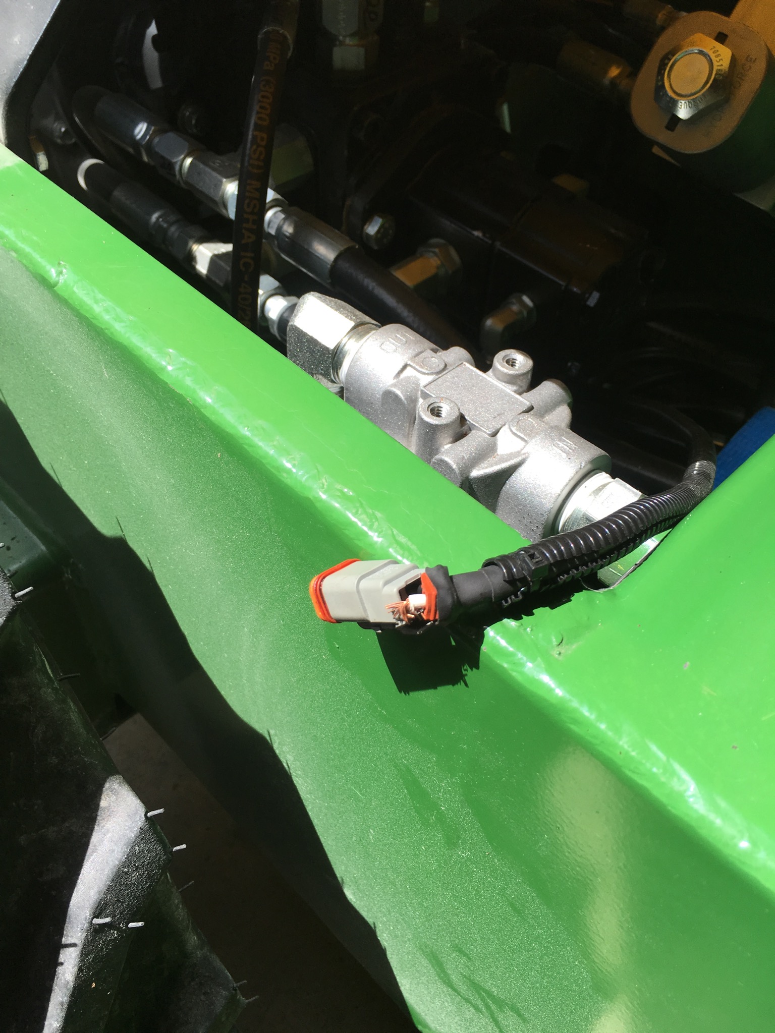

When I installed the brush cutter, the PTO would not operate. Thought maybe it was a disconnected wire again, but no such luck. Further examination revealed that one of the wires was not properly crimped into the PTO solenoid wiring harness... it was just hanging loose. I was able to get it working, but no way could I make it as good as it should have been from the factory.

Now for a couple of pics...

Those are nice connectors, all mine are ugly old style crimp radio shack.

I use Del City and West Marine for high quality crimps. For mission critical ones, I use the crimps with low temp solder balls in them. For the rest, I use the heat shrink type with an inner adhesive layer. That adds strength, and waterproofing.

Glad to have you here, and good to see that you got everything home and unloaded safely! Getting 8 attachments loaded on a 6x10 trailer so they could readily be unloaded was a bit of a puzzle, but I'm glad to see it worked out OK.

1. Concur with the recommendation for Teflon tape on the gas tank fitting. Just make sure that when you wrap the fitting, make sure to wrap it far enough back from the end that a couple threads are exposed. That helps prevent it slicing of a sliver of tape when you screw it in, and that sliver getting into the gas line. If that doesn't stop the leak, I"d insist that Tazewell ship you a new tank. Cross-threading it initially may have destroyed the threads.
2. I hate crimp on electrical fitting and finally broke down and bought a racheting-style crimper. It does a better job, but it's not fool-proof, so I always yank on the new connector to make sure it's firmly connected.
