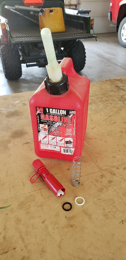

I have a 1 gallon gas can with about a half pint of 50 to 1 mixed 2 cycle gas in it. I found parts of gas can spout on the garage floor this afternoon. The can was on a shelf, about 6' high and the spout pieces were about 10' away on the floor.
Why it blew apart is beyond me. I haven't touched it for over a week and it is in a well insulated garage where the doors are seldom left open.
So much for the new safety-no-spill can. I imagine a replacement will cost about as much as a new can.

I’m not surprised. The ventless cans blow up like a balloon especially if left in the sun. I have to make sure to vent the pressure on mine before tipping it up otherwise it shoots out a geyser of gasoline.

I noticed THAT too.. I have taken it apart & "clipped" the spring about 4 coils & put in a vent, the yellow one like the old cans had..
The shorter spring helps A BUNCH, so u don't hafta put SO MUCH pressure on the noz to keep it open & it still snaps shut..
& the vent is self explanatory..
It works SO WELL that I sometime have to put my thumb over the vent while I'm pouring..!!
Mine also have a little red cap that snaps over the spout to keep small debris from entering thru the spout..
I drilled a small hole thru the lip & tied a piece of very strong fishing line thru it & tied it to the spout.. I'll never lose it, its always attached to the can..

Can in picture in original post probably ejected spring loaded parts because of poor manufacture (defects) not from any pressure build up or explosion...
