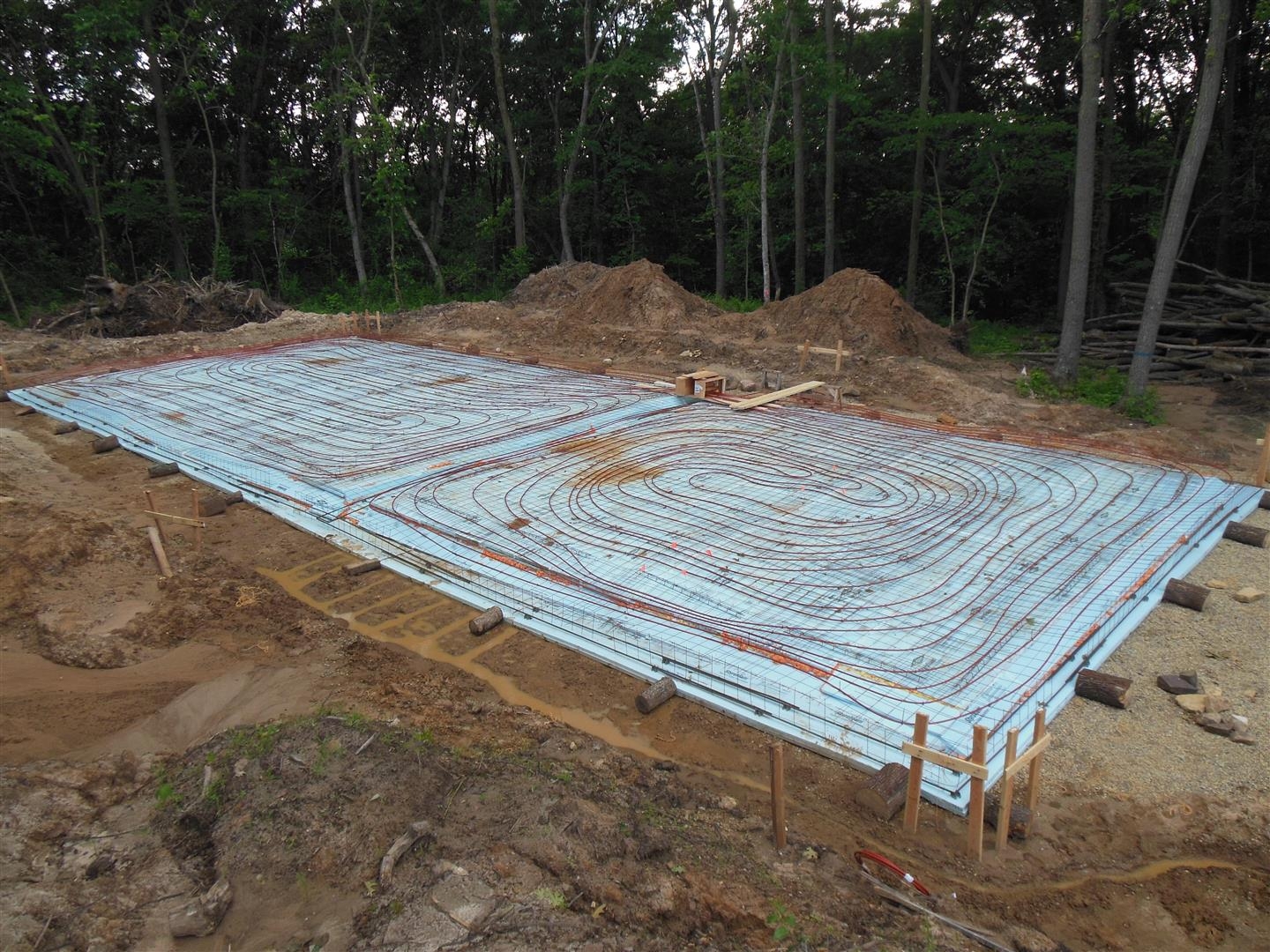

There is alot of science and design in making loops efficient.
Not much different than duct work sizing in a house. Sure....you could throw together duct work and blow the conditioned air through the house.....and it will work. But a proper system is designed for balance and efficiency.
The perimeter of the slab needs the loops closer together than the middle. Otherwise the perimeter of the slab will be colder and the middle will be warmer.
You need to pay attention to which is supply and return. Sending a loop supply down one wall.....return it down the same wall. Not just make a circle around the building. Cause if you do that for a few consecutive loops.....you basically have all your supply (hot) loops all next to each other and all the return (cold) loops next to eachother. MAkes for uneven heating.
And yes....it is a very SLOW temp change with radiant. Dont expect to go out there when its 40 and jack the thermostat and have it 70 by lunch time. Radiant shines for a constant, even, and quiet heat. Which is why I heat my shop with wood. Quick warmup if Im down there, and cost nothing if im not.
Also....the perimeter of the slab needs insulated as well. Many people overlook this and only insulateunder the slab. But most good installs will dig a trench along your band-board/skirt board.....and install a vertical 2" foam board going down into the ground about a foot below slab level. Prevents cold creep from coming in under the slab.
Also gotta watch freeze if you install loops but then choose not to heat a certain area.
Doing radiant heat the right way is definitely not something to just DIY-wing it. You need to know and understand exactly what you are doing because there is no way to correct it in the future
Great tips on setup. And identifies it makes sense to get an expert providing some on-site advice.
Is the vertical 2" foam board just covered with dirt or ...?
Michael
   / In-Floor Heating for a Shop & Greenhouse - Considerations ? #29
The vertical foam board isn't there so much to insulate the slab edge from the band board. It's there to insulate the ground under the slab from cold/frost creeping under the slab, lessening the burden on your below slab insulation.
Some people run the edge foam all the way to top of slab. I personally don't like that...rodents can tunnel through that foam and have easy access to wall cavity.
Leave foam board 1"-2" below top of slap. Let concrete cap it

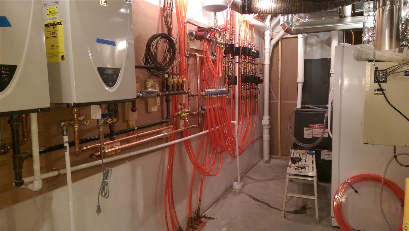

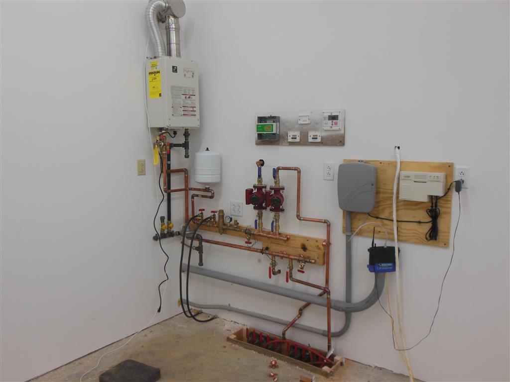

Late to the party. My county building inspector will not allow DHW heaters to be used as floor heat boilers. I also start the flow in the floor in October before the days start getting colder. My pex is filled with RV antifreeze. Jon
   / In-Floor Heating for a Shop & Greenhouse - Considerations ? #34
I could understand if they did not want a SHARED DHW heater being used for the floor along with domestic (potable) HW, but if it is dedicated to the floor then he has no business saying no, frankly. Heat is heat. Or just don't tell him and put it in later...
   / In-Floor Heating for a Shop & Greenhouse - Considerations ? #35
Just so happens the local building inspector is a good friend of mine and has been in my shop numerous times and has seen my dedicated HWH as well as my Calaffi distribution system and has never said boo crap about it. In fact he wanted the particulars as he's building a new pole structure and wanted to see how mine operates. Floor is presently running at 70 degrees, fully heated and the HWH basically idles 75% of the time.
Hard to beat a warm concrete slab IMO.
   / In-Floor Heating for a Shop & Greenhouse - Considerations ? #36
I also use a dedicated HWH - it's a Marathon brand fiberglass/epoxy tank. The tank will probably outlast the house. My inspector was intrigued by that as well as other custom features.
Around here, the basics of any structure has to be approved by an engineer in order to get a building permit. The inspector is basically checking to see that the approved design has been followed, and that subcontractors are following codes. He would need very good reasons to turn something down....
rScotty
   / In-Floor Heating for a Shop & Greenhouse - Considerations ? #37

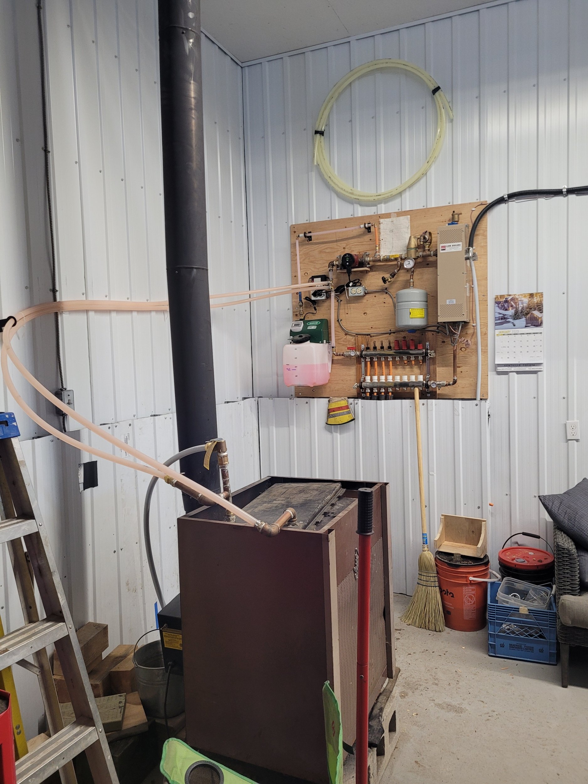

In as much as my machine and fabrication shop is contiguous to the farm and here in Michigan farm structures don't need to be permitted, they only need to be built to existing farm building codes, I never had to apply for a permit, same for my Clearspan Truss arch building I store all my equipment and excess hay bales in.
Additionally, my propane fired HWH is sitting on the slab, not elevated in any way and has been that way for the last 8 years at least and while I don't run gas powered equipment in the shop I do use flammable compounds in it all the time and never had issue one. There are 3 motorcycles with full fuel tanks sitting adjacent to the HWH as well.
I don't ascribe to paranoia and never have. I do practice due diligence however. The shop is equipped with large sized American Lafrance ABC fire extinguishers that I have recertified every year. One in the front bay and 2 in the back bay.
Nice thing about running Cryotek in the system is, the HWH tank will never suffer the effects of internal corrosion so barring maybe a faulty thermocouple, it will far outlast me and the entire system is 100% full at all times and any entrapped air produced by the heating of the Cryotek is automatically expelled by any of the three in system trapped air removers. One in the main (from the HWH) feed line and one each on the hot side and cold (return side) of the system. I keep the static pressure in the system at 15 pounds on the supply side and 5 pounds on the return (cold) side and I monitor the system pressure with a pair of analog combination Watts temperature and pressure gages so I know exactly what the output pressure and fluid temperature is at all times as well as the return temperature and pressure is, not that I look at them much because the system maintains itself now and when I put it together I added a tempering valve setup off the HWH so I can intermix the feed (hot fluid) with the cold fluid. I have it set and have not fiddled with it in years now.
It's 100% turn key and it stays energized constantly through every season. I let it decide (via the in the slab remote sensing thermostat) when it needs to heat or not heat the slab.
   / In-Floor Heating for a Shop & Greenhouse - Considerations ? #38
That's about how I built mine to be controlled. So that I could leave the house and shop for a 6 month vacation somewhere warm and this place would stay at good temps.
My hookup for a propane-fired backup is outside in an attached room.
