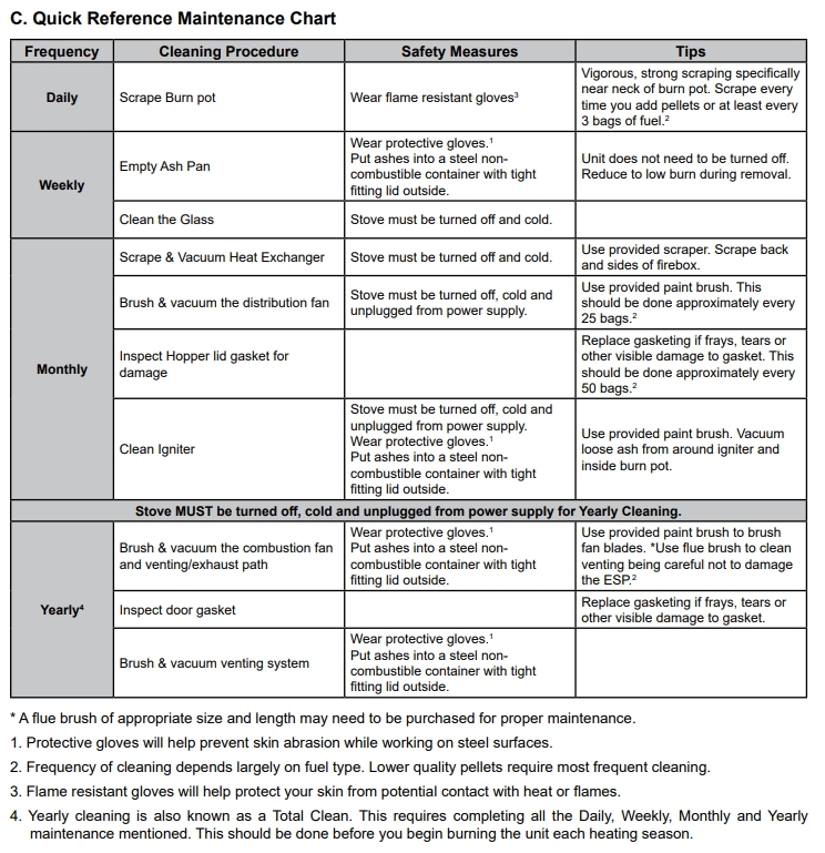

Here's the maintenance required for my Harman stove. I believe most of the brands have similar requirements.
Wood stove requires a lot less maintenance!
