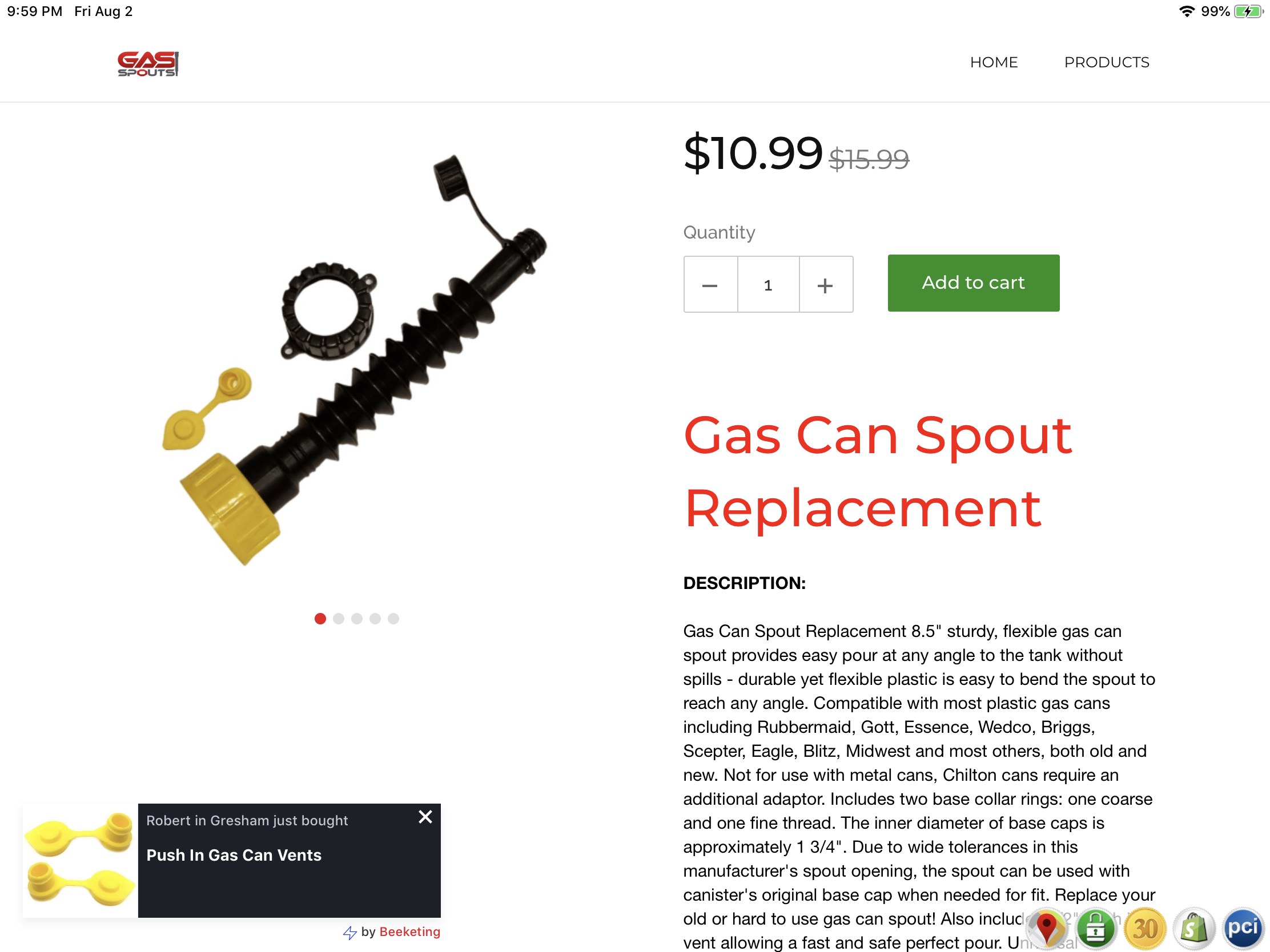

This is what I put on my newer plastic 1, 2, 5 and 6 gallon gas cans, just don’t drill the hole for the vent cap to big.

I use the same. Have the small diameter spouts for gas, and the large diameter spout versions for diesel. No mess, no fuss, no problems.

Yea it take a 1/2" hole for the vent. I have those on nearly all mine. I will use factory part till the gasket goes then I replace the whole spout. Of course here in CA we have to buy "white" ones meant for water, because that does not comply with CARB.

The local hardware store had only the dual spout ones in stock for awhile for 14.00 and now they also carries the single spout package for 11.00 due to people requesting the single because not everyone needs the bigger spout, the single small spout also works real nice with the ford white gas tank funnel that come with newer ford vehicles that don’t use a gas cap.

Those replacement spouts fit every size gas cans imagionable but the ones (plural) that I have.....So tired of stores full of crap that don't fit or work properly....
Just punch holes in old can out of despiration so I don't try to reuse, and then just buy new can with poor design filler to add to my frustration....

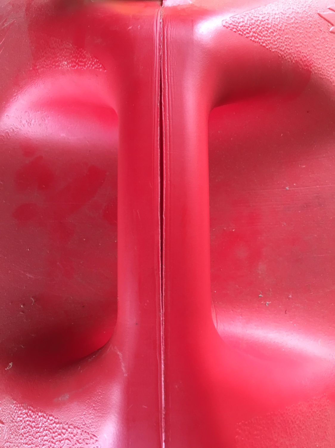

Yesterday I had an “American Can” 5 gallon gas container split at the top handle mold line. Date of manufacture is 19 August 2015. You may want to check ur containers if you own some of these.
/ No Spill Can Go Boom #33
Some of mine have split too. I will be going steel cans and take my chances with rust.
