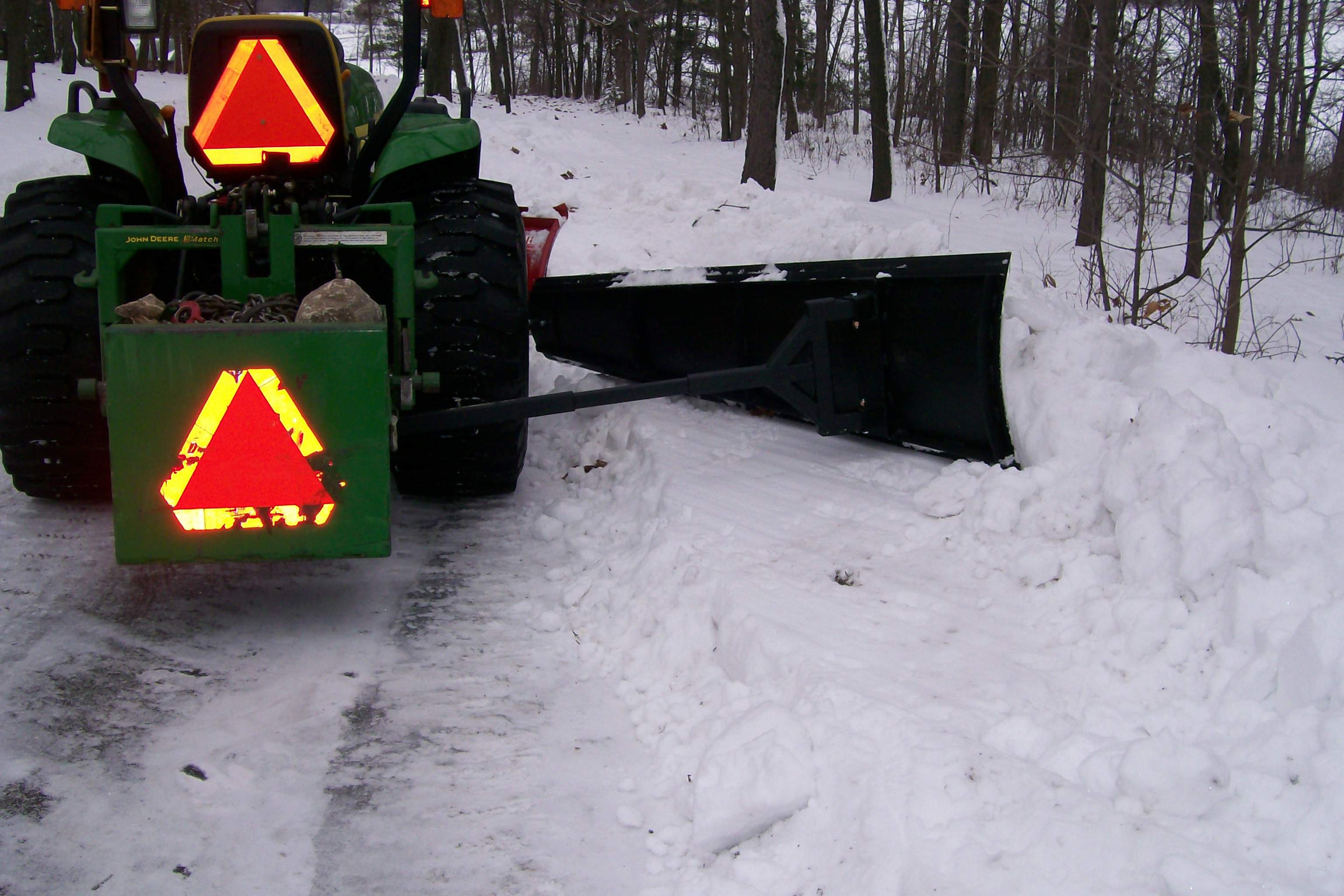

Thought I was the only one to use the BB for a grader blade, works very well with packed snow on a blacktop driveway, also.
Stone for BB fill is the only way to go and like you I fill in the summer to about 4 - 5 inches from the top, chains, and one of those small 2 ft shovels. I take about half the stone out for winter and plowing snow.
