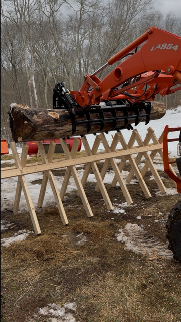

I already own the grapple. I intentionally got the smaller EA 55" wicked grapple (239lbs!). My tractor could easily handle the 60" grapple (400lbs), but I didn't want the weight or larger size.
I've seen the videos of the smaller 55" grapple on a L6060 taking abuse that is nothing near what I will do to mine. Plus EA's customer service was great. I'm very happy with my choice. Wish I had a better photo. Not that its a particularly amazing feat, but it got a hold of that particular 500lb log with ease.

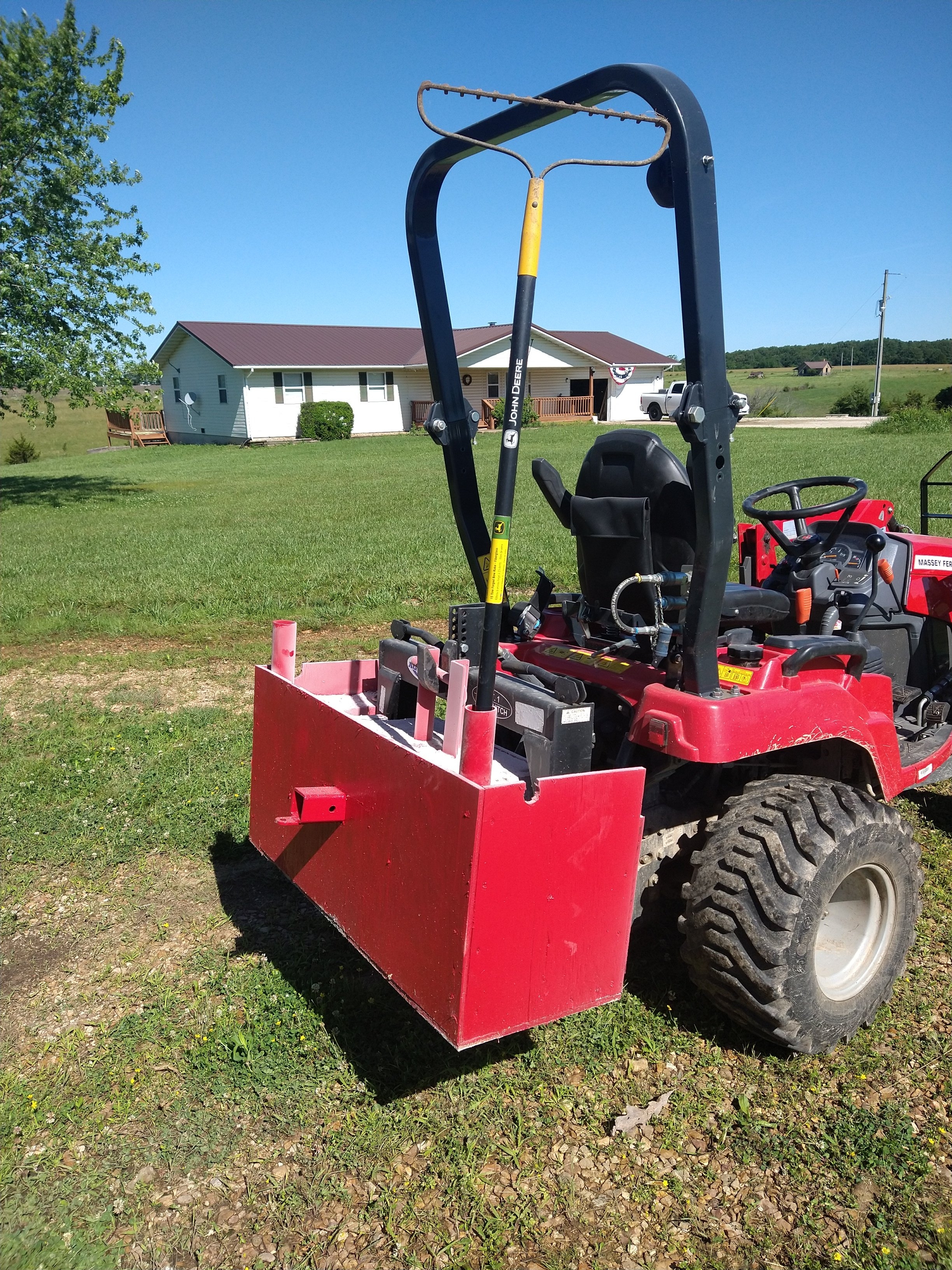

That 5085e i was moving downed maple with , bare tractor and loader 9500lbs + loaded tires ~1400 + four wheel weights ~400 , so ballpark 11300lbs , then add about 1700 counter weight for about 13000 total. It’s very well planted and stable. Loader and bucket is about 2300 of total, 85 engine hp. Lift capacity at pins to full height about 3600lbs . At lower lift heights quite a bit more.
The little 5055e is bare tractor and loader about 7500 , 2000lbs is loader and bucket. Add the counterweight for about 9200lbs total. If I eventually load the rear tires be little over 10000. Heavy for a lil 55hp tractor. Lift capacity at pins full height around 3500lbs .

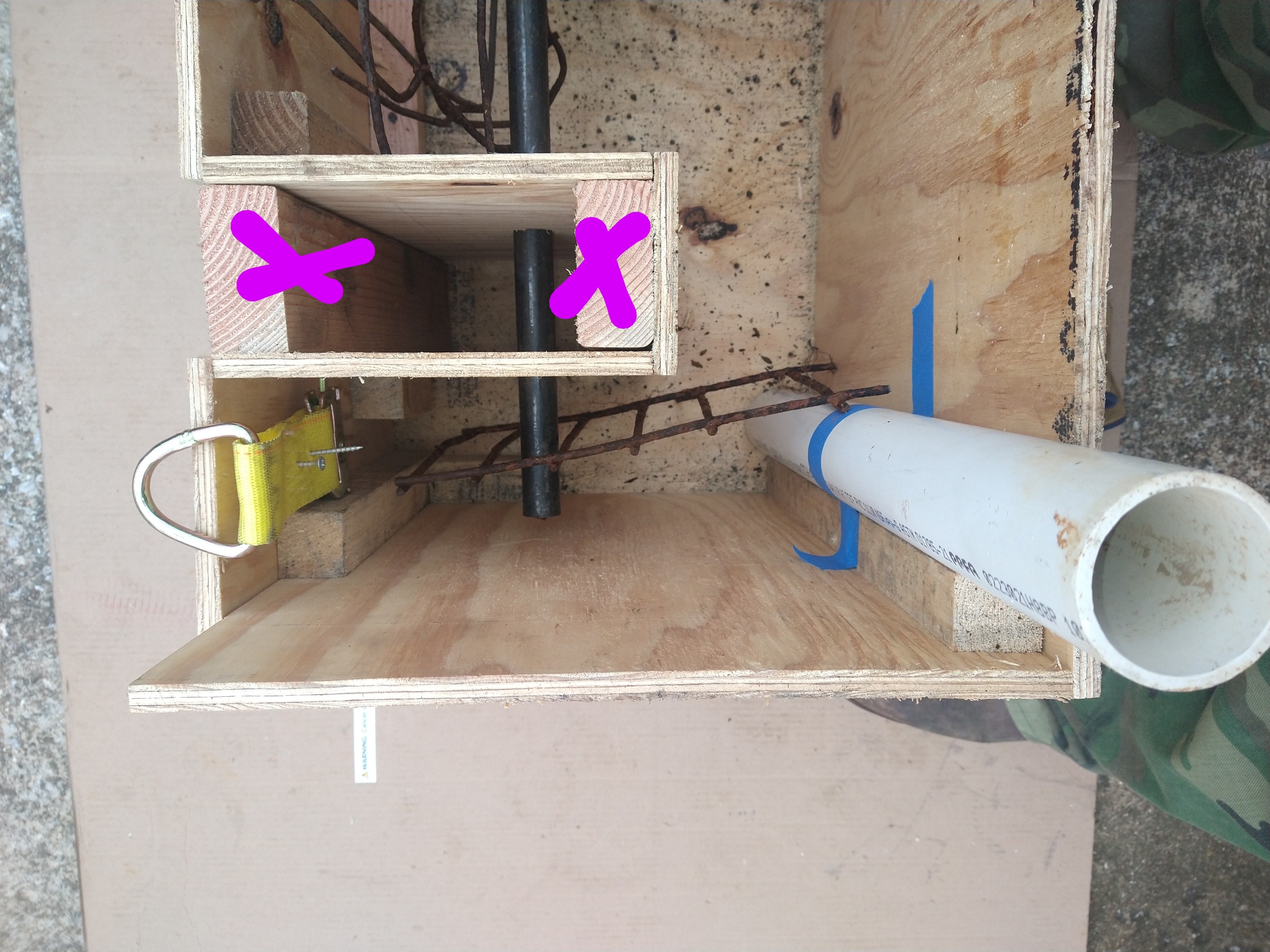

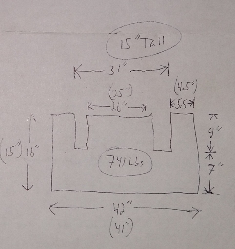

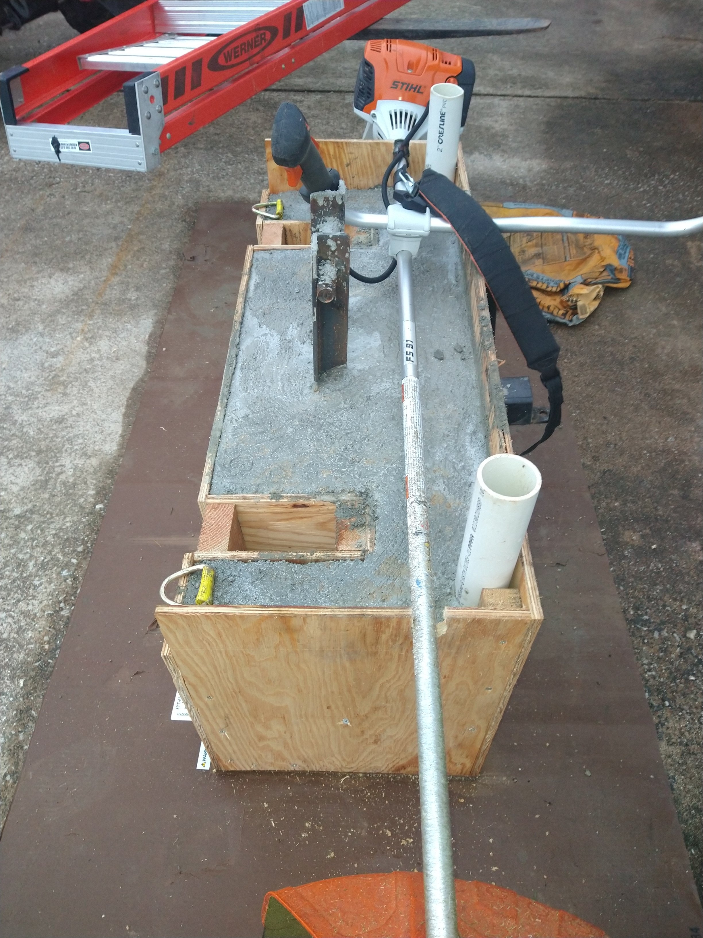

I built my own, my quick attach fits into the recessed area to grab the lower pins, this keeps the weight close to the rear axle, and doesn't have the long tail like the bottom of my backhoe does which can bottom out or drag in steep uneven terrain ... Once the concrete was set/dry, I knocked out the 2X's at the purple X's
This was my rough drawing ... And guestimate, actually came out at 707 Lbs.

Interesting recessing the 3ph pins. Of course, the same weight 2x the distance from the rear axle has twice the counterbalancing effect.
It would be interesting to design a similar setup which allowed a flexible attachment, closer in for less weight on front giving more maneuverability, farther back when you have a bigger load.
