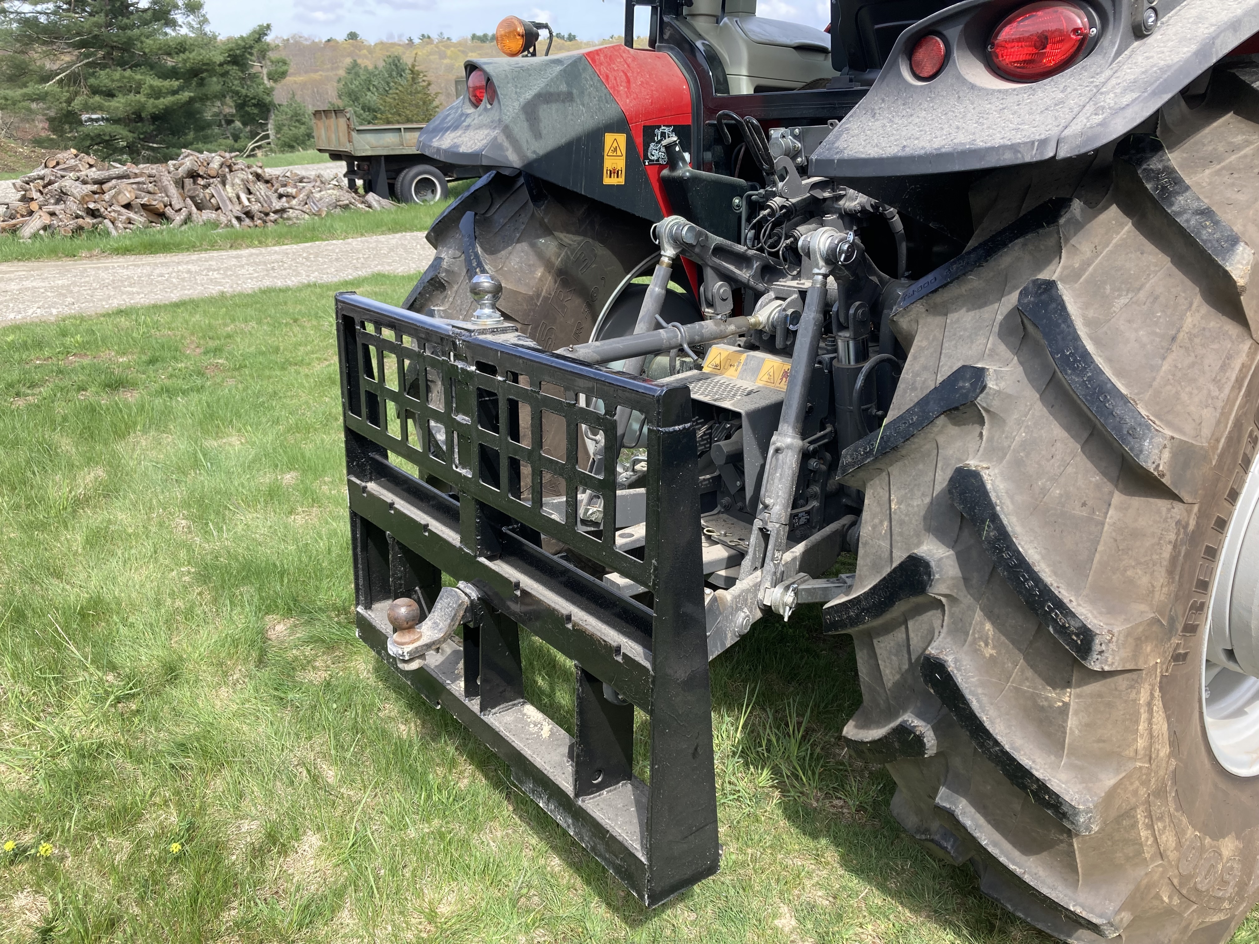

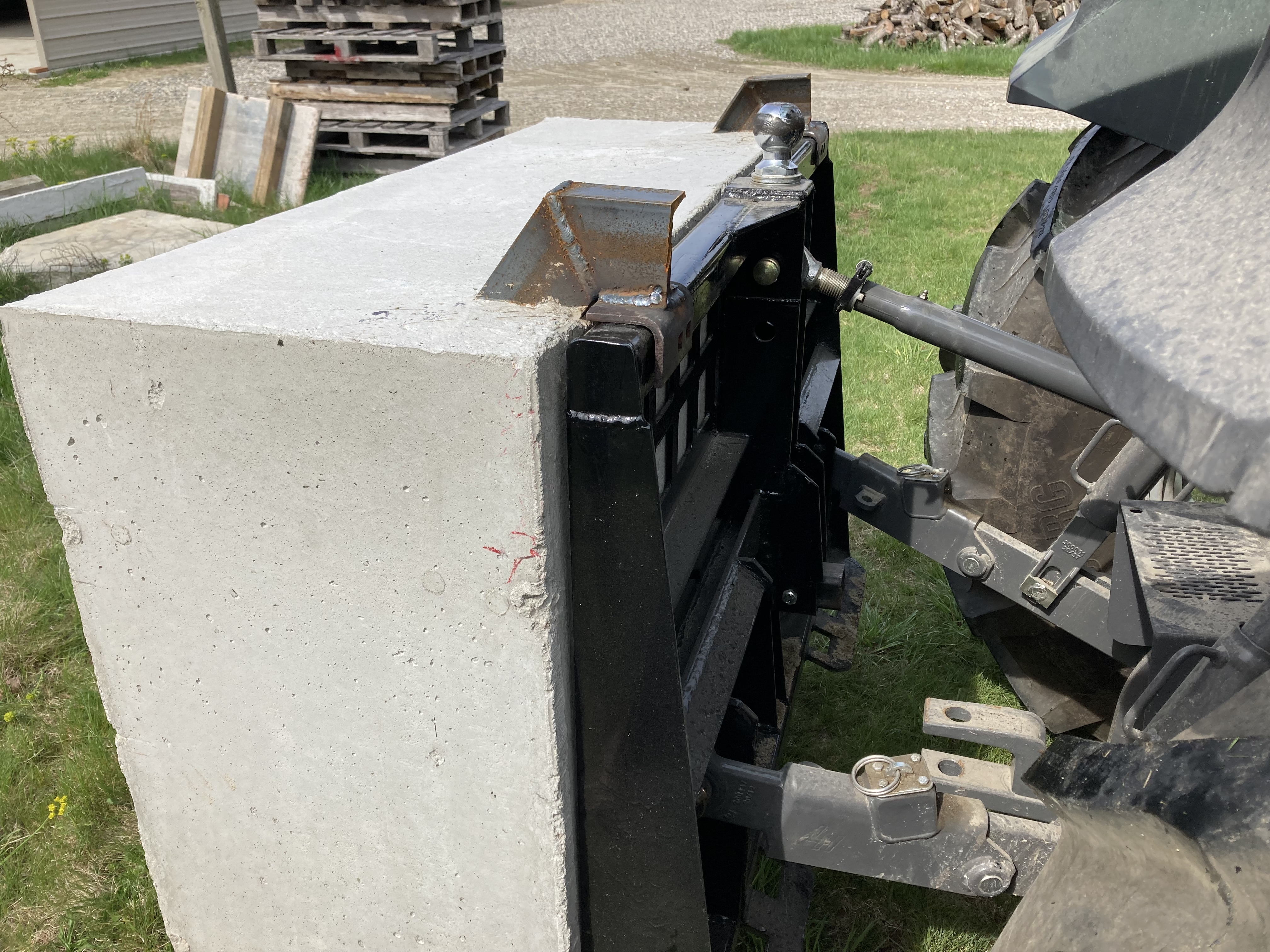

New member here, I've read many of the threads discussing 3-point ballast and believe I have a good idea of how much it should weigh, but I'd like recommendations. I'm planning to build my own box using a plywood form. Ideally I would be able to add or remove weight depending on the weight in the FEL, but that isn't in the cards right now.
I made my own concrete counterweight that is as easy as backing up to it, lifting, and driving away. The weight is fixed (2,600lbs), but it's fast and easy to use and then drop back off again when not needed. All I had to do is modify a SSQA pallet fork structure to fit on my 3pt. hitch.
It's a great system.
The tractor is a L5240 HSTC with 854 loader, R4 tires loaded with Rimguard. I'll be using the factory bucket or EA Wicked grapple. The LA854 loader weighs 1,300lbs, the bucket weighs 300lbs. Estimated total weight of everything is around 7k lbs. My primary "concern" is moving logs over fairly hilly terrain.
My plan to construct a very low and wide ballast box, and I'd like to keep the weigh fairly close-in to the rear axle to reduce the chance of swinging weight. I'm shooting for around 1,300 lbs. Thoughts?

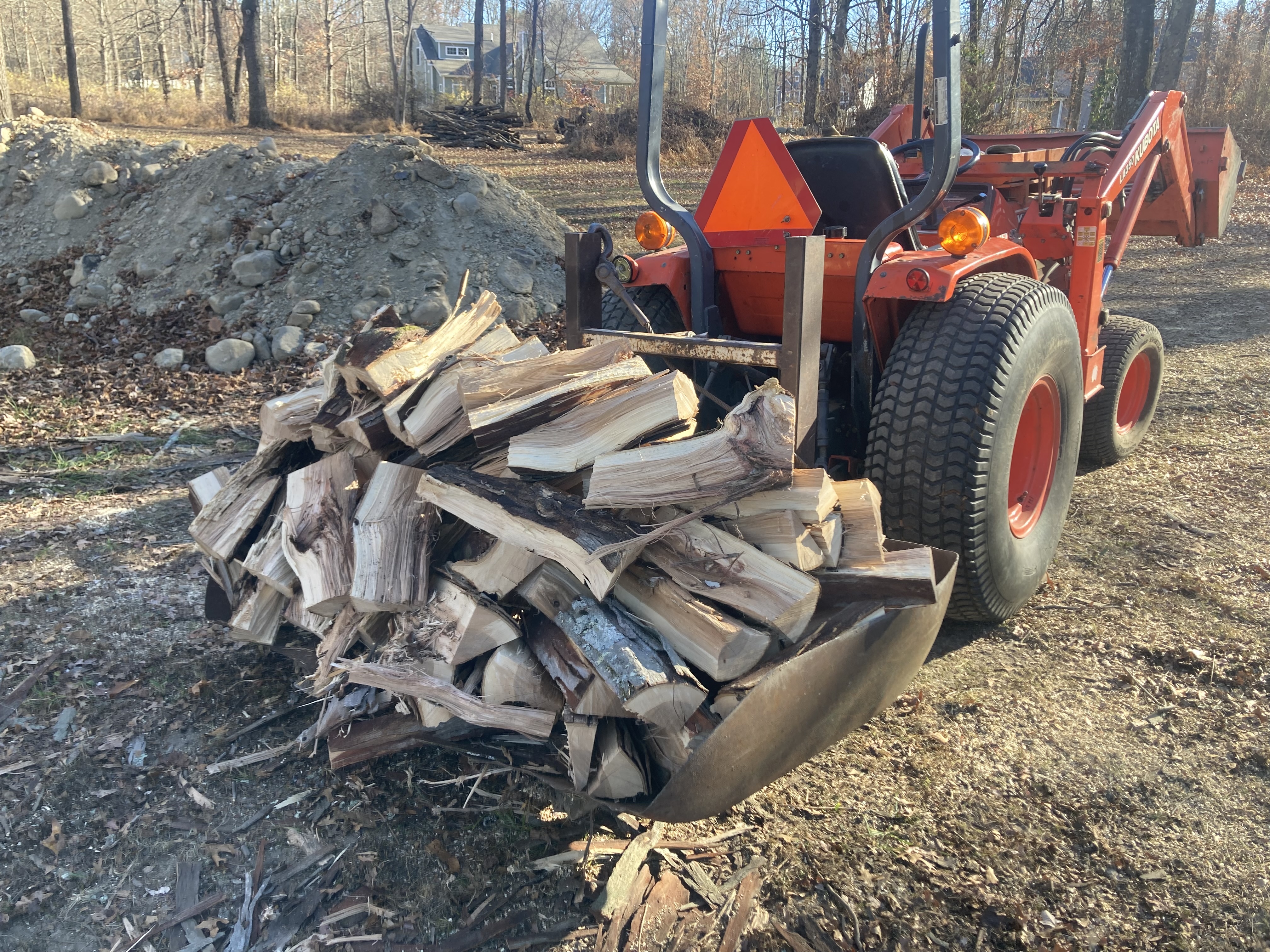

I have a smaller tractor than you (B2150) so I don’t know about carrying MASSIVE amounts of weight but on my small tractor I welded up a forklift attachment and I will either pick up a “pan“ of rocks or load logs on the back so I can carry two loads at once. In your case, I don’t know if that would be dangerous, but for me it has worked wonderfully. I can carry two loads of dirt at once and cut in half the time it takes to move a pile of dirt. This is not a great photo but it’s the only one I could find quickly. I cut a 275 gallon fuel oil tank and half and I use it as the “pan“ that I could drop down and pick up, I also stumbled across the way to dump it and pick the pan back up with the forks without having to get off the tractor. It makes dumping a lot easier and faster.
I would think if you chained some logs to a forklift attachment, they wouldn’t slide off.
I pick up a load of dirt or rocks with the bucket, dumped them in pan, turn around and fill the bucket with dirt or rocks and then go. From my point of view I can’t understand how anybody would ever want a ballast box.

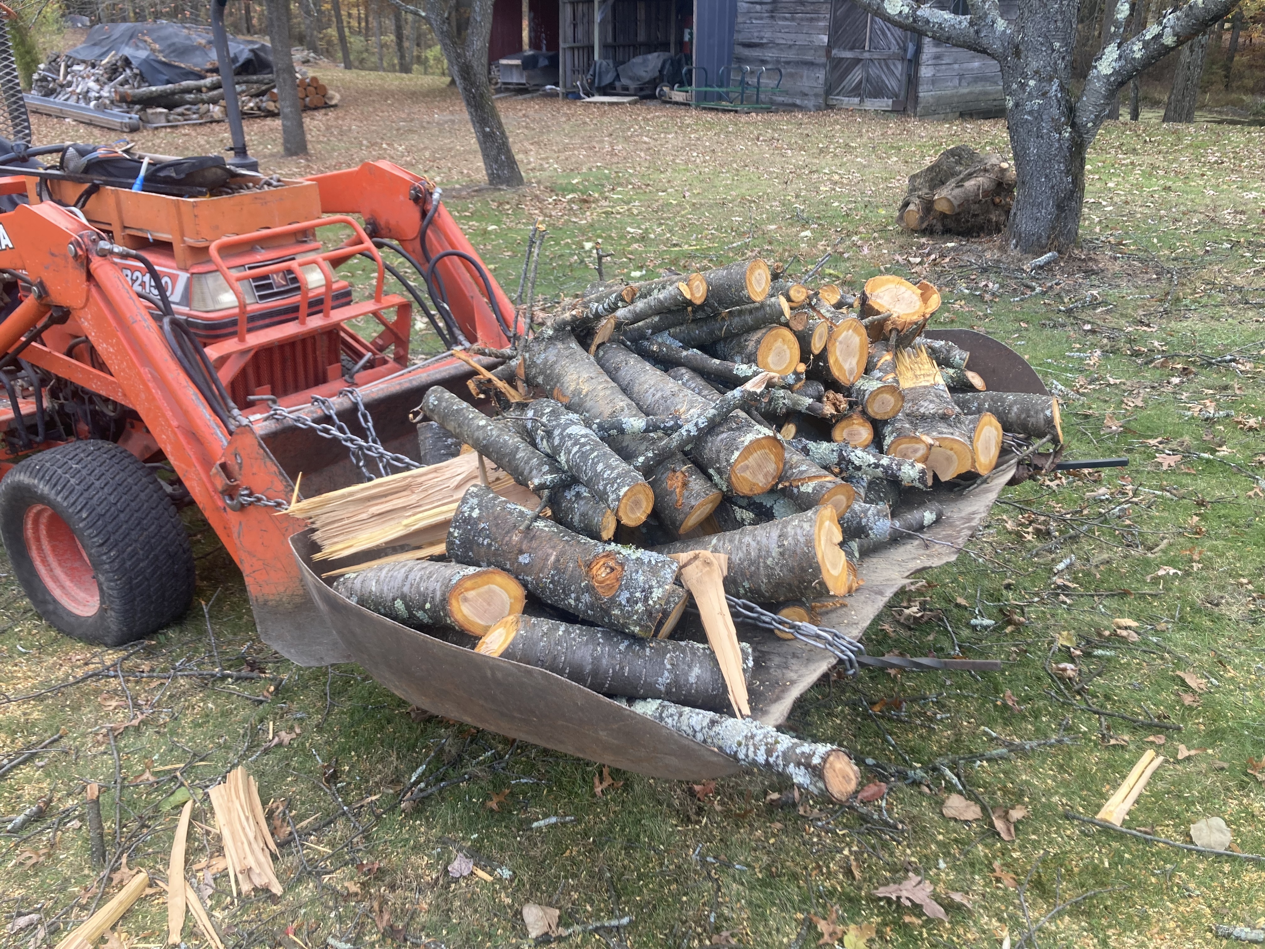

better photos of the pan. I also stumbled upon a way to adapt the pan so that I could lift the firewood up high and dump it onto the top of the pile. I stumbled across a technique to dump a pan of firewood or rocks/dirt “higher“ but not as high as with the loader bucket/pan adaptation.
I have hauled TONS of stuff with that forklift and pan. It doubles my capacity and halves the time it takes to move materials.

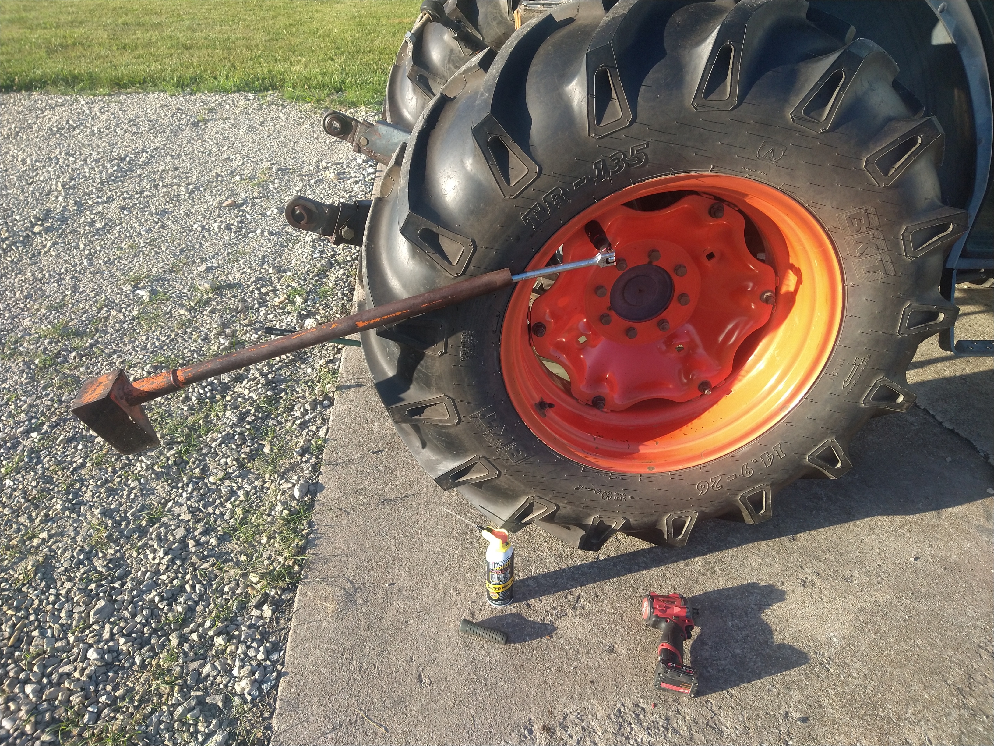

On my L5030 switching sides wouldn't make any difference, had to remove the center disc and repositioned it ... Notice in the narrow configuration that the nuts from the center disc to the wheel are showing ...
Say Shawn T. W. ... I'm glad to see someone else is making good use of their 17 lb Monster Maul. Mine was delivered to a nearby house over 40 years ago and the neighbor lady came dragging it across the street to our house, saying my wife was trying to kill me having me swing such a thing...
