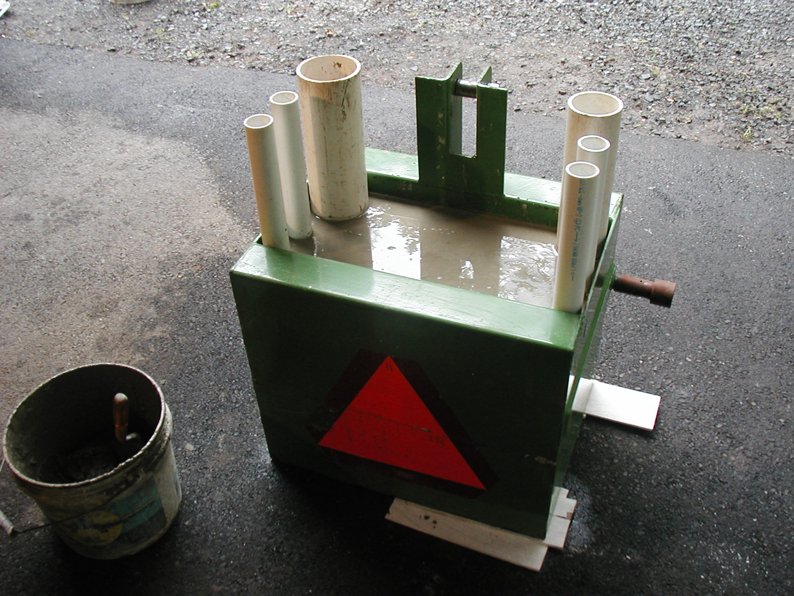

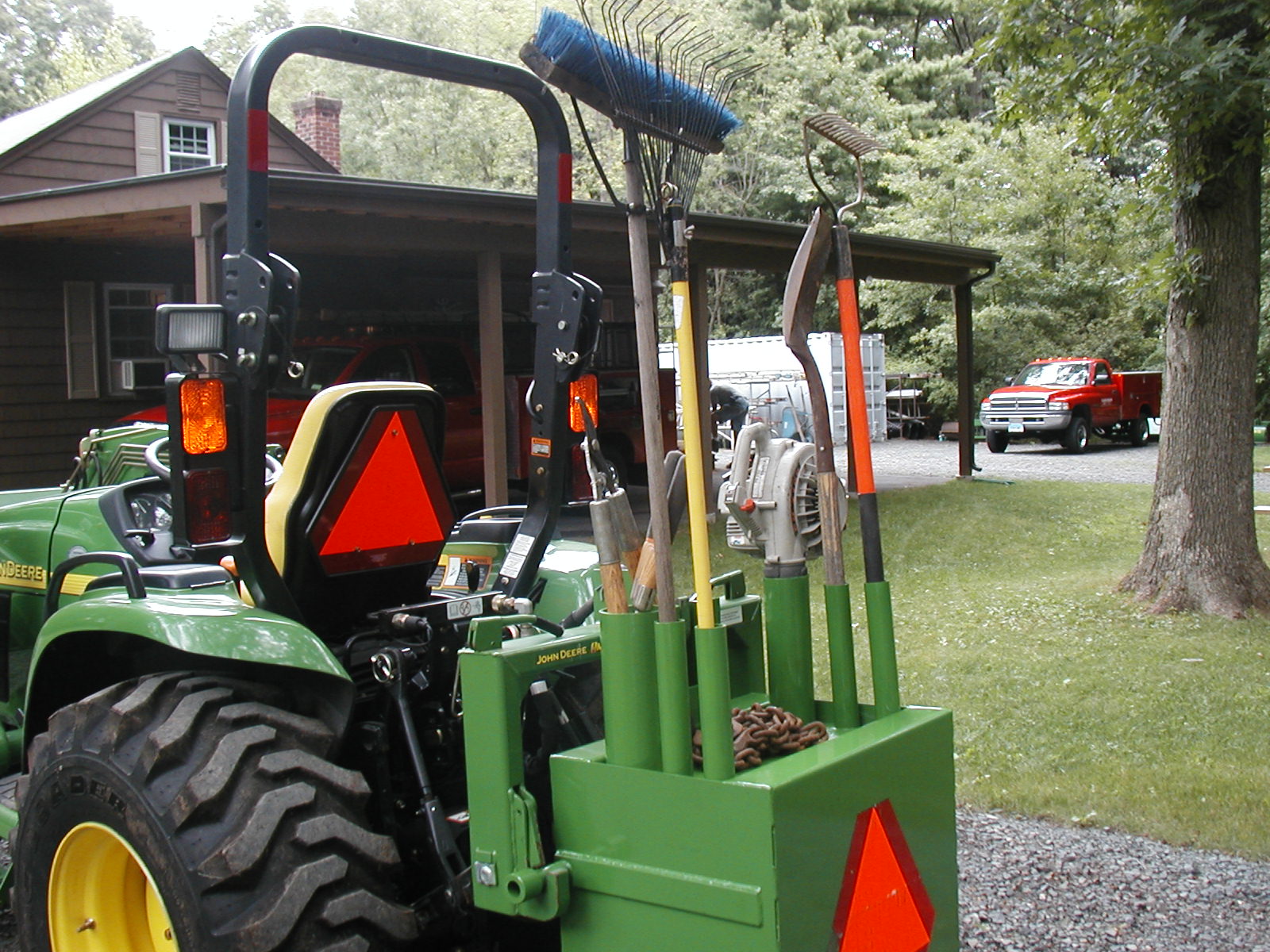

For the first year I used 3/4 inch stone, in case I needed the box for anything else, well the only thing I needed the box for was more ballast. So I filled it with concrete to about 2 inches from the top to hold a few loose items, put pvc pipe in to hold tools.
Definitely no regrets. Sand, stone, bricks etc are not nearly as heavy as concrete. you'd have to use steel or lead to to have a removable medium and still be heavy enough. That would get expensive if you had to buy, for 25 bucks you can fill it with concrete.
Well maybe 1 regret, I should of used steel pipe, if I break a plastic pipe I'm stuck.

I do regret not putting PVC pipes in it to store tools like many folks on this site have. :)

I used a dimpled drain board material on the bottom and drilled drain a hole through the bottom. anything that would leave some air gap and path for water to drain at the bottom, even crushed stone like at the bottom of a flower pot.
For the top I drilled a hole in the side of one of the pipes.
Some guys put a receiver tube in, For myself I didn't think I would use it, figured if I'm pulling a trailer I wouldn't need or want the heavy box on. But I guess in some cases it would come in handy with all the different accessories that go in the receivers now.
