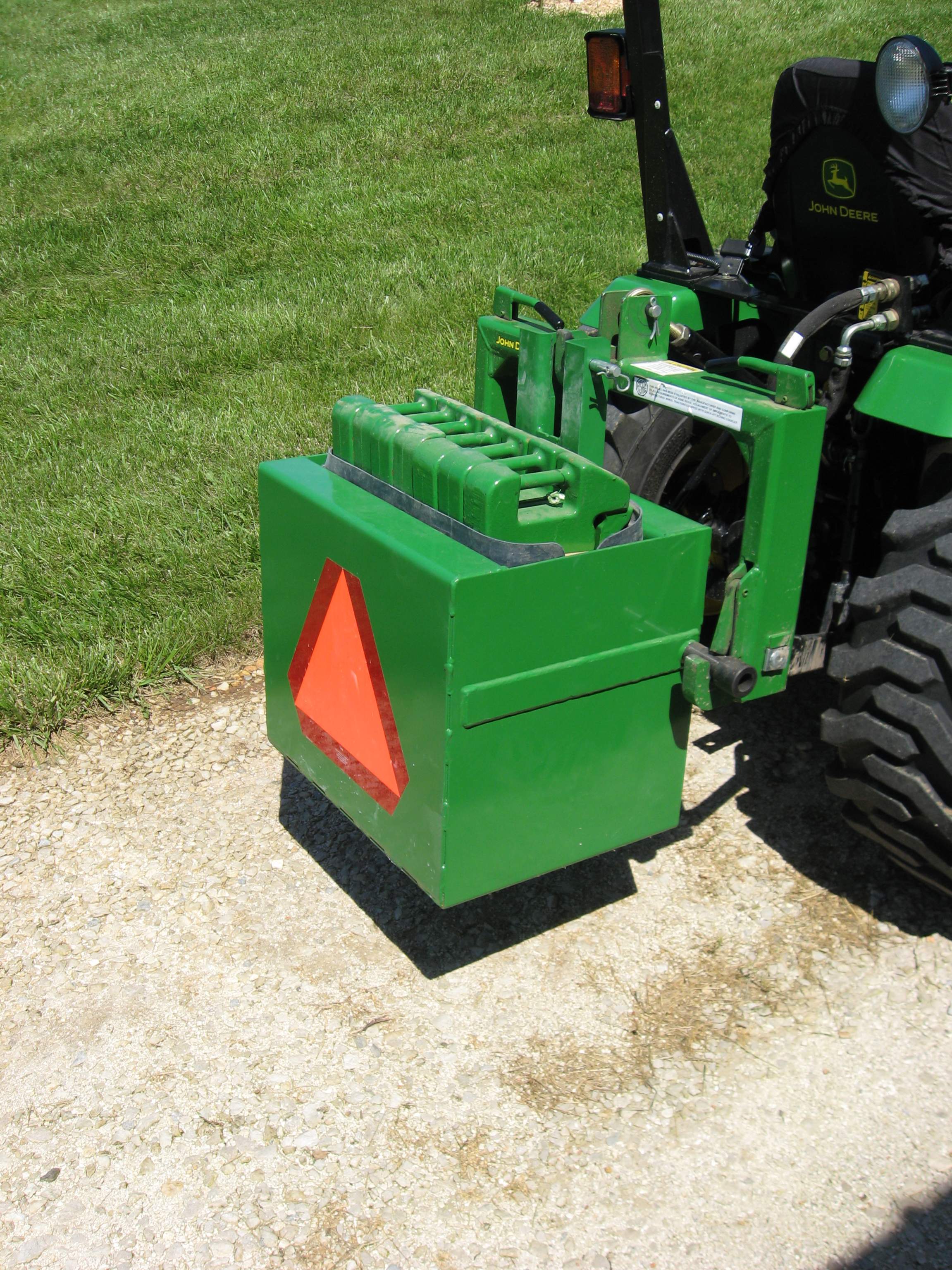

/ Question on ballast box #28
I also use the ballast box as it is narrow and keeps out of the way of the wing plow when it is mounted.

I think of it this way, Snow Plow Blade/Ballast Box = One Implement or FEL/Ballast Box = One Implement, or Front Fork/Ballast Box = One Implement

Just out of curiosity, guys, why do you all use ballast boxes instead of just a heavy attachment, like a box blade, that has an additional use?
On my little 'ole 790, anyway, I've found that my FEL can't lift more weight than my BB can offset. And that's with the extra shims in.
Simply don't need a BB? Worried about size? Cost? Bigger tractor than a 790?
Just curious....
No way do I want a bulky attachment following me around when I am doing loader work.
The BB hangs close to my rear tires, is very compact and it is really a no brainer....it's the ideal tool designed to improve the overall performance of a tractor when when moving heavy loads.
And, they around $200. Don't think you can get a 600lb. attachment for as little money.
