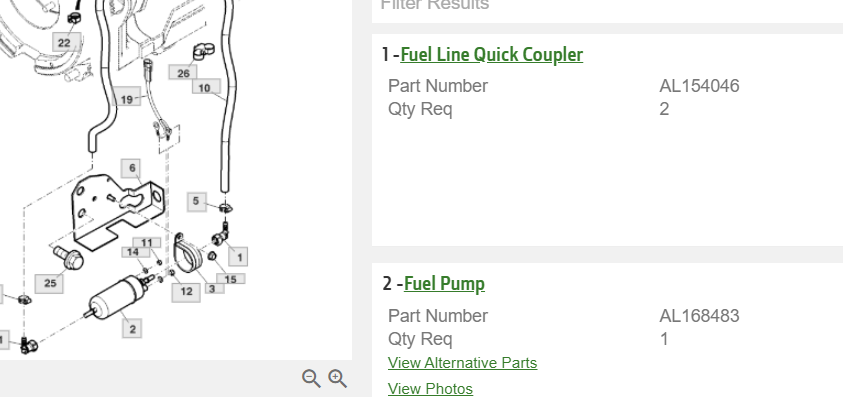

I have a 2012 Deere 5065E that is dying on me after running it for a couple of hours. I normally don't run it that long as it's my hay bale tractor that I also keep the post hole digger on for fencing. Last weekend and the weekend before, I was using it to clean up some fencing that my neighbor took down, and the temps where close to 100 degrees. Engine temp was good. I was mostly just driving back and forth across my land to get a roll of wire, or some fence posts and bring them back to my house. Then it just died. Sounded and felt like it ran out of gas.
First time I added five gallons of diesel and pumped the manual fuel pump on top of the fuel filter. It fired up after a few tries and ran great. Yesterday, with the fuel tank still being full, it did it again. Just lost power and died. I pumped the primer on top of the fuel filter and got it to start, but it died on the way back. I did it again and made it back to the house where it's parked.
The fuel filter is a few years old, but doesn't have 100 hours on it. I ordered a new one that should be here tomorrow from Amazon. If that doesn't work, my next guess is the fuel pump. On my other tractors, it's on the side of the block and an easy thing to replace. For the life of me, I can't find it on this engine.
The engine is a 3029TPY22
I'm also looking for an inline filter somewhere but haven't found one yet. On my other tractors, they have them before the fuel pump, and another at the bottom of the sediment bowl. I don't see a sediment bowl on this tractor either.
The fuel tank is plastic, so I doubt rust in the fuel lines is the issue, but I'm going to blow out the lines anyway just to make sure.
What else should I be looking at?
Where is the fuel pump?
Is there an online source for parts that I haven't found yet?
Thank you

There is no fuel pump. Only the primer pump, which CAN be a problem sometimes. It's the first place fuel goes after leaving the tank. I have found all sorts of stuff in them that can impede fuel flow. Try that first. Just unscrew the pump assembly, lift it off and look inside. you might be surprised at what you find.
/ 2012 5065E fuel pump question
Thank you. Seems like Deere has a different way of doing things then I'm used to.

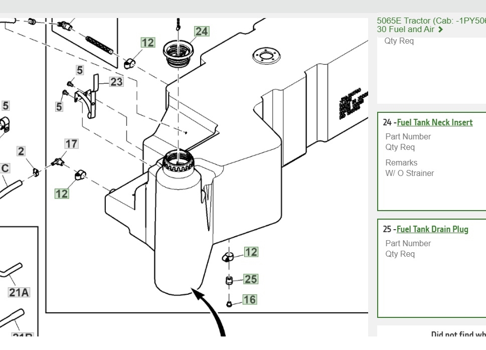

If it happens again you'll have to dig a little deeper. If there's crap in the tank and lines you get to deal with it. Did you open the water drain on the back of the tank to see what shows up down there? What was under the diaphragm? That's where most of the stuff collects.
I didn't take a picture, but the fuel looked clean under the diaphram. I drained it and rubbed it clean with a paper towel. It turned dark brown where I rubbed the metal clean.
I didn't know about the tank having a drain. I'll look for it and see what happens.

I’ve not had the issue with my Deere’s but I believe theirs a fine screen/ filter in your tank that your fuel supply line hooks to. I don’t think it’s to much of a job to extract it from the outside and clean or replace it.
#12
Thanks. I'll look for it.
It seems odd to me that there isn't another filter or screen of some kind before or after the main fuel filter.

Some have that strainer and some do not. Here is schematic of one that does not.

On the earlier tractors for sure there is a strainer in the tank outlet. Some are part of the fitting, some are totally separate depending on age, serial numbers ETC. Its not hard to remove, just a "drain the tank" project.
That looks like it. I haven't messed with it yet; I just looked for it last night when I got home and saw it. I'm not sure how it works, it's very odd looking.

It's taken me longer then I expected to do this because it would run fine for just putting a round bale out, but I just got a load of hay and I wasn't able to move it all without the tractor dying on me. It felt like it ran out of fuel, and then I would have to pump the primer after letting it rest before it would start again.
I did a YouTube search for the screen in the fuel tank and was able to see what the issue was. I removed the screen in my fuel tank and it was totally blocked by scum. I cleaned it off and put it back in, and the tractor runs great!!!!!
When it happens again, I think I'm going to through the screen away and install an inline fuel filter with a valve that is easier to remove without draining all the fuel in the tank. That was a mess!!!!
