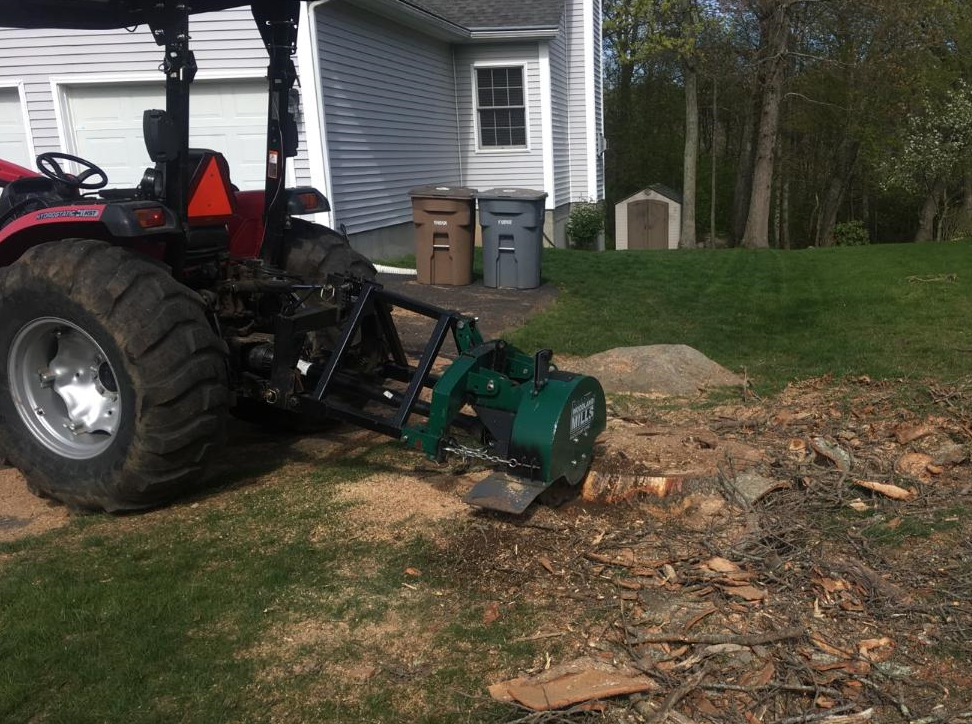

I have a Woodland Mills grinder, and here is my experience.
The grinder itself is rugged, the design is simple, and it is relatively cheap to purchase.
I found that it did not work well for me out of the box. As you use a grinder, especially in my area of the northeast, you are inevitably going to hit rocks. Small rocks and dirt take the edge off the carbide teeth, which from what I have seen is pretty standard for a stump grinder. They don't stay razor sharp like a chainsaw. As the teeth would dull, it would take more pressure to bite into the wood. Makes sense to me, based on how dull saw blades work. The trouble with the woodland setup out of the box, is that the grinder tilts around pivot pins, intentionally. For me, that tilting would not allow the grinder to effectively cut in to the wood. It was very slow, and the chips would be no bigger than chainsaw size chips, unless the teeth were brand new.
Additionally, when the grinder would tilt, it would put the lower U-joint of the pto shaft at an extreme angle. I destroyed a couple PTO shafts in a short time when the grinder was new.
My solution was this: I fabricated an A-frame to move the grinder further back from the machine. I bought a longer, heavier duty PTO shaft. Combined with a hydraulic top link, I now have a good amount of travel, and the u-joints are never placed at an extreme angle. I also added chains to prevent the grinder from tilting. I used 1/4" chain that is tight (my shear pin of sorts), with 3/8" safety chain in case the 1/4" snaps.
I have added hard facing around the edge, as the rocks in my area had worn away a decent amount of metal from the original wheel. Even after my mods, the bearings are in great shape, I disassembled the unit about a year ago, as I was concerned that my locking it in place would overstress something else. So far, I have not found that to be the case. That said, the grinder is one of the rougher things on the tractor, though some of that is how you operate it.
With my mods, the grinder makes big chips now. I've done probably about 100+ stumps with it, some as large as 6 foot. I did a 5-6 foot norway spruce about a month ago, down 6" below the ground in about 2.5 hours including picking up the chips.
As far as transmission choice, I would prefer hydro for operating this grinder, though I don't think it would be impossible at all with gear. With hydro, I am ready to let off the pedal if something bites hard. With gear, you would just need to be ready to hit the clutch (assuming dual stage live pto etc). On hills that could be a little trickier.

Thank you for this. This is what I am looking for, real world, personal experience. I'm still shopping, and I may just go with a dedicated grinder instead of a tractor mounted one. Lot's of work to be had here, and I am just looking for something to do now that I am retired. I will most likely rent one and get some time on it, then make my decision. I truly appreciate your post.. thank you for taking the time to really answer my question.
For what it's worth, I have a buddy that cuts trees professionally that has a vermeer self driven grinder. It uses a 20ish HP gas motor. I've used those before, and they are fine for what they are. They will get the job done, but it doesn't come close to what my grinder will do now. And the purchase price is much more than I paid for the attachment (plus mods).
That same buddy has basically given up on using his smaller one, and hires out now. The guy that he uses has a much larger, diesel grinder with something like 80 HP I think. I have not seen that one run, but from what my buddy says watching them both, that grinder is almost as fast as mine. For my purposes and area, I also love having the tractor with grapple there. I can often pop out medium size rocks around the stumps, and I can use the machine to help rough grade and move the chips.
I think if I was doing this day in and day out, my tractor would probably break something before a large dedicated grinder will, but knock on wood, it's been fine so far even with my mods.
Not totally sure your situation, and whether hiring or renting a dedicated unit would be an option. For me, I cut trees as a side business, and I use the tractor for a lot of different tasks. I could not justify the purchase of a dedicated stump grinder, but an attachment made sense. The grinder has chewed through a lot of wood, and made me a fair amount of money so far. It is also very nice to have for around my own property, in the event I have a little job to do, it's quick to pop on and take care of.
