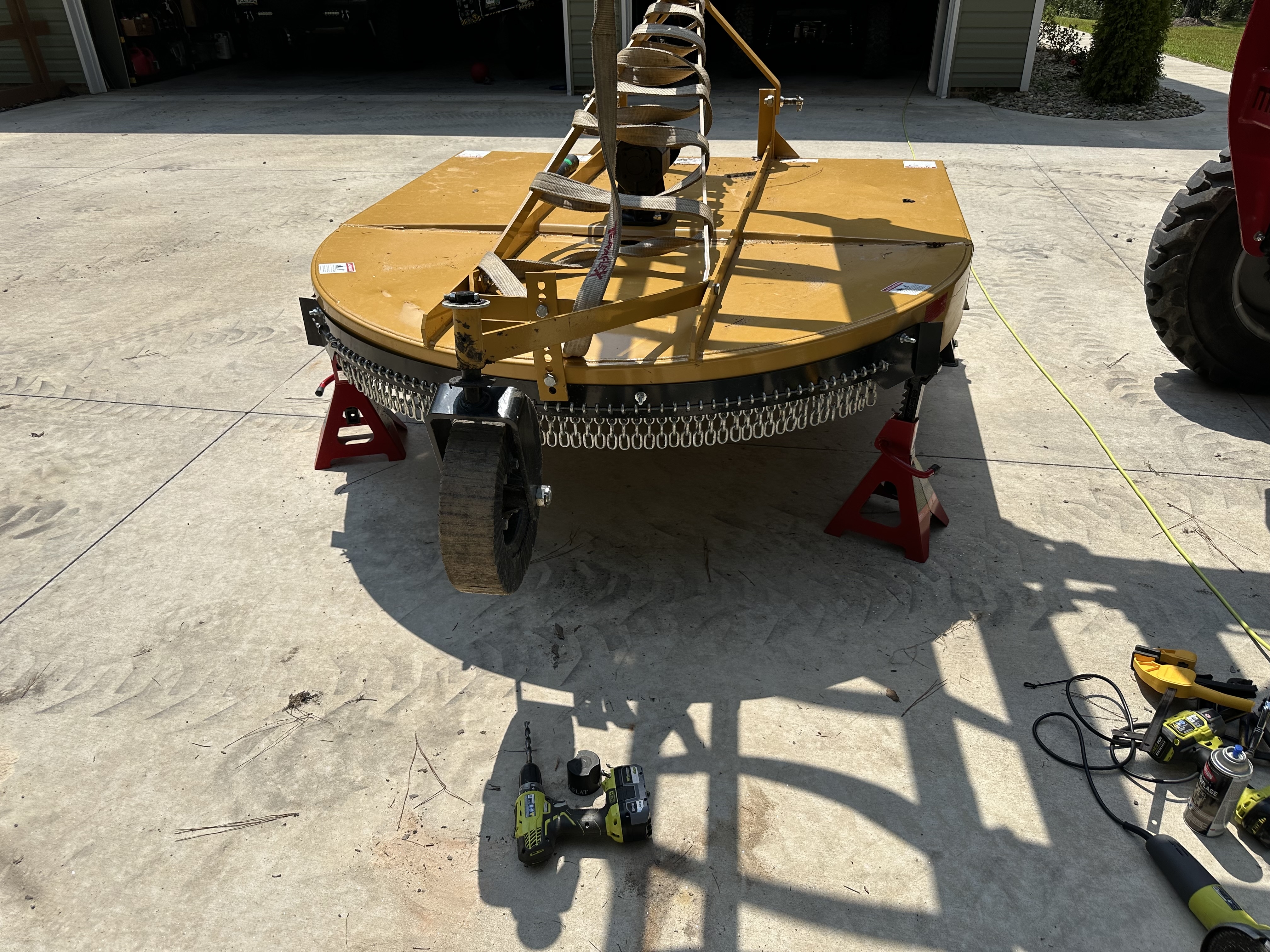

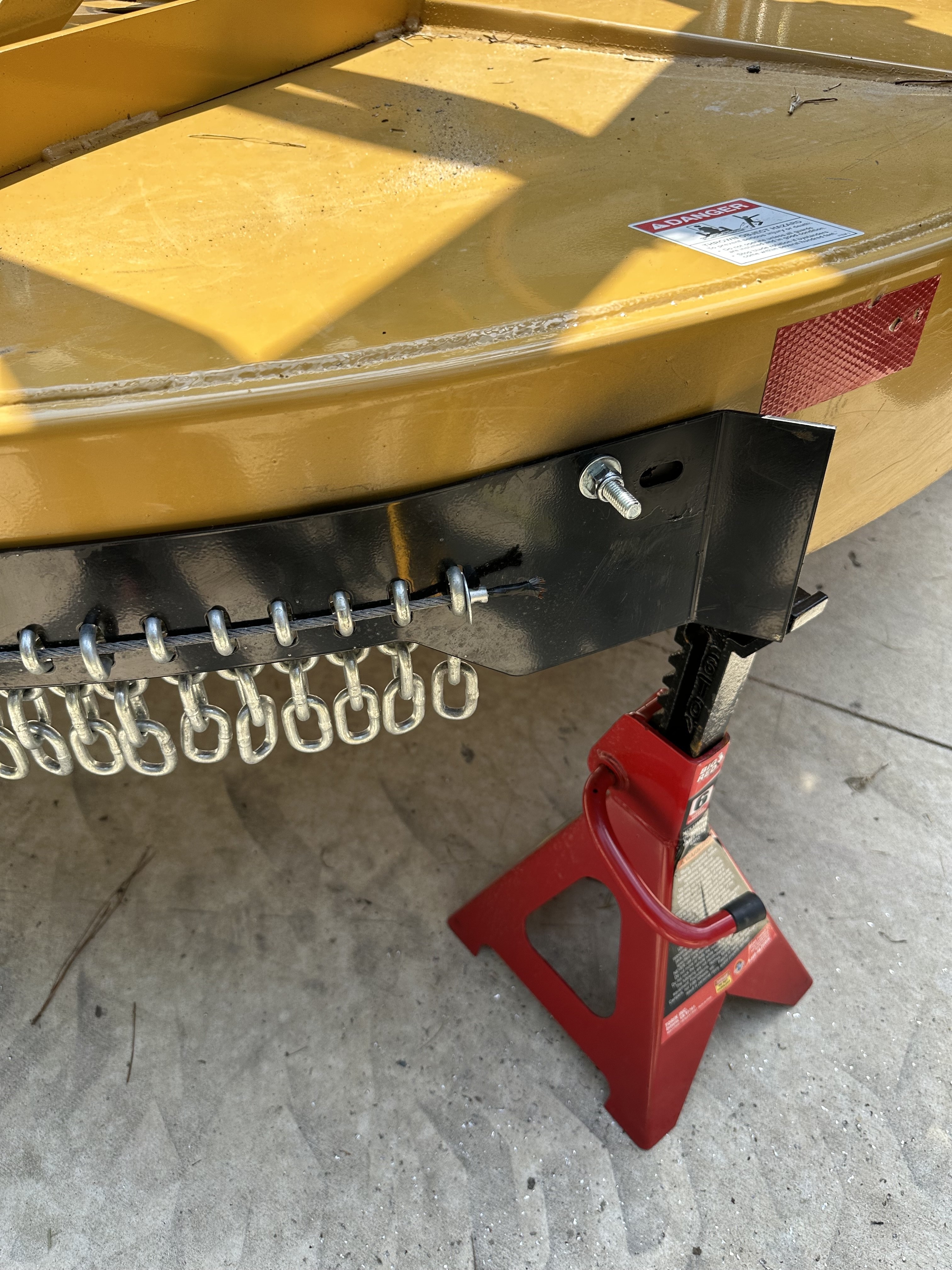

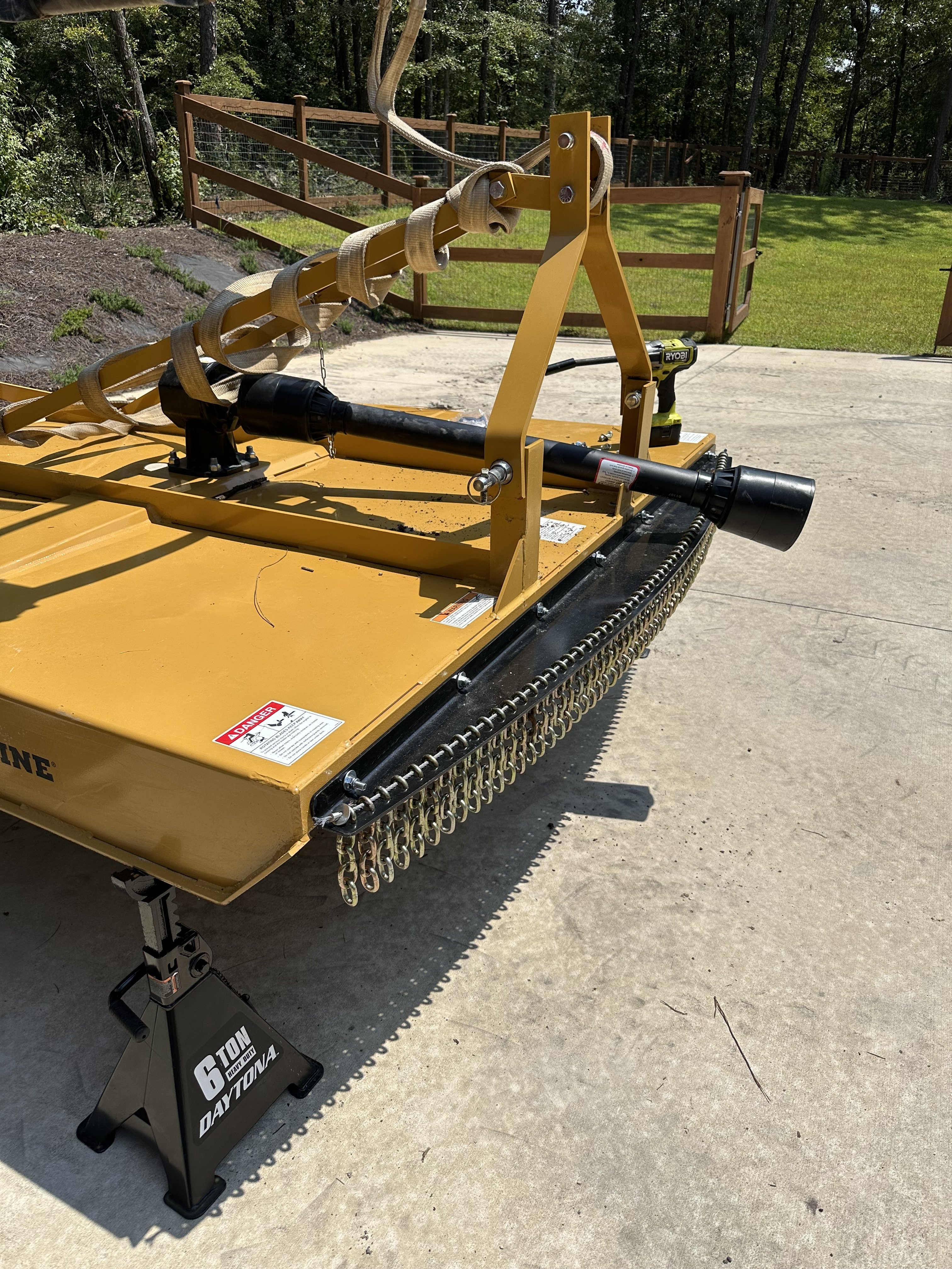

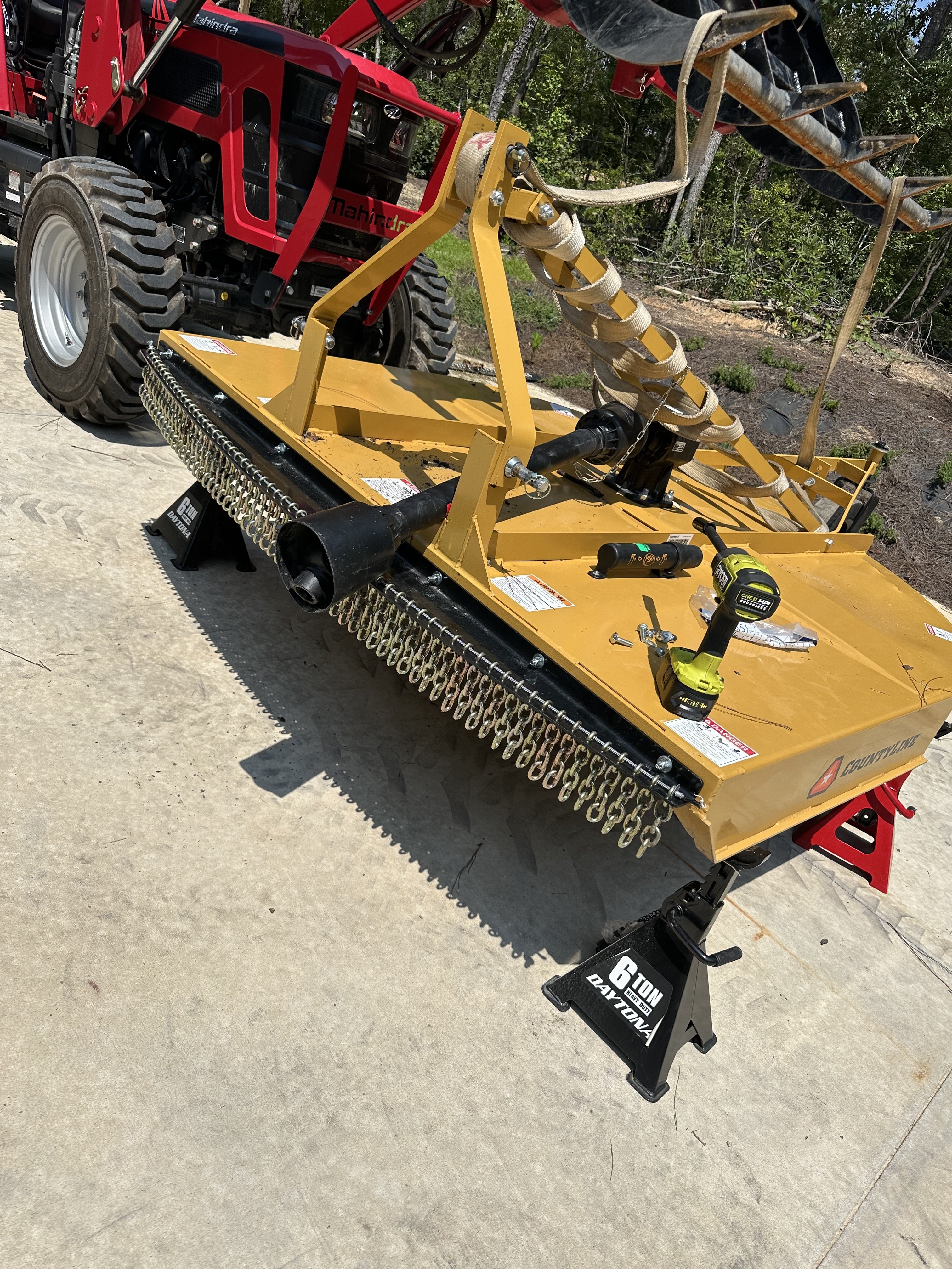

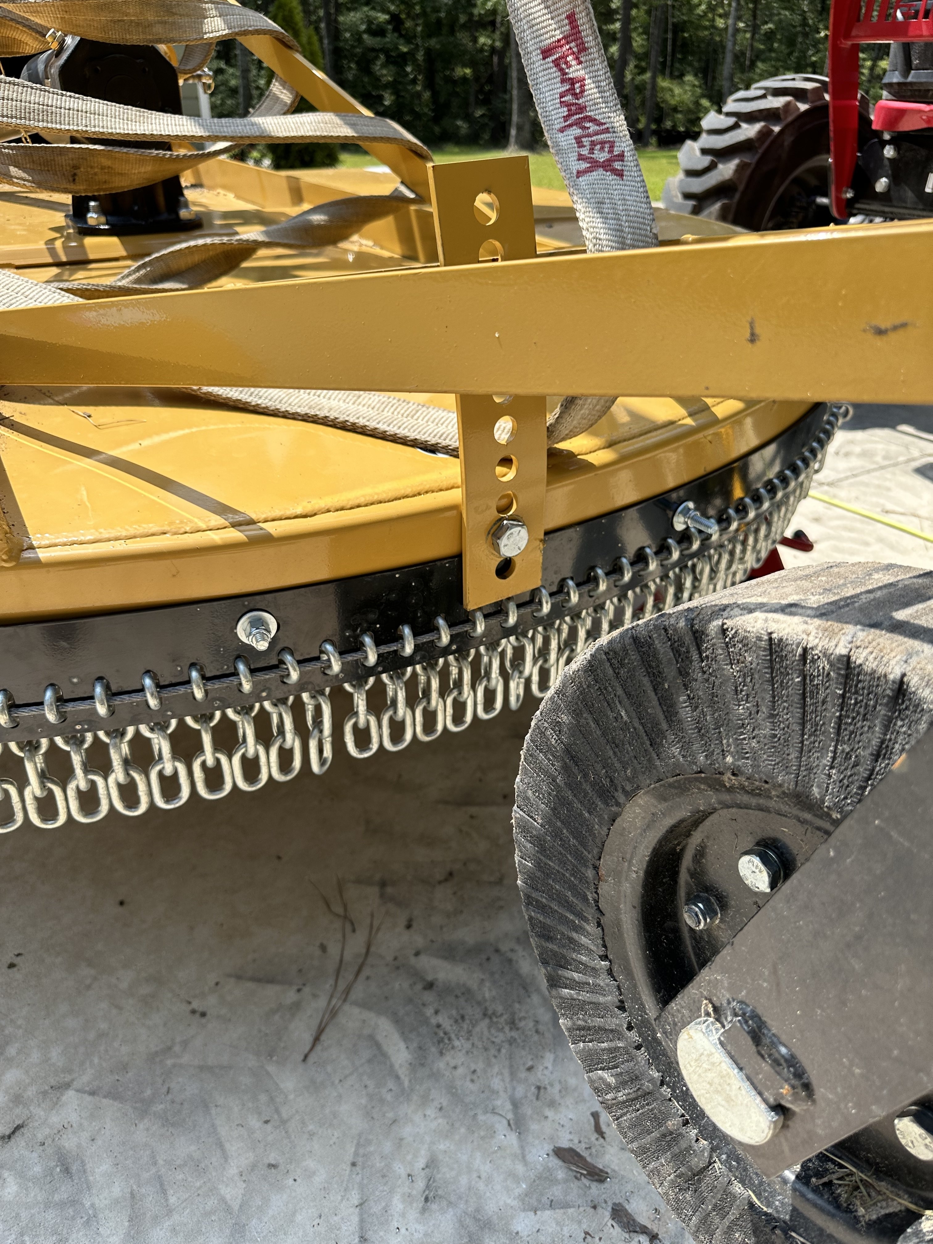

Ok Everyone… I finally got around to installing the front / rear chain guards on my Tractor Supply/County Line rotary mower.
I ordered these directly from Tarter, because Tarter makes them for TSC under the County Line brand name.
My unit is a 6’ rotary cutter, and Tarter confirmed that it is a 200 series. The chain guards are for the 300 series.
The front fit perfectly with zero modification. The rear did not.

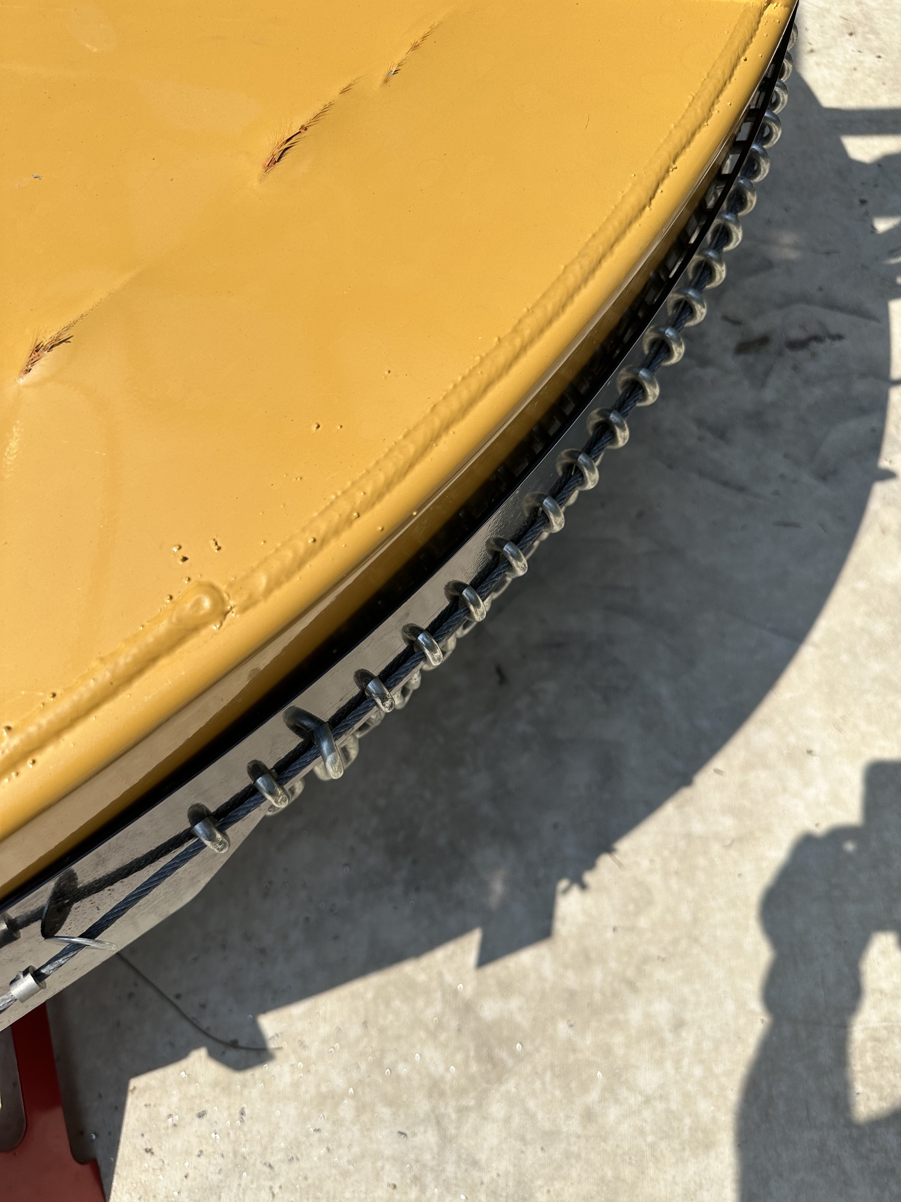

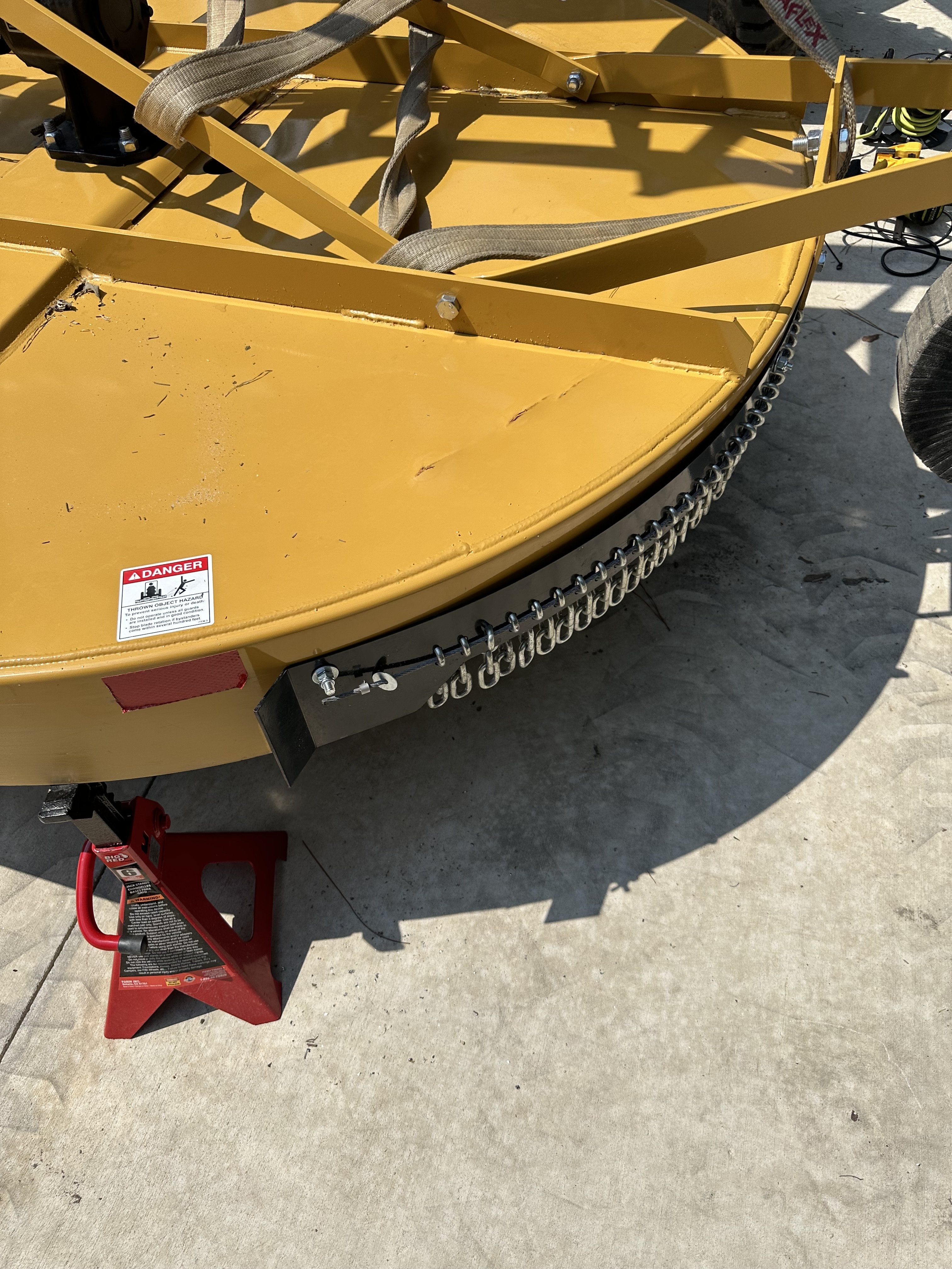

I had to take out the lower bolt for the tail wheel brace, use clamps to hold the chain guard up, drill 3 of the 4 bolt holes and install. I also had to grind a little on the far corners to allow the outside most chain link to clear.
Not a bad job with a little bit of patience.
Now I feel a bit safer!
Cheers!
