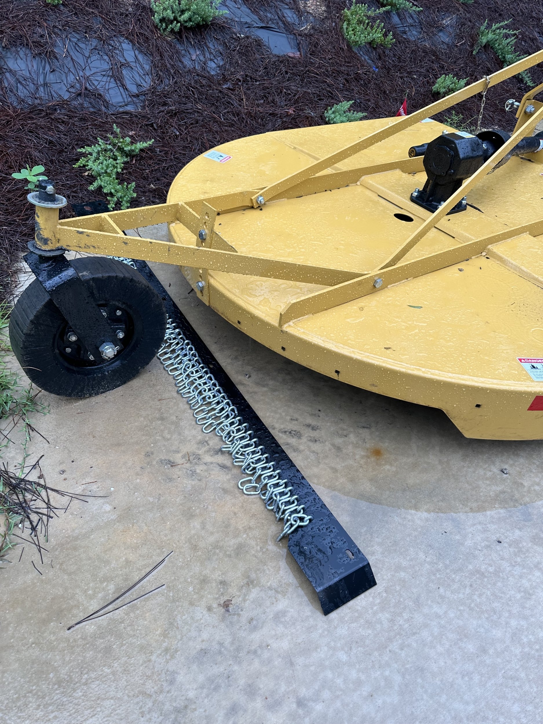

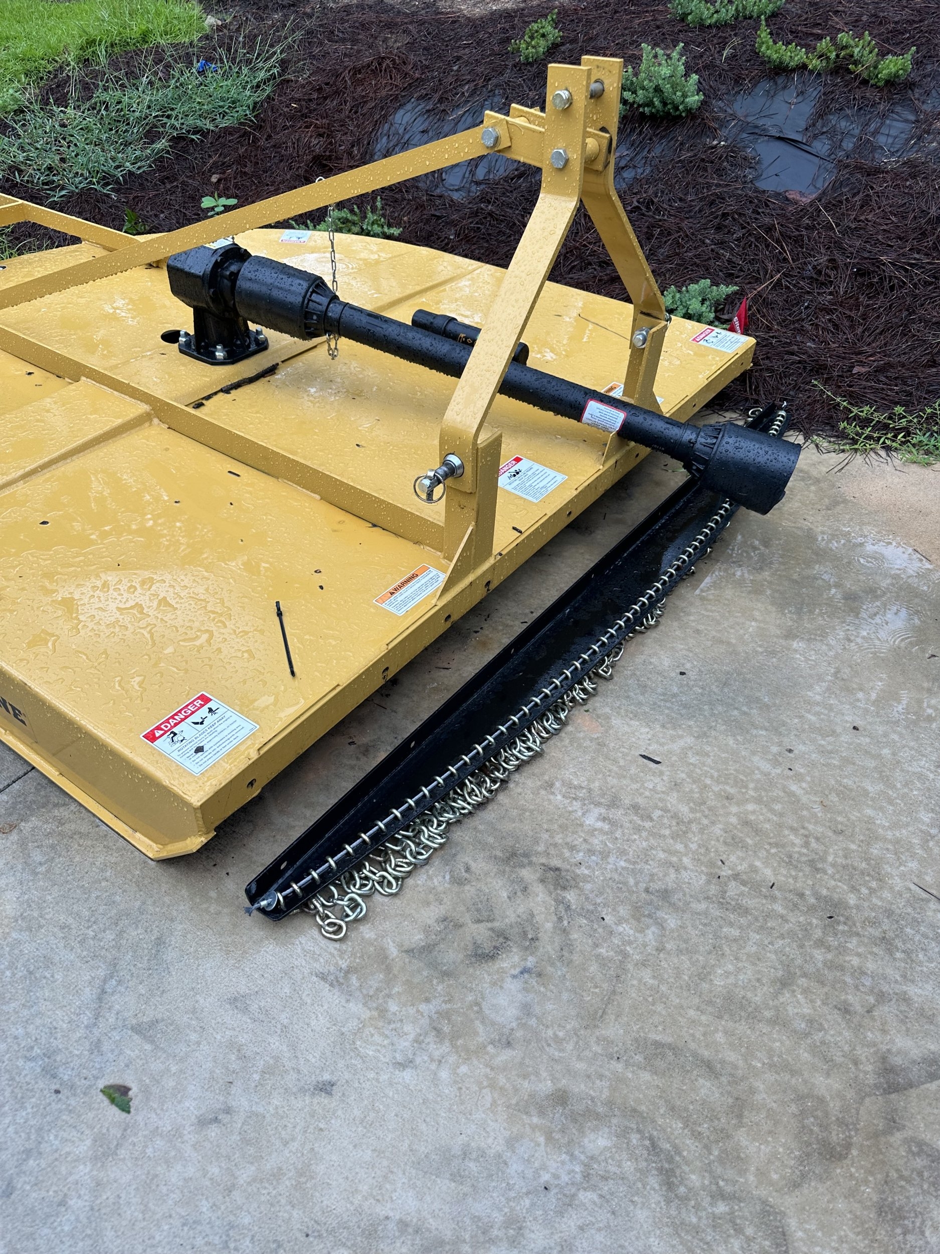

Ordered the Front and Rear Chain Guards from Tarter. The tech there said that Tarter only puts them on their 300 series rotary cutter, but the bolts "SHOULD" line up.
Got the Chain Guards in yesterday. The box was ripped open during shipping but all parts made it to me, save for 4 carriage bolts.
The chain guards look to be very well made, and a cursory fitment before the bottom fell out (TS Debby) shows that they bolt holes DO line up.

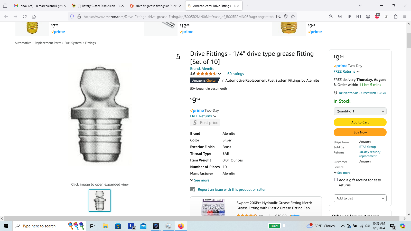

I'm happy with this cutter, but I have nothing to compare it with. One note, the grease fitting that is located on the tail will was missing, I bought one from Lowes, only to find out the threads are stripped. So, I will tap them for the next size up, and put a larger grease fitting in. Not a show stopper, but a mild annoyance.

You may not have stripped threads for your grease fittings, much of the lower cost implements may have drive in grease zerks they will look similar to threaded ones but just drive in, more like a barbed hose fitting.

Thank you for this! Now that you say this, that is exactly what I have. It was missing, so I had no clue. Much appreciated!!!

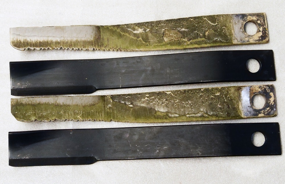

Kind of surprised to hear about the broken shear pins. I've been using my General (Rhino SE-6 clone) for 25 years now and have broken only one shear pin in all that time. And that was not from hitting mounds of dirt (my place is covered with huge mounds created by badgers, the mower just levels them out) but from inadvertently engaging the PTO when the tractor engine was turning at speed and the cutter not rotating at all.
Here's a pic of my old mower blades versus a set of new ones...those old blades mowed a lot of dirt and rocks!
I'm running at 2300 engine RPM on a 55 hp tractor, 47 hp PTO... don't know if that makes any difference. This cutter has sheered 3 since I began with it. I'm surprised as well, because I really don't think I hit anything out of scope... Good thing it's super easy to change. I'm definitely looking at adding a slipper clutch... 👍🏼🇺🇸

Here is the front and rear chain guards... Will install once the storm passes!
