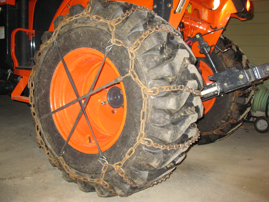

Lou, I did try some very worn, 9/32" 4-link v-bar ladders my neighbour gave me. Here is the photo of those chains:
Although they are on the lugs in the photo, upon use they completely disappeared between the lugs and were ineffective.

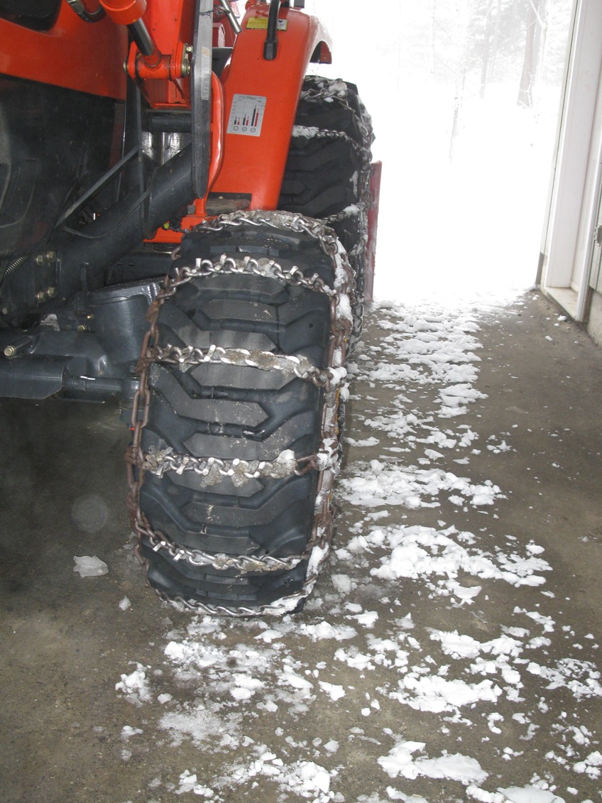

I modified those chains to 2-link ladders this year and they are very good for the shallower front tire lugs. Here is a photo:

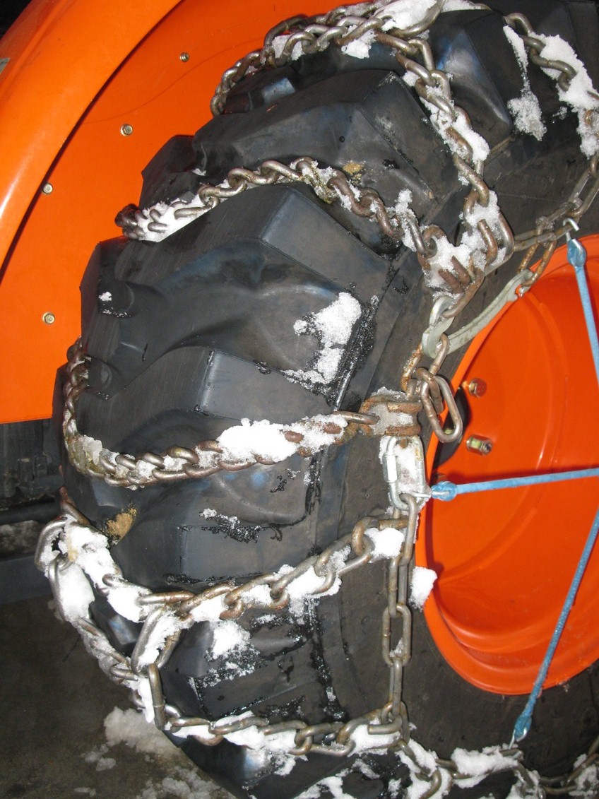

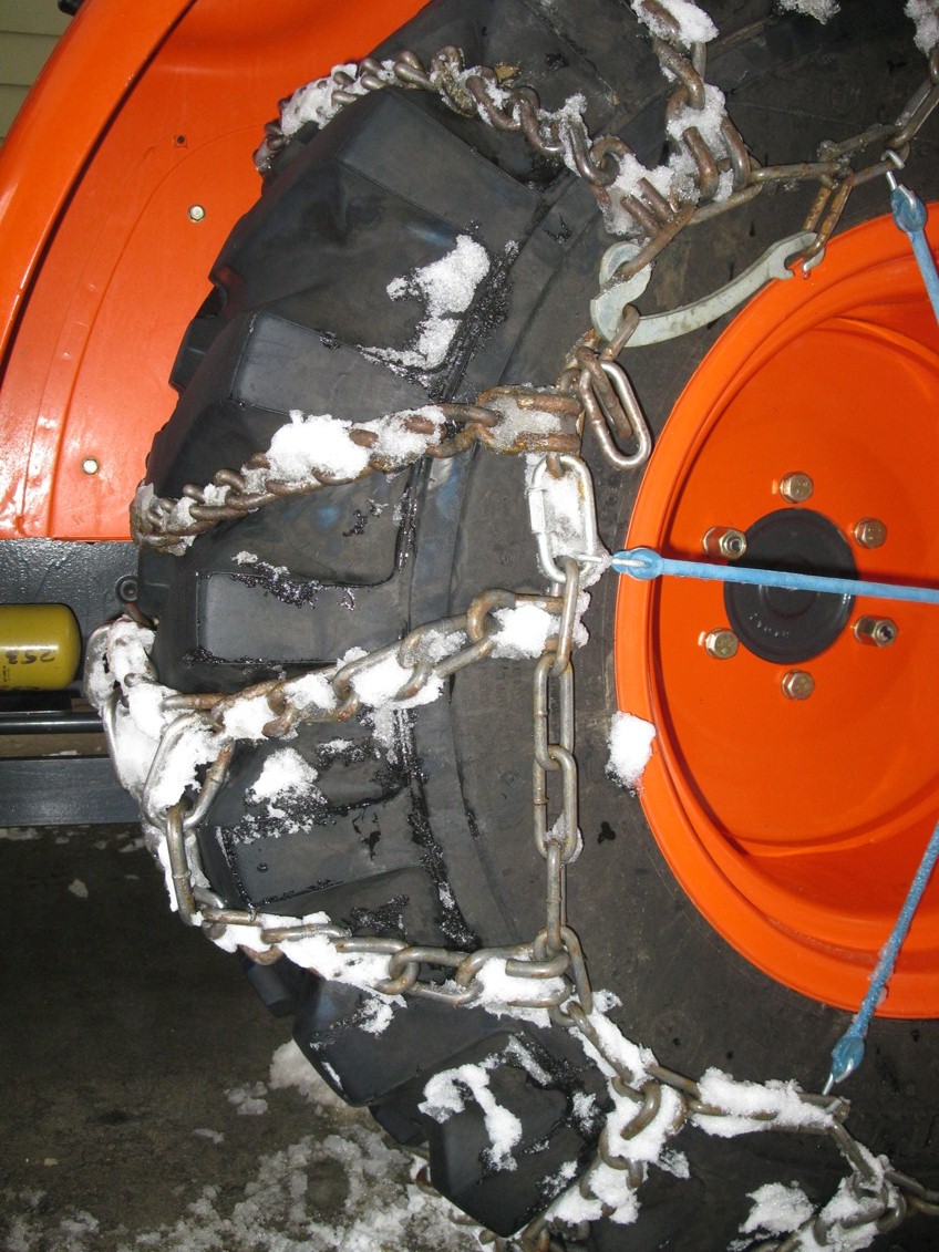

My DUO chains with regular chain cross links I used to fill the gap are the same diameter as yours--i.e. 3/8". In my previously posted photo showing these newly installed cross links it looked like they would ride over the lugs. But they don't--mostly settle in the lugs. Here are two photos taken today, showing them down in the lugs:
There is very little (non-DUO) chain protruding above the lugs. The photos also show the DUO's do an effective job of keeping chain above the lugs.

Great pictures Ken!. It is most unfortunate you cannot run these without the tensioners as this might solve the traction grip problems. You are right about the limited selection for this tire size. I looked at this when I was about to pull the trigger on a Mahindra 3016. The dealer was willing to swap tires from the 3616 next to it and these were the 43x16's. I went home to look for chains and there was not much selection. When he wanted $500 more for the tractor with these, I balked at the deal so I put new rears on the my old 750 and continued to use my old chains. I was a bit worried with the new tires and these chains but the chains react just as they did on my old set. Mine are loose and traction is excellent with them. I also think the Nordic chains are the best but I think you can manipulate what you have to produce good traction.
I think we are looking for different things traction wise. You are wanting grip on ice so it is important the chain rides proud on your lugs. I'm looking for increased woods traction when logging so my chains always come to bear in this regard. This is a great discussion as it is bringing out all the mostly unspoken details of tire chains for our tractors.
