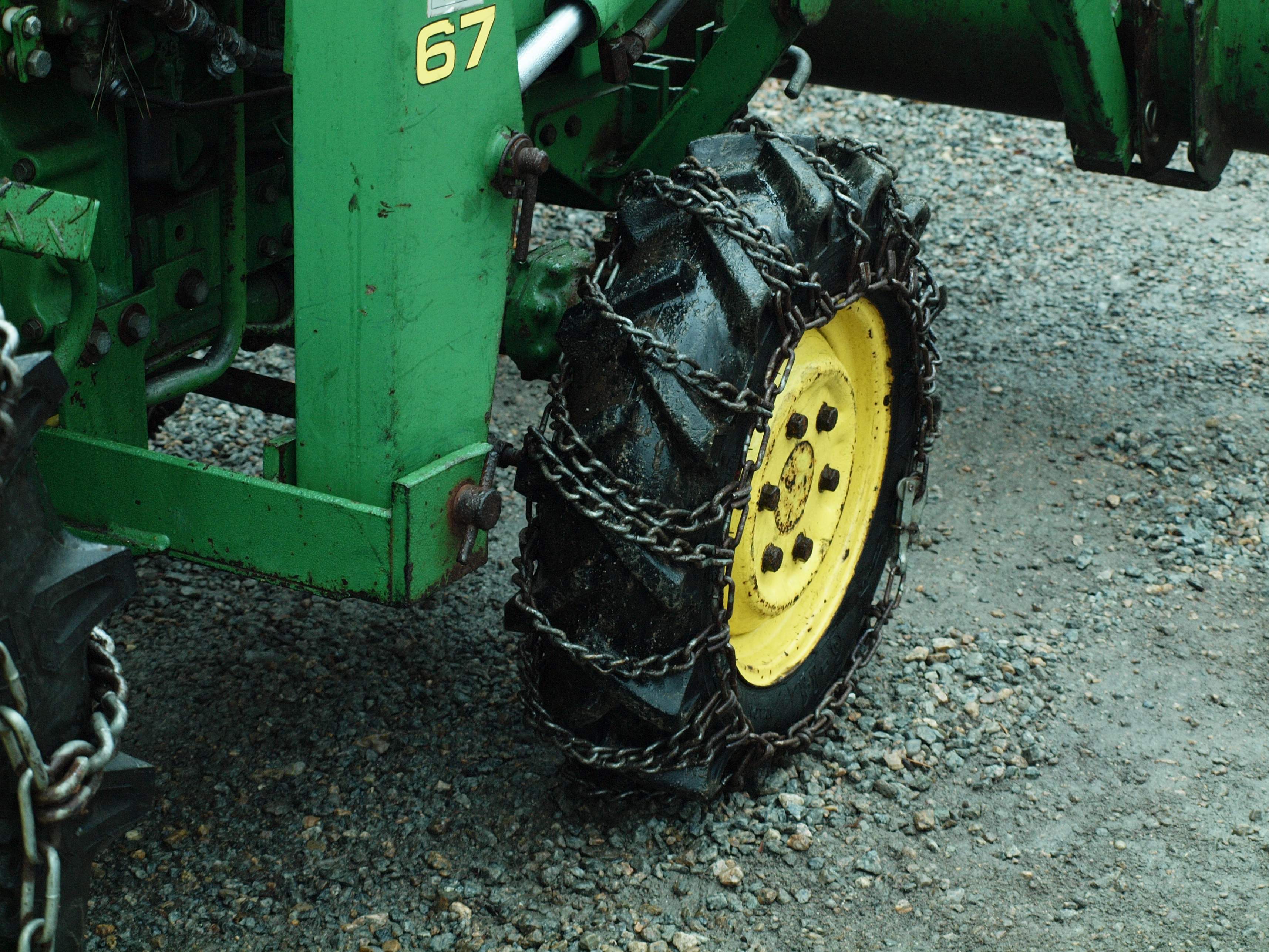

Whenever discussions of chains come up, there is always talk about chains falling between lugs and becoming what? less effective? Basically I think this is an old wives tale for several reasons. 1. Chains are sometimes put on too tightly. As a result, they cannot "work" themselves into the largest benefit for traction when the tire comes around and the chains meet ground. 2. With looser chains, it does not matter a wit what they look like on top of the tire, its how they engage the ground on the bottom. 3. Even with tight chains which look like they are sitting between grooves, I have never failed to see the chain imprint on the ground whether it'd be snow or dirt. I've got the simplest type of chains on my ag tires (4 link ladder) and even these have turned my tractor into a different machine traction wise.

No offense, but your chains are riding on top of your ag tires lugs. Heck, the chains look like they are taller than the lugs on your tires. I really dont think tight or loose would make a difference for your application. My R-1's are 11.2-24 on my fronts and the lugs are much deeper than yours (less than 300 hours on them) and if I had a standard 4 link set-up, I think the lugs would hide the chain the majority of the times. If I had them loose, there wouldn't be any pressure pushing the chain into the snow/ice and therefore no traction. Hence why I went with the Duo-grip V-bar style. They made a big improvement on the ice, but I think I can modify them to be closer spaced and get more links on the ground per rotation instead of the gaps that I have now. The V-bars also need to be somewhat tight to make sure that the "V" faces the ground and doesn't roll into the tired tread negating the grip.

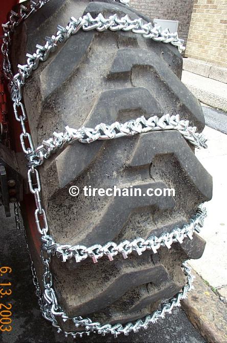

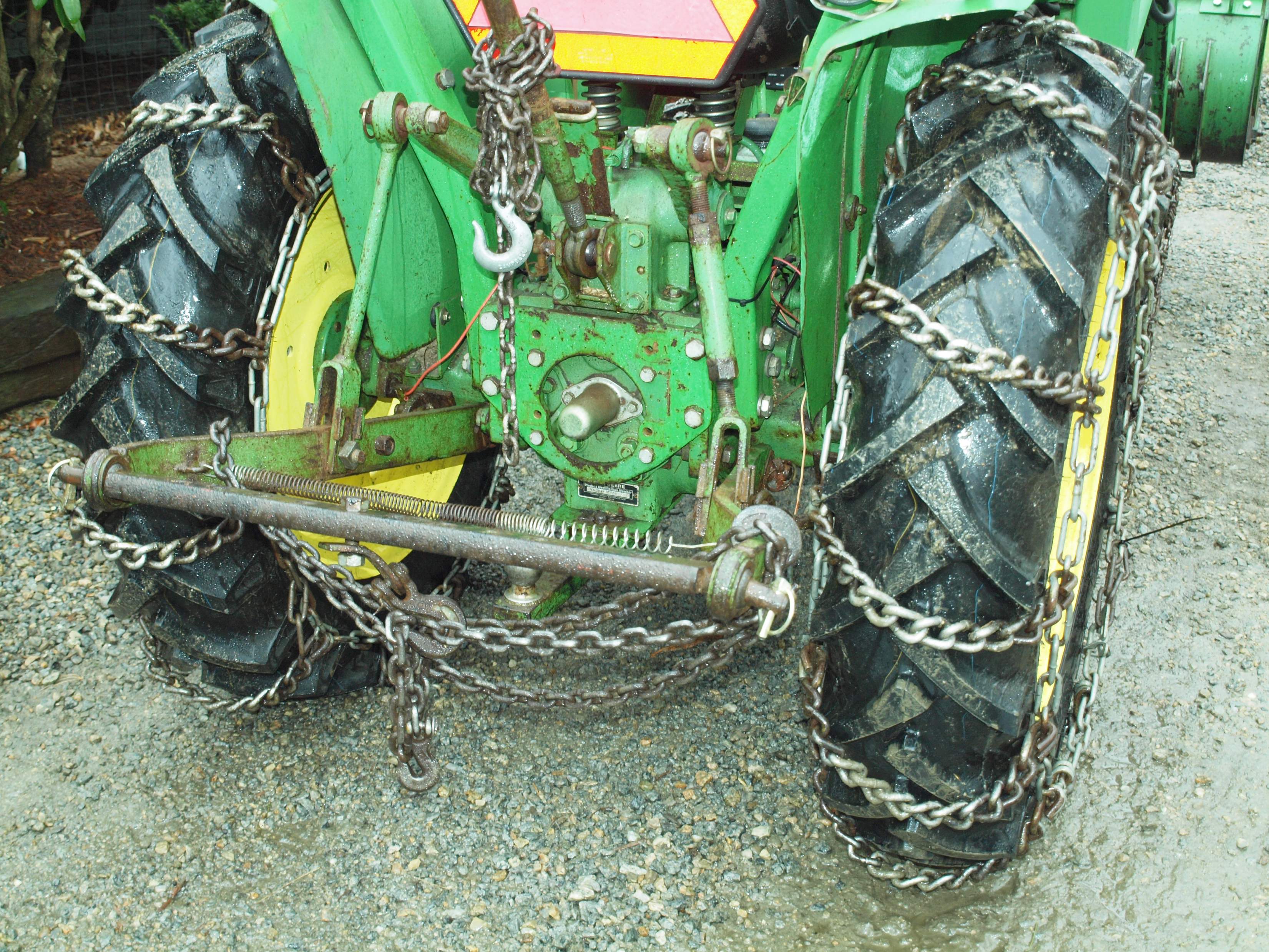

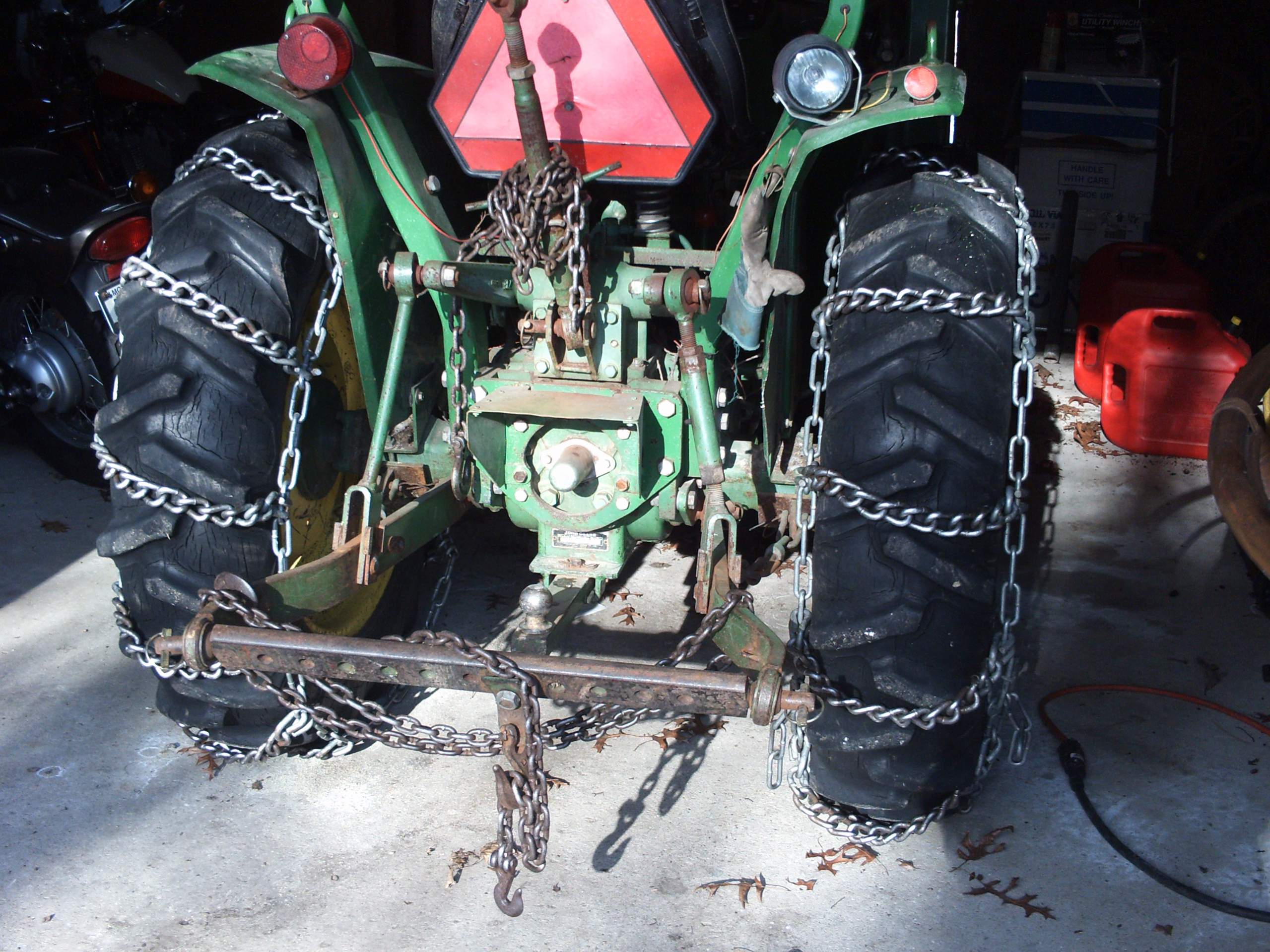

No offense taken. I don't mind a good discussion with opposing view points delivered as gentlemen; that's how people learn. Now I'm going to oppose you. Here are pictures of same tractor with new tires with not 3 hrs on them. The fronts do not have 10 hrs on them. My chains are loose and are able to sort of seek their own level. They are what strike the earth first and whether they are here or there, loose or tight, they will always provide more traction. I cannot agree on your theory about chains needing to be tight to provide optimum traction because chains will only go so far before they dig in even if they are loose. What helped you on ice was the v-bars. If you cannot run your chains a little loose for clearance problems, then you may run into the trouble you are describing but it is not a standard,be all axiom for chains to always attempt to state: "these chains are no good because they ride between the lugs" in my experience. If I believed that, I would not have bought the simplest chains which have aided my traction immensely and have cost under $300. So now we are at a point of disagreement based on our own experiences. What might be the differential as to why this happens sometimes and not all the time? My fronts are small and in comparison ratio, so is the chain yet the same thing is happening with them as what's going on with the rears so I am not certain tire size and lug depth are what provides this differential. I'm thinking tight fitment is the culprit. Lug angle may be another but my old tires were a lesser angle and the chain still came to rest on top of lugs at traction point. It seems no matter what the tire there appears to always be the ability of chain traction even with simple ladder chain. As a matter of fact, ladder chain may be the better solution than duo grips.
