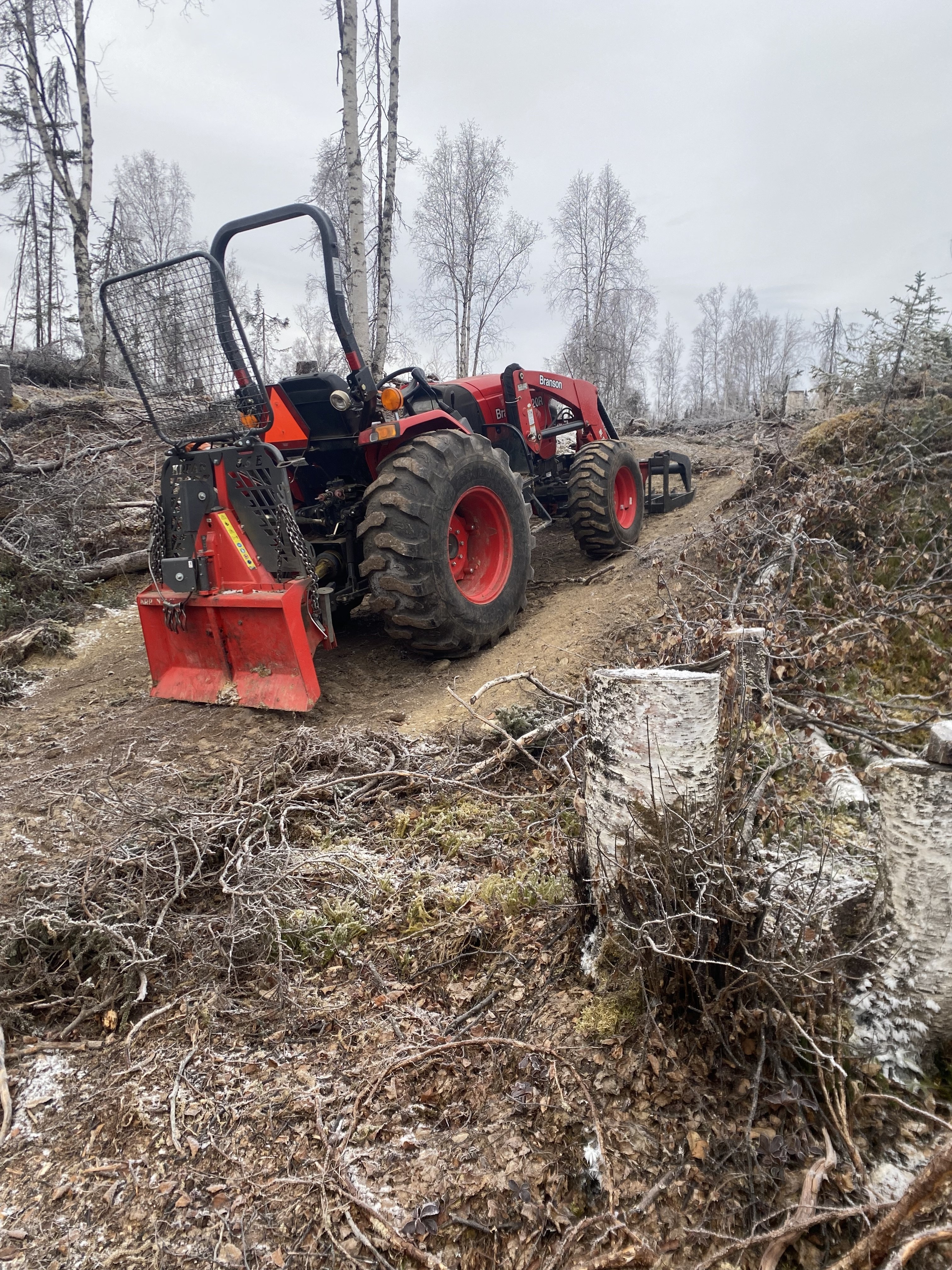

Just looking for advice on what to get for my tractor this winter…that won’t cost me a fortune 😬
I have a fairly steep and approximately 15’ ridge to climb while hauling logs out. Logging my property for past couple years and selling firewood as I go. With a pto winch I can do so through the winter too and just plow the logging road I made.
The land is mostly flat but this ridge is going to a pain this winter.
I will be bending my fenders out to make enough room for the chains. But chains need to be tight or it could end badly. So i am particularly worried about the ladder style and any slop from them.
Definitely looking for advice from people with experience dealing with different chains in snow and ice. We get about 12’ if snow average around my area.

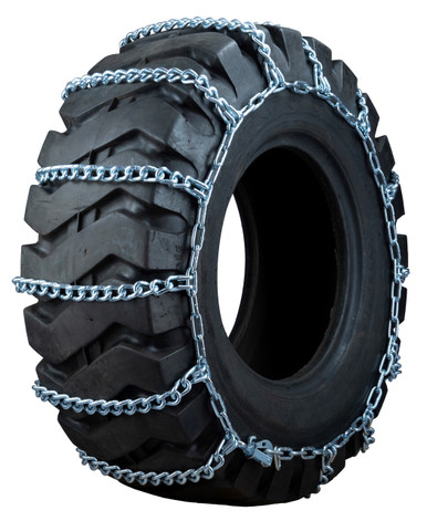

Here are possible options at this time:
My local Branson dealer has these for $643
Ladder style from Quality Chains
Glacier Chain Supply in Anchorage has these for $877
Aquiline MPC (Multi Purpose Chains)
I can get these Piedmont Duo style from Tirechainsonline for $600 with free shipping to Tacoma Wa where Carlile MyConnect shipping can ship it to their Anchorage terminal for around $60.

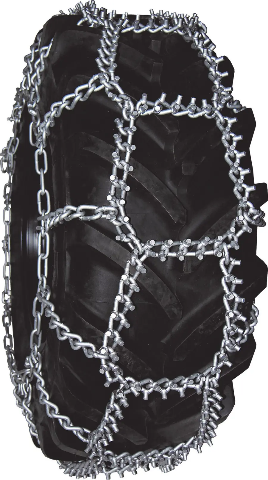

These cleated Trygg chains are excellent, but not if you need to run over pavement or concrete.

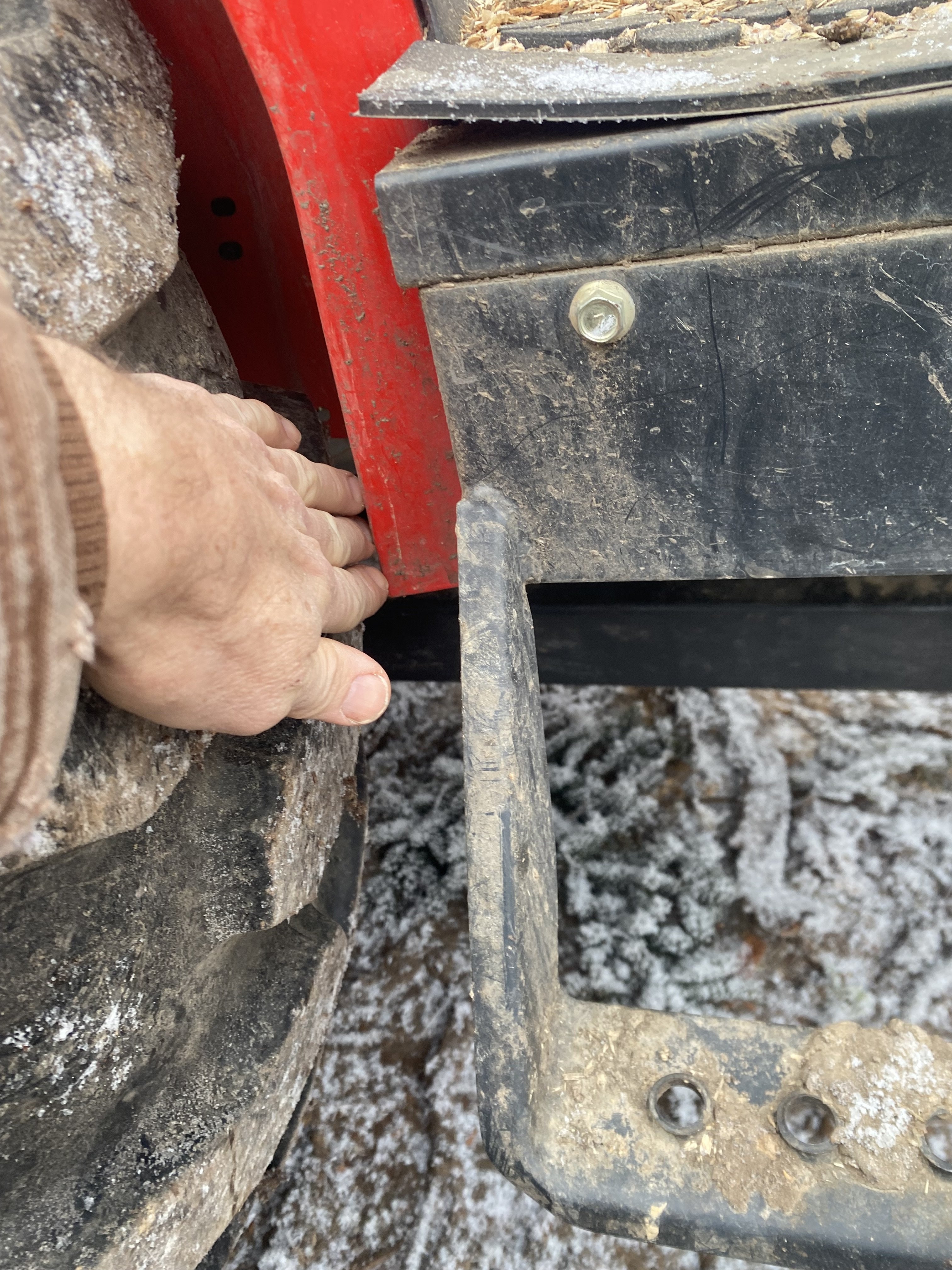

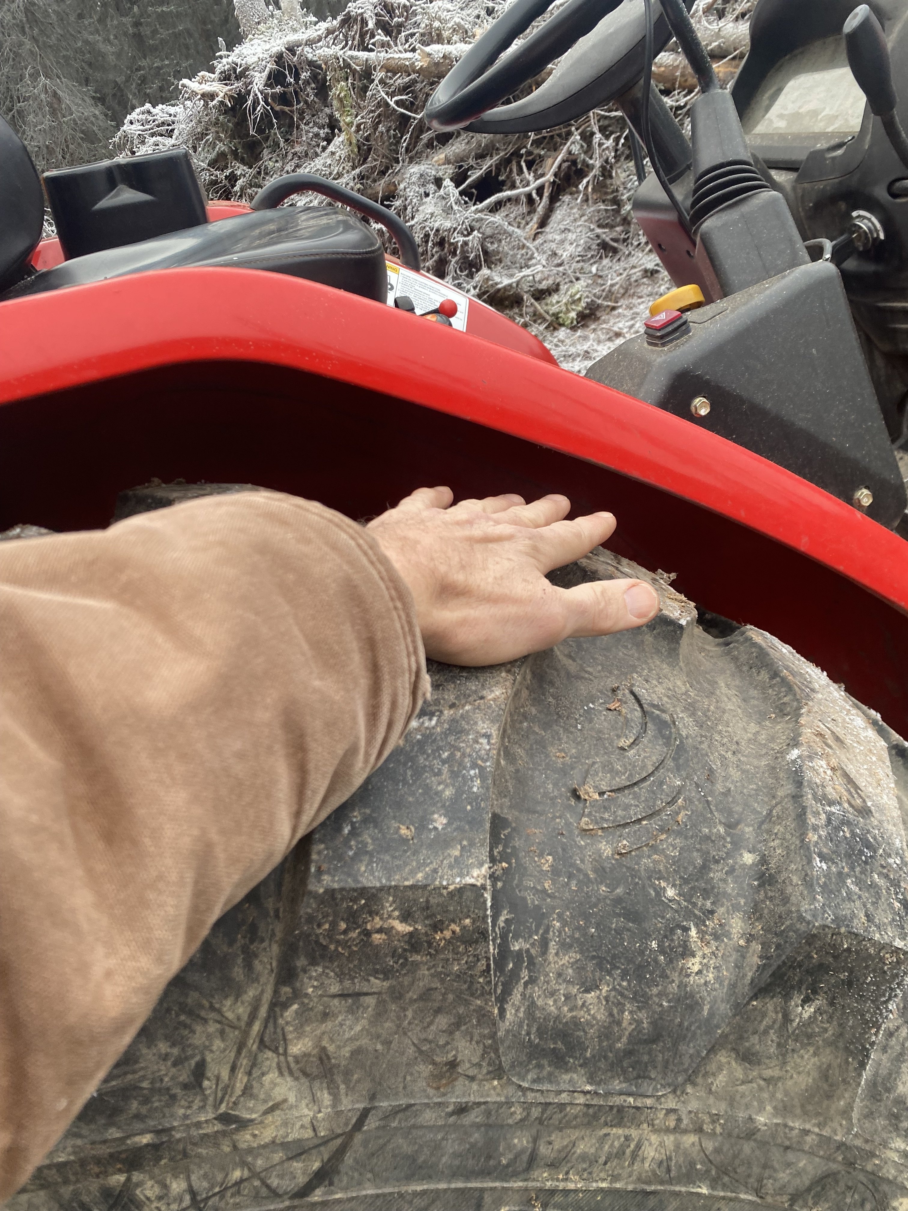

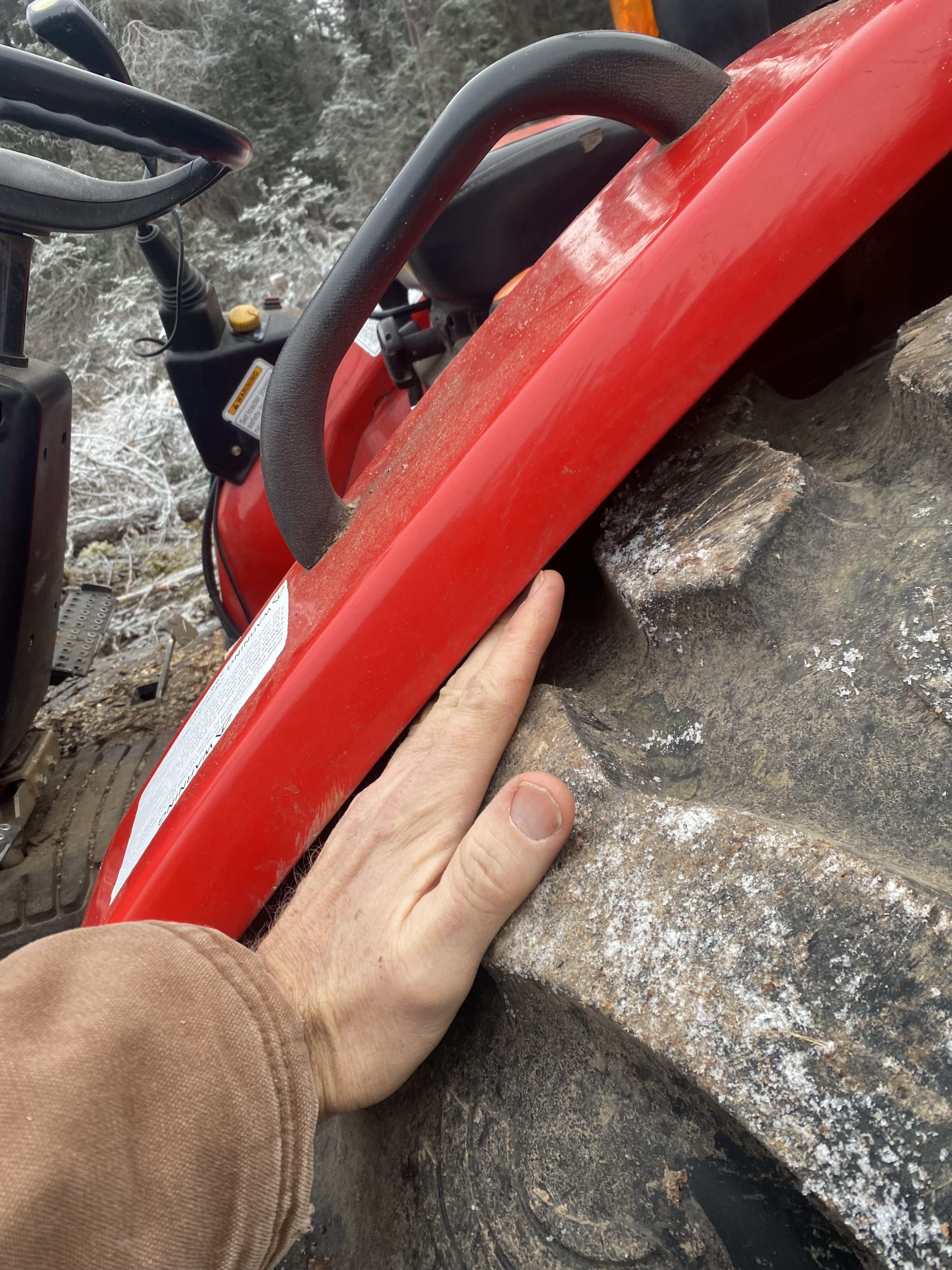

Yes but with larger tires
Pictures
My hill
One fender was bent upward already from a logging hack getting caught.
The other two pictures show what i am dealing with.
Like i said, the fender is getting bent up or cut if necessary.

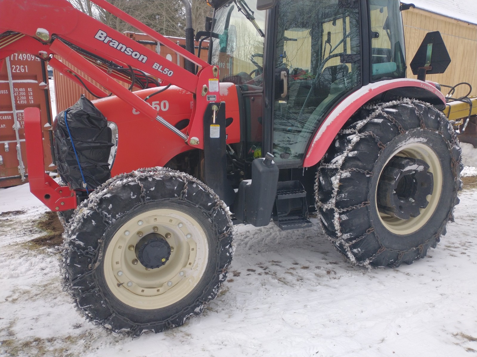

The Aquiline MPC are the better of the chains you listed, The Aquiline Talons will work much better then any you listed, the same with the Trygg studded in post #4.
At normal working speeds the chains will not stand up and sling out much.
This is the clearance on my IH 574
And my Branson all chained up
And notice no tighteners or bungee cords, even when roading at up to 17 mph no issues. Also I have not had any issues with pavement this tractor has been roaded several miles several times while chained with no excessive wear or tear on the chains or the road.
On the farm chained up tractors have road traveled at 12-16 mph for many years on paved roads with no road damage. They provide enough grip that it's not necessary to spin and chew on pavement.
No conventional style of chain will provide any-wheres close to the traction and with decent ride quality.

Can you add spacers where the fenders mount to the axle to increase clearance or does 3 point lever and other items go through the fenders making this a difficult option also.

That's mighty tight. The guidance I have seen calls for 2" of clearance. Looks like you have 1" at best.

Yeah, nice idea but I don’t think it will work. Will look closer tomorrow.
