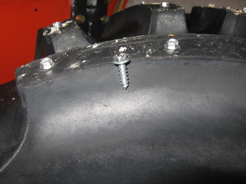

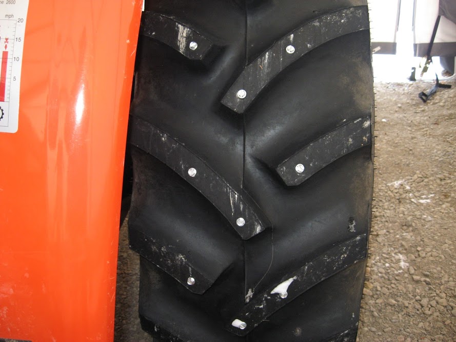

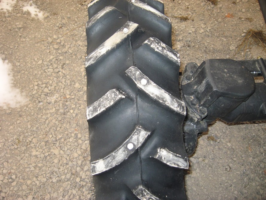

I've studded my tractor tires with hex head screws when we had some severe ice build up. Worked pretty well and gave a bit more traction on ice to get up and down our hilly driveway, but certainly not enough to damage the driveline. The screw heads hardly wore at all and only the fronts came a bit loose with lots of sliding, but I just tightened them back up when I noticed. I didn't loose any screws or have any break off or even get damaged, but I was only on my driveway and not running the road with them. Anyways for $20 it got the job done and they sit on the shelf if we get another ice storm. studded tire front.jpgstudded tire rear.jpgstudded tires.jpg

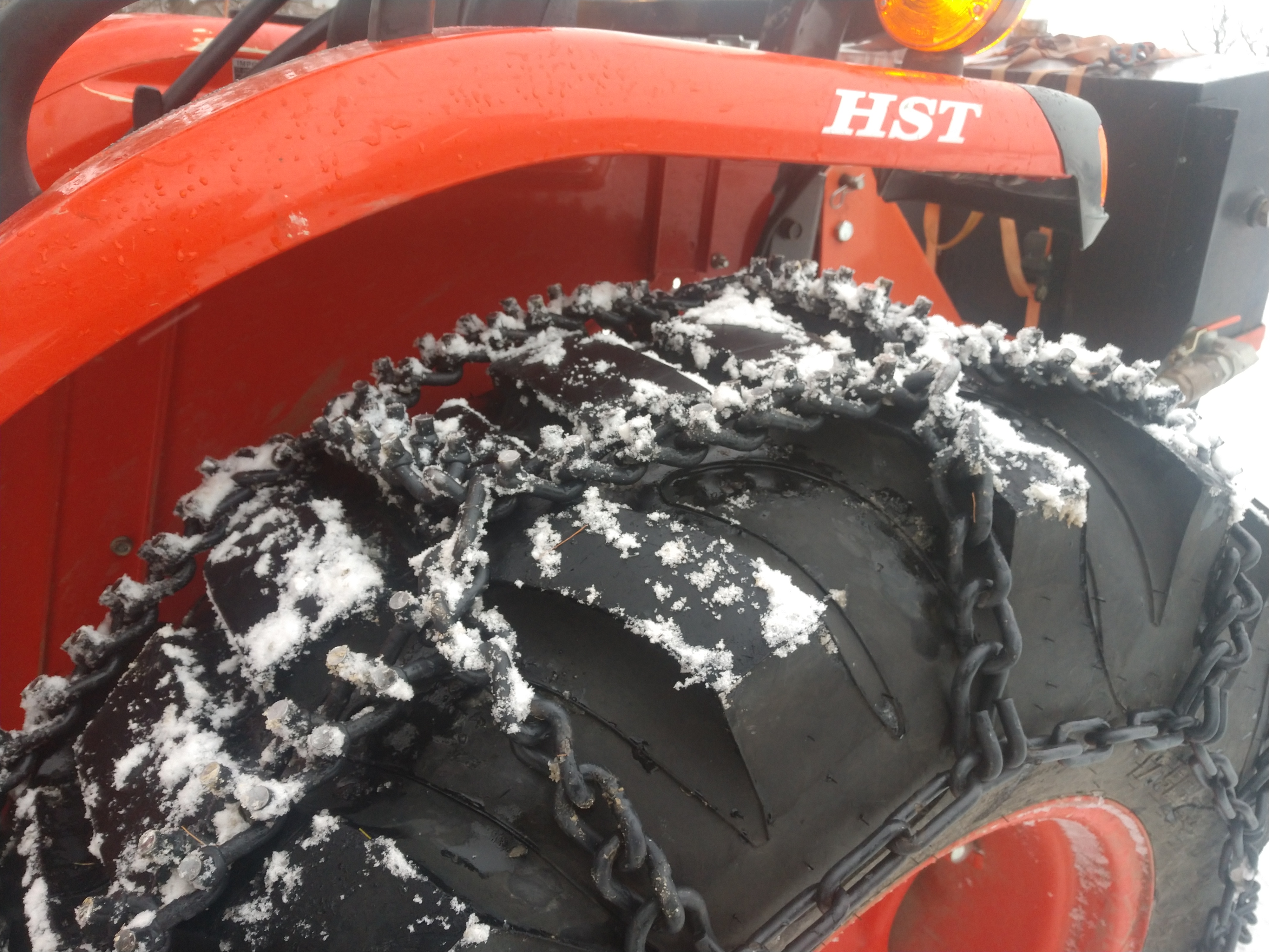

CHAINs....that you already have. and they will solve your issue.IMG_20200131_160332681.jpg
