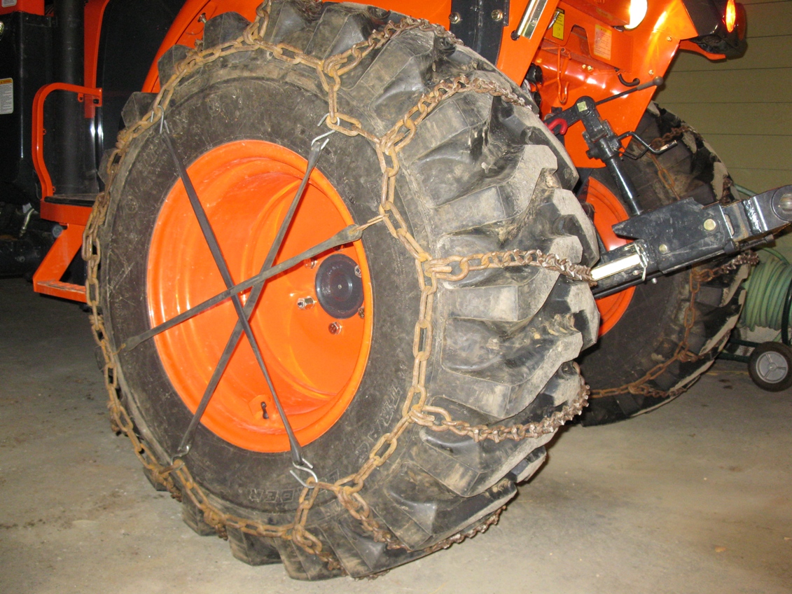

I ended up stopping by Nash Equipment right here in Colebrook, NH. They sell new and used equipment. They had a good selection of Trygg chains, from Norway. They also had used chains available, but not necessarily the exact size I needed. If I had more confidence and experience, I could have gotten a real good deal and probably cut them down to fit. But since they had the exact ones I needed sitting right there in the box, I went ahead and got the new ones. I had called around quite a bit, and they had the best price, plus they had them in stock. Now to put them on!

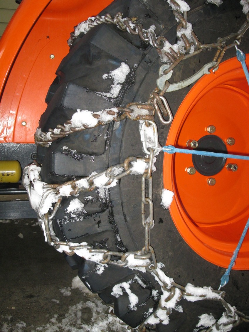

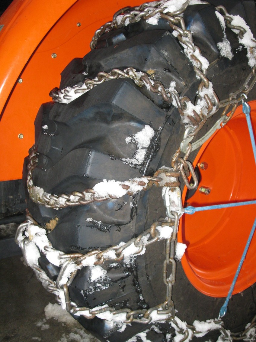

I found a pair of regular H pattern chains on craigslist. Trying to mount them Ihey were too long. After talking with a local used equipment dealer I followed his advise and mounted them anyway overlapping the ends by a foot or so.They added a lot of traction but ended up in the grooves between the lugs after running them.
The next summer he got in a pair of double-ring H pattern, he said the double rings tend not to fall into the grooves like the single ring. They fit well and he gave me some bed springs and short pieces ofchain to use as tensioners. I am very pleased with the double ring chains for plowing my gravel driveway and they work well in the dirt/mud too. He told me they aren't good on pavement at moderate speed, so be careful if you travel on pavement..
I was patient and waited for something to come up because they are expensive. I had bought the regular ones for $50, sold them on craigslist for $100. The slightly used (chrome worn on contact area) double rings went for $150.
Net cost $100
