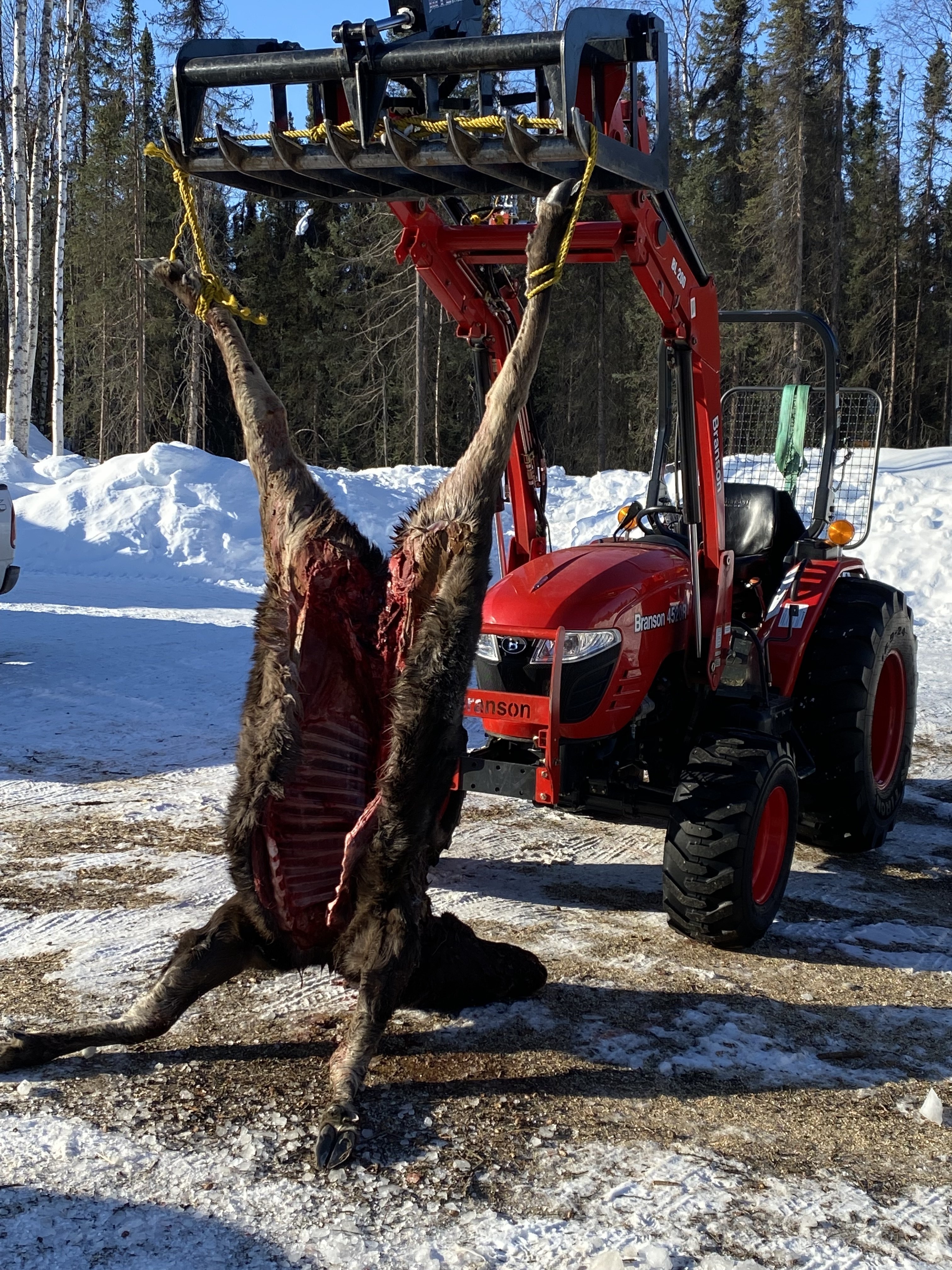

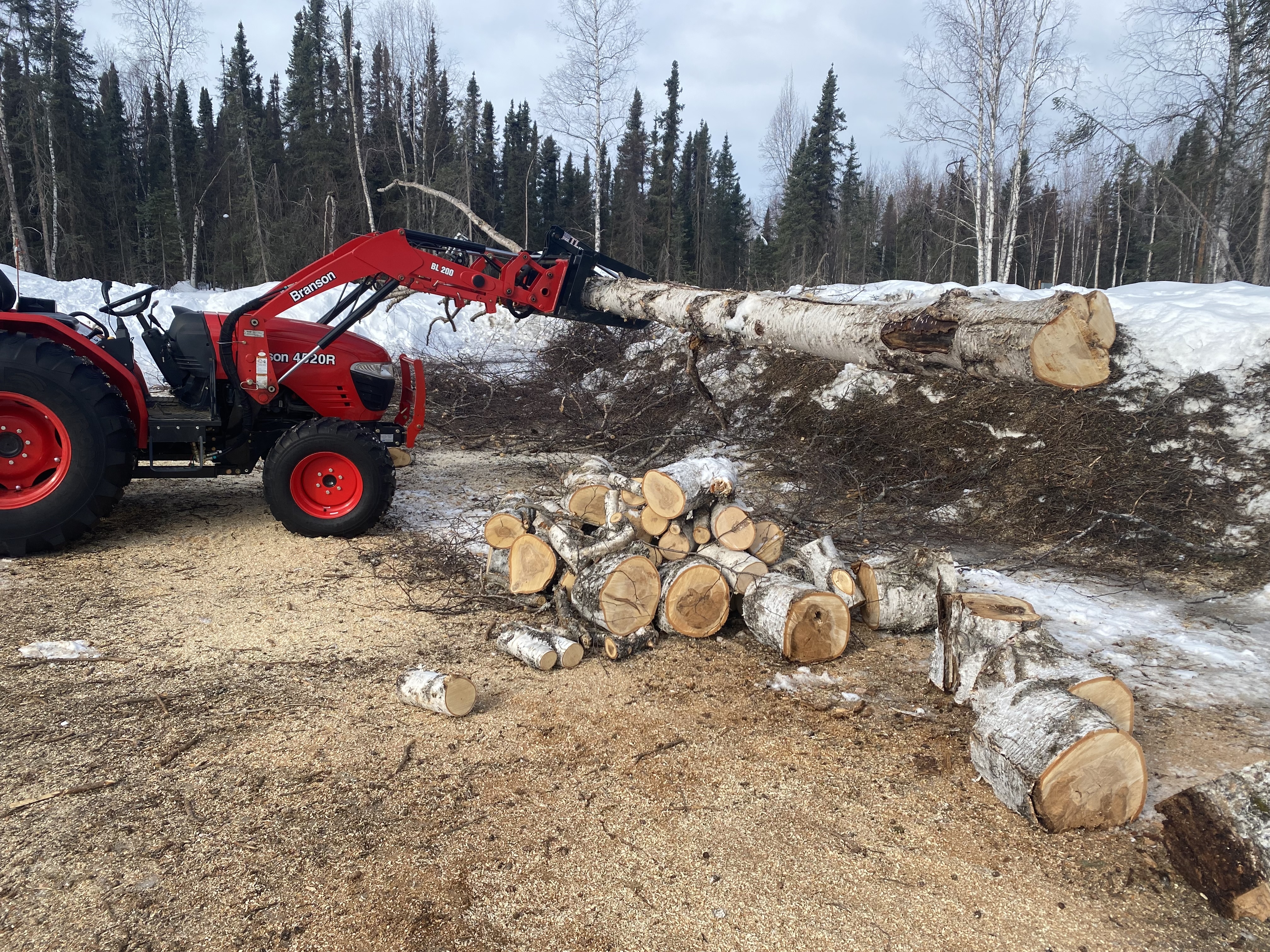

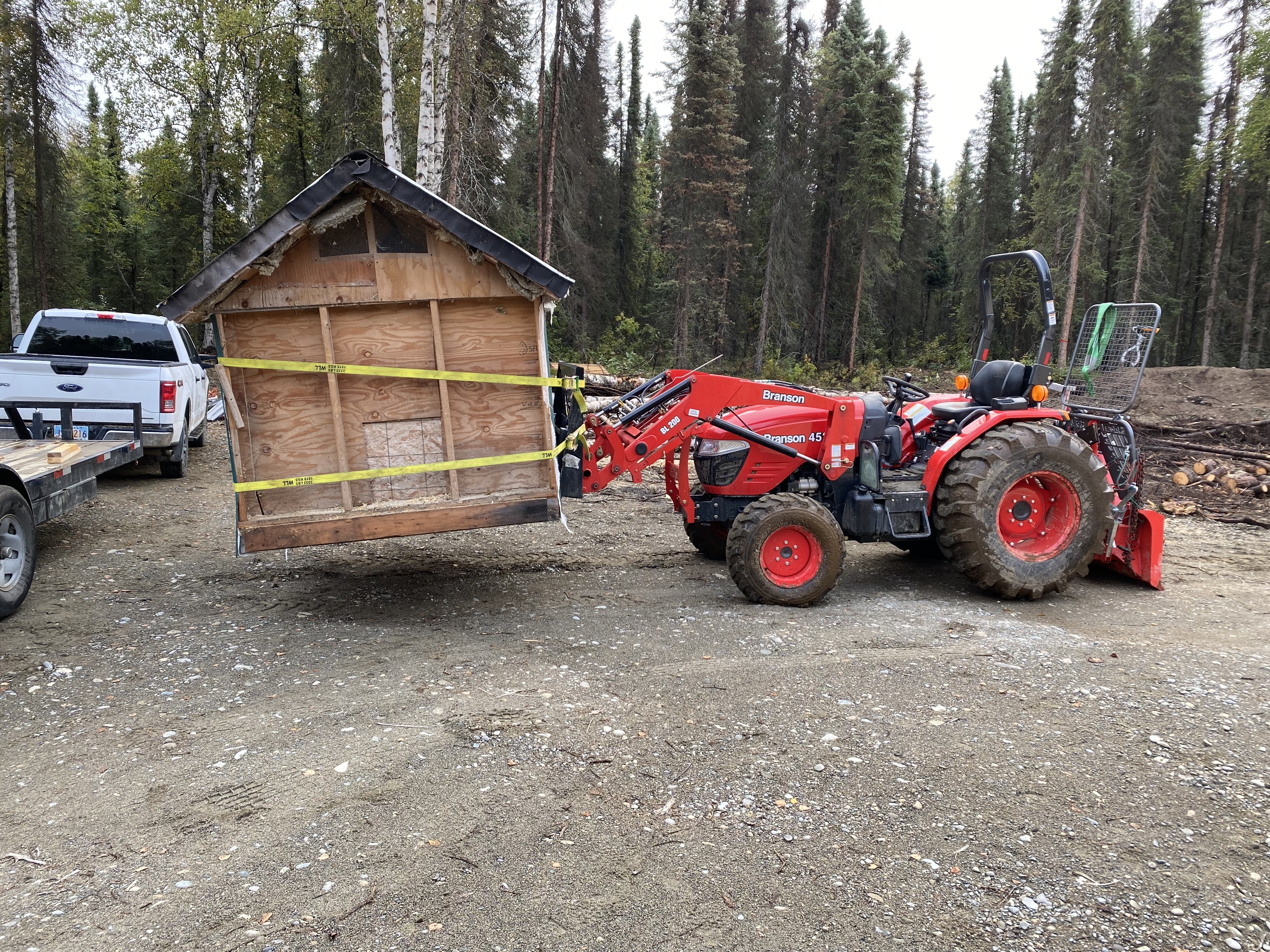

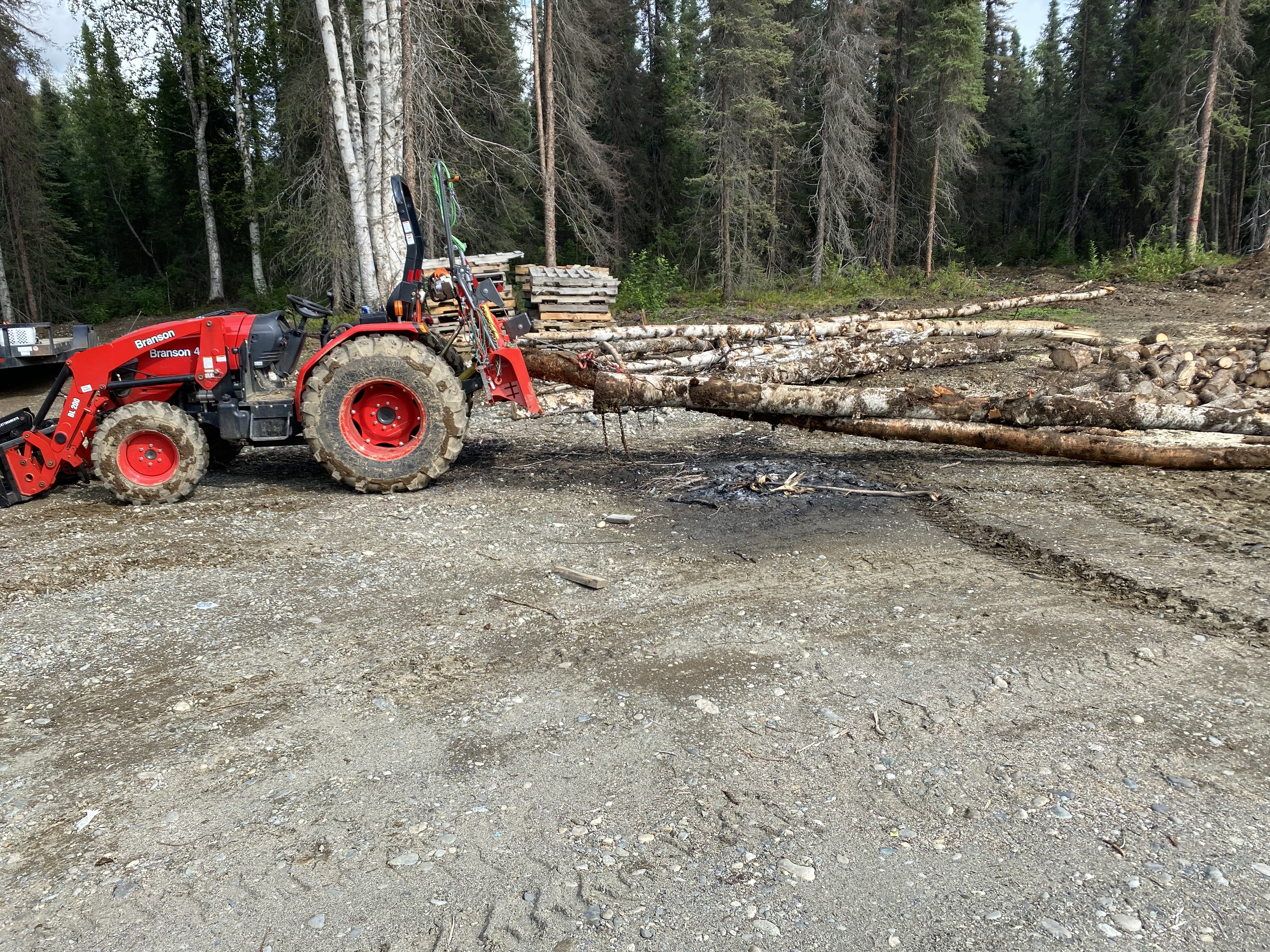

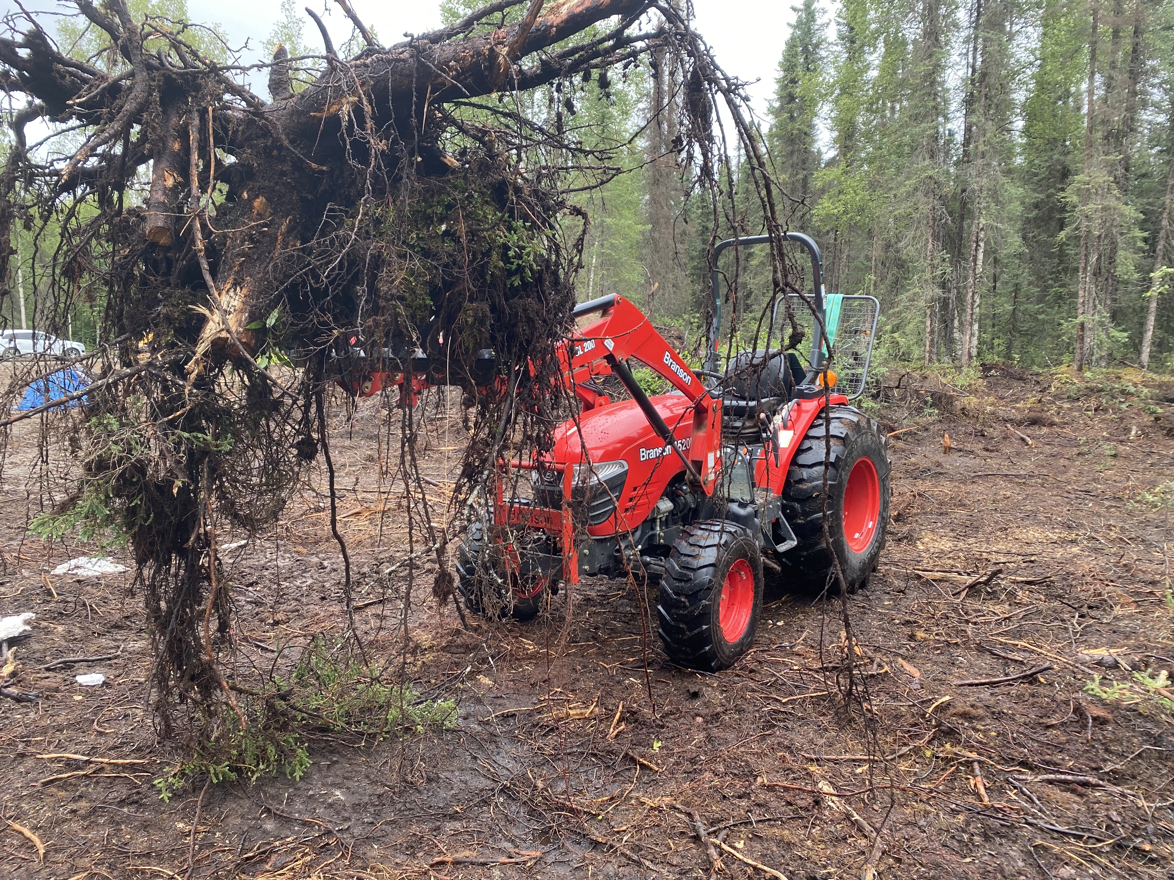

Someday I’ll retire this tractor to easy farm work like haying, berry picking, brush cutting, and tractor rides.😜
Meanwhile, here is a few pictures of what it gets to do.
