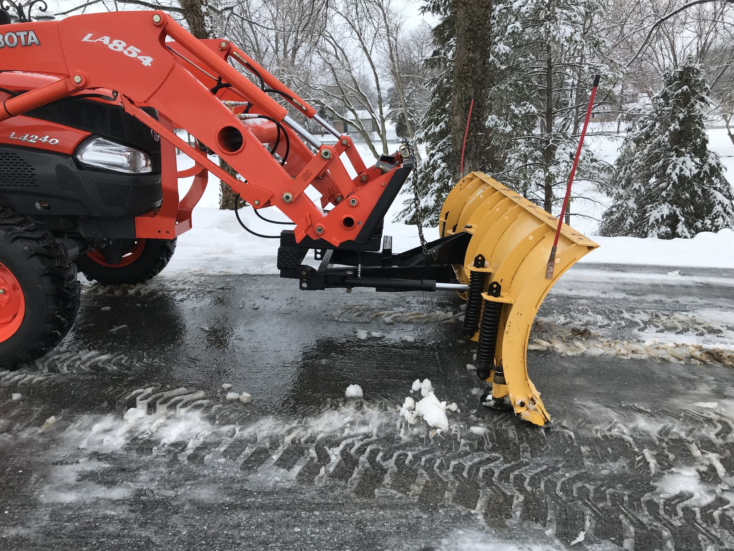

There's one place I could use more slop. Our driveway comes in flat from the road, then has a fairly steep hill that transitions into a larger parking / turnaround area. It's difficult to get a spot scraped clean unless it is approached for a certain direction because the tractor and blade don't "swivel" enough to keep the blade flat on the paving. The paving has a slight twist in its plane. Picture having one side of the tractor on 4" blocks while trying to have the plow sit level.
Glad that Gordon and others came up with the underslung idea. Keeping the plow tucked in close does lessen the rudder effect. Mt plate is mounted at an angle that puts most of the force on the top edge of the QA plate. There's not a lot of stress on the locking pins (unless backdragging). Kinda like jamming your toes into your shoes.

On that setup would it work to just bore out the three holes for the pins connecting the mount and that would give more side to side movement? Would probably wear out the pins after a while but I’m sure there are ways to help with that

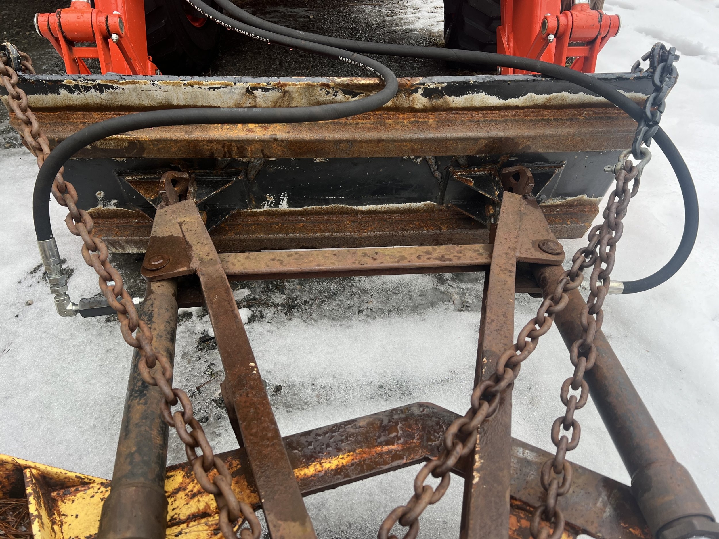

View attachment 849139View attachment 849140
I’ve had some issues with the hydraulics, I’ve had trouble with one piston working, I will be able to tilt it all the way to the left but then it won’t come back. Seems like maybe it was frozen because it would free up after a while but then I had the same issue when it was above freezing.
It looks like you have single acting hydraulics. You would have more power with double acting hydraulics. Although the pivot should compress the opposite side.
Good idea! That should work. And since I've only used the top holes, I could experiment with the lower ones and not mess the original mounting up.
