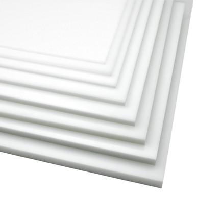

I neglected to add this to my comment yesterday;
I want to mention to you that installing slick sheet liner material in the impeller housing
and the chute will also aid in doubling or tripling your casting distance.
I am not familiar w slick sheet liner. What is it and where o you get?
/ Bercomac SSQA snowblower experiences #40
Slick sheet typically is UHMW Poly material 1/8" or 1/16" thick (depending on the clearance you have) to line the drum and chute. Attach with bolts at the ends and in the middle with flush mount screws or rivets.
