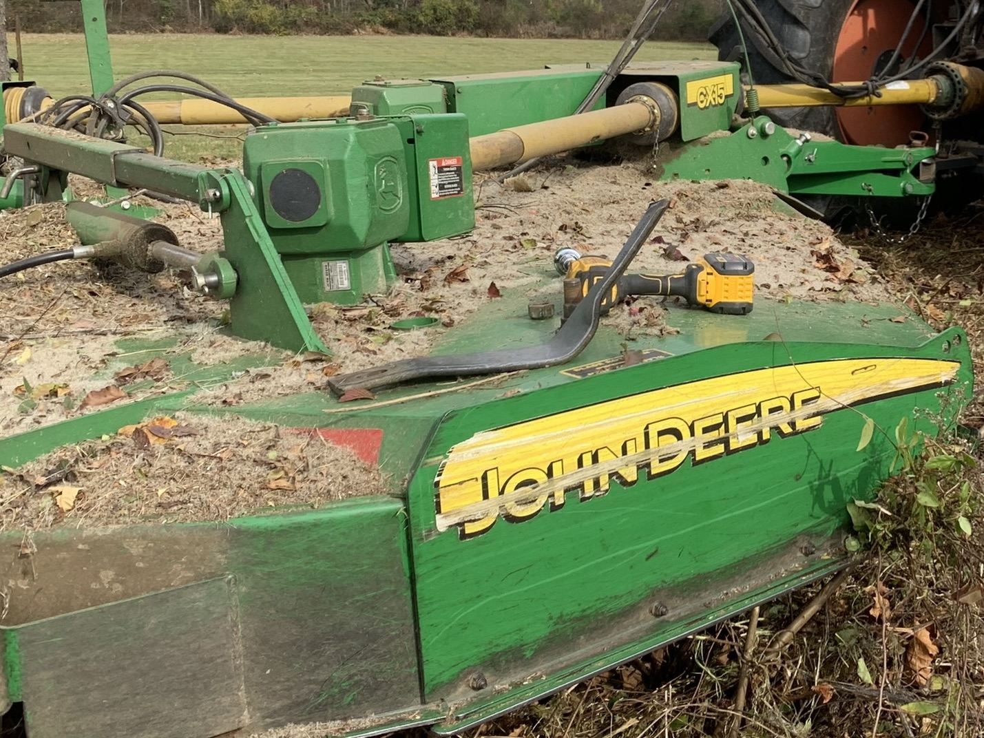

Rocks can certainly bend/break blades. Both times in recent years I bent or broke one, I did it while backing up.
Here’s a bent blade-real bent.
OMG, for a minute there I thought my wife borrowed your cutter!
A few years ago in one of my shop reorganizations I found all the blades my wife bent with the riding mower. I bet you I had around 15+ metal pretzels, I just got tired of straightening them out and just threw them under my bench for another day. You know you had a cheap blade when the mole holes took them out. We won't talk about the rocks, branch's, etc. she "didn't see". lol

Please advise the size of rock that caused this damage? As stated, my intent is to walk the ten acres, remove all big objects, the mow with my bucket as close to the ground as I can without digging in. However, this would still miss pretty big rocks (say the size of a softball). Wondering if that size will damage the blades or break/bend the mower housing.

It was about the size of a watermelon. Hidden perfectly in tall grass.
