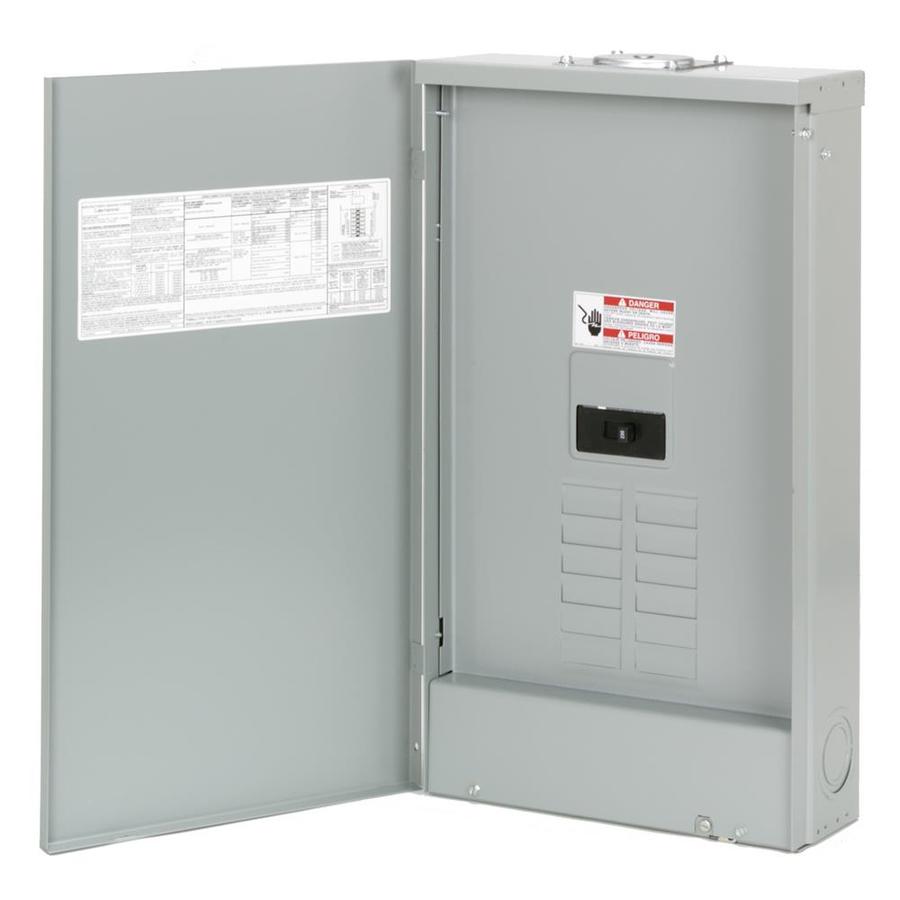

I am planning on putting a subpanel in the garage at some point to run power to a yet-to-be-built shop out back. The current garage is attached and is where the current breaker box sits. My main breaker however is mounted outside near the panel in one of these:
Eaton 2-Amp Enclosed 2-Pole Outdoor Circuit Breaker-ECCVH2R - The Home Depot
My question is...could a second one of these 200A outdoor main breaker boxes be added next to the first, or is there a 2-main breaker version of this box available? If either of those is OK, it would make running power to the shop much easier, as the subpanel in the garage could be fed from the outdoor main breaker box, not from the garage box.

Is your transformer sized for 400 amps?
Is your feed wire rated for 400 amps?
I would expect that neither is, so no you can't, it would need to be quite the shop to need a 200 amp feed.
If your shop is going to need that much it will be time for a separate feed or going to a 400 amp service $$$$$$$$

no you cannot just add a second one of those. each would be required to be fed from transformer with its own circuit. you could however change your existing 200 amp main breaker with this 200 amp panel with a feed thru 200 amp circuit and 8 space subpanel like this
in this case its an eaton panel, about 110 bucks at lowes
with this setup you can feed the 200 thru to house and then run a 100 amp to shop/garage without upgrading service to 400 amps

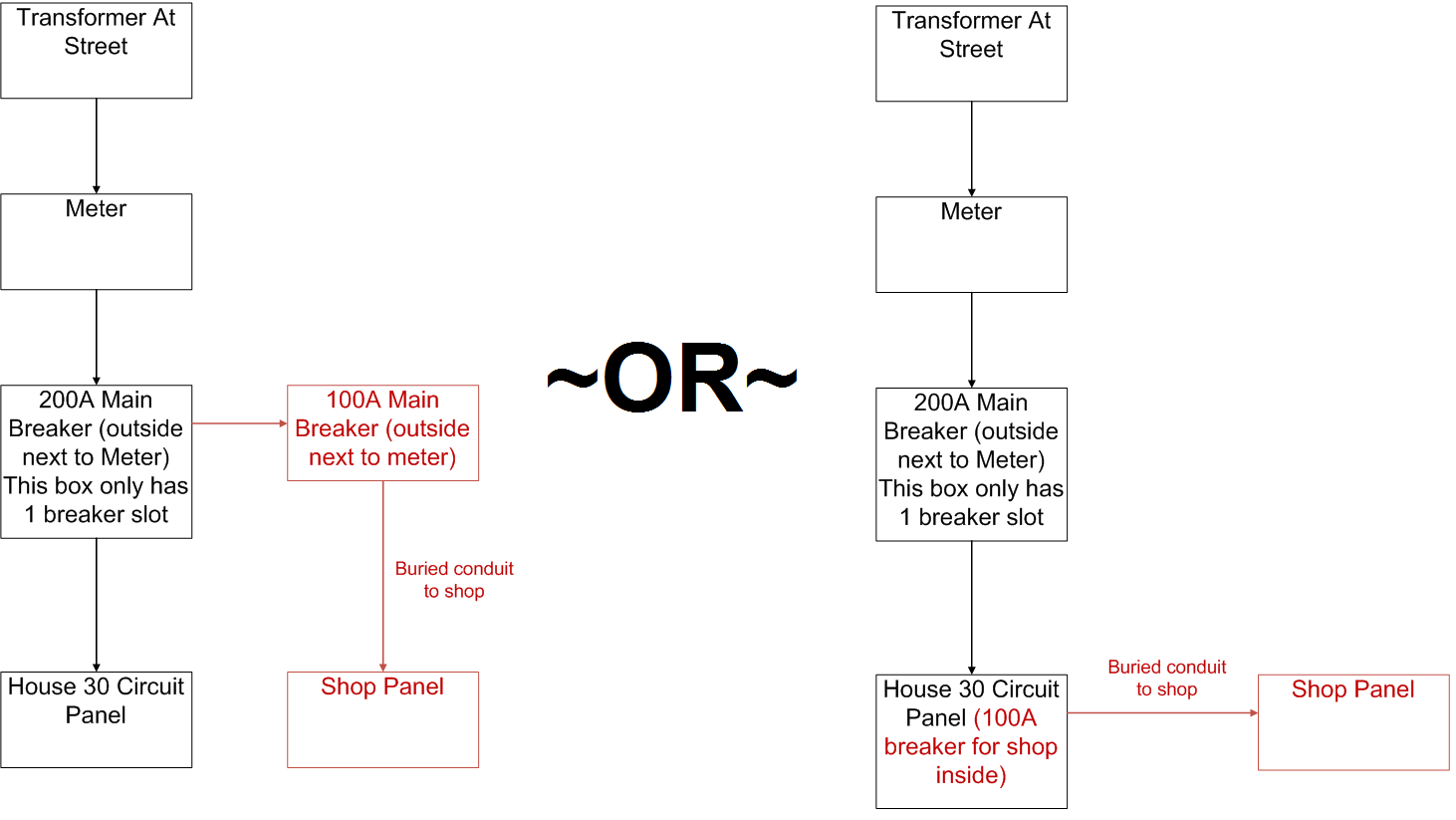

/ Outdoor Circuit Breaker Question
The existing panel in the garage? Or the existing Main Breaker box near the meter?
Here is a block diagram of what I have in black, and what I would like to add in red. I would like to do what is on the left, as it will be a much simpler install. This would require another box to be added on the outside of the house near the meter. I believe that this would need to be fed from the 200A main breaker I have already, as the service is sized to that breaker.
On the right was my original plan, but it will require running the wire to the shop to be longer and more convoluted(through garage ceiling and wall, etc).

Thanks! I was typing my last response as you responded...this makes sense and is what I figured. I was just wondering if there was an easier way for me.
-Joe

I’m a little confused by what you are trying to do. But if I’m seeing this right you have the 200a Eaton main breaker and that goes to the house and you also want power to the shop? I’m guessing the main breaker is somewhere in between the house and shop.
The easiest solution is to shut the 200a main breaker off, run wire to a little load center that has two breakers in it- one for the house and one for the shop. From there reattach power to the house on the new house breaker and then run your power to the shop via the second breaker. It will be a fairly straightforward fix/solution.
Btw- their is no breaker sizing restrictions with regards to the “down stream” panels. In other words your 200a main breaker can feed two breakers- say 200a to the house and 100a to the shop. No reason to oversized though- it just adds cost and difficulty.

LouNY nailed the solution. That is how I would do it. That is your right hand diagram solution. Less complicated also, no meter to pull to do the work. That way your shop circuits are downstream from the main breaker which has a higher fault current rating. Don't try to figure fault current out; it will drive you crazy unless you are an electrician. It is important though, but less so in residential services.

I’m not suggesting multiple wires under one lug- I appreciate the follow up to clarify.
So the OP has a 200a service and breaker somewhere in his yard between the house and new shop. I’m suggesting he add a second panel in the yard so he can then “split” the main/service. In the second panel he would have 2 breakers- a 200a going to the house and a 100a going to the shop. Even though the 2 breakers add up to more amps than the main breaker their is no code preventing this- in fact it’s common. I’m sure if you counted up the amps/breakers on your home’s panel this would be the case.
With my recommended solution he doesn’t have to pull the meter or involve the utility.
The comment about 200a breakers was just a word of caution. It’s worth researching because one setup vs another (even the same brand) could cost him hundreds of dollars and a lot of aggravation trying to find a 200a breaker.
One poster suggested a panel that may work- if it had lugs at the bottom of the panel to take the house it could be an economical choice.

ah..ok i get it now. same thing i was suggesting but with my idea he would replace the 200 amp breaker. your idea adds the new panel in between ...both would work. i personally always remove tho old one because since im pulling a electrical permit anyways, the utility pulls the power off for free, and re-energizes again for free. if theres room next to the existing 200 amp eaton switch, he can add an additional panel
