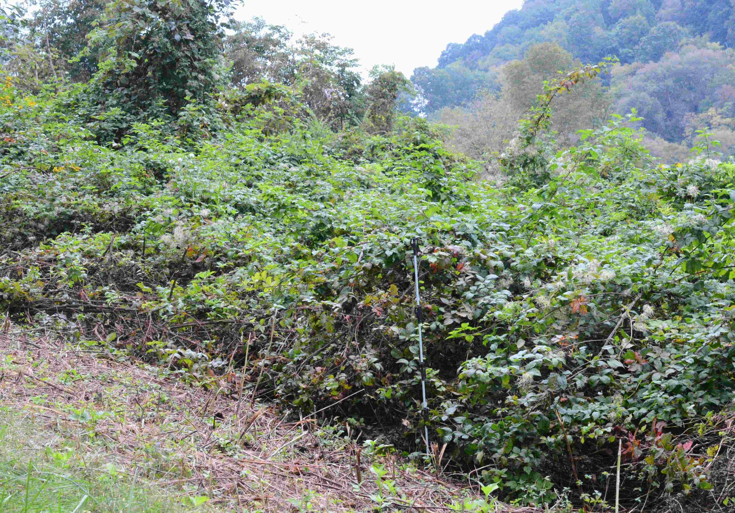

I have some hillside areas I'd like to mow. Currently own both a Gravely walkbehind with 30" rough cut mower and a Bachtold rough cut. Already own a Kubota L2501 and MX5200. Don't want to use either Kubota on the hillside.
I tend not to use the Gravely because of the weight.
The Bachtold starts easily and does a good job of cutting material off at the base, but doesn't grind it up because it has an open deck that isn't enclosed on the sides. It's exhausting to push the handbars to lift it up over material, drop it down, and then pull it back by hand to cut up the material. It has a single forward speed and no power reverse. So what tends to happen is cut briars pile up at my feet and then I have to pull it back to chop them up. I use it as a last resort and never look forward to using it. Plus it has thrown a few rocks at my shins even though the rubber flap is in place that is supposed to stop that from happening.
I've been wondering if a flail mower would do an easier job of chopping up 6' tall briars and honeysuckle. The nearest BCS/Grillo dealer says he has a Grillo 110 with less than 100 hours that he could sell me with a 28" Bittante flail mower for about $5400. The list price of a new one with the flail would be around $6,300.
Then I noticed Orec America has a 25" flail driven by tracks. The nearest dealer didn't give me an exact quote other than to say it would be about $6,000 plus $300 shipping. The dealer has one to rent for $180/day so I could at least test one before buying. Both the Grillo and Orec have Honda engines, but the Orec is 8.4 hp vs 13hp on the Grillo.
I tend to think the tracks would do a better job of being able to push the flail into/over brush, but there is a substantial difference in HP between the Orec and the Grillo. The Orec advertises .6 mph in lowest gear vs .8 mph for the Grillo. I could see the slower speed as being better for allowing the flail time to chop up brush.
I don't care about other implements. This would be for brush cutting only.
Another option is there is a Steiner 410 with a 5' finish mower with 550 hours on the tractor and a new Honda engine listed for $8500. It does not have the two speed gear range of later Steiners and a finish mower would not be the best option for cutting brush. However, it would be nice to ride instead of walk if the Steiner could do the job. I don't think I have the option of testing it on my property before buying. The dealer does not have a brush cutter in stock to fit this model.
Final option would be a Power Trac PT 425 with a 48" brush cutter. The price is $17,750 plus shipping. I hate to spend this much just to mow a hillside.
Mulling this over. Would appreciate any thoughts to help think this through.

So what's your estimate of whether a flail will be able to cut this overgrown briar patch in a single pass?
A 2-wheel tractor with a flail mower will absolutely annihilate that briar patch. It's the correct tool for the job, no need to keep deliberating about it. If you don't want to buy one, I agree that renting or hiring someone for a day make a lot of sense, especially if you just want a once-and-done approach. Buying a 2-wheel tractor on the other hand is an investment - yes it's expensive, but it's a versatile machine that will last you many years. If your only goal is to clear this patch, buying brand new probably doesn't make sense. Used packages do come up often enough and Earth Tools has a bulletin board and lots of good deals.

To be able to be mowing in precarious terrain like you have pictured you will have a lot of obstacles which will be a a lot of stop and go. This is where the 779 will far excel over the gear drive.

2Many, I spent years clearing the type of stuff you pictured with a 2 wheel Gravely...... but I was around 16 years old. 30" mower and a dual wheel setup, my approach was handles down raising the mower for about 4' into the jungle, then drop the mower and back out. I'd repeat to either side. I was usually in a immature woods and mowing lawn style in long rows wasn't a good option.
Looking at your pics, working uphill would aid a little in the effort to raise the mower for the initial pass. I got a very nice "finish" this way.
You have the gravely aalready and probably have tried every approach, and this also was 40+ years ago and I was just a dumb kid full of piss and vinegar. Somehow I remember that work (and results) fondly and still have a warm place in my heart for those stubborn, heavy, cumbersome but solid as a rock machines.
I thought I'd mention my technique just incase you hadn't tried it. Dual wheels is a nice option for a Gravely walk behind.
