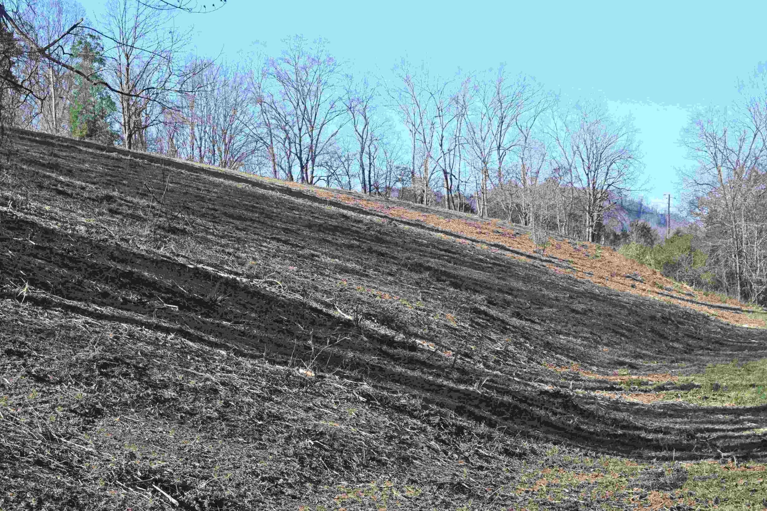

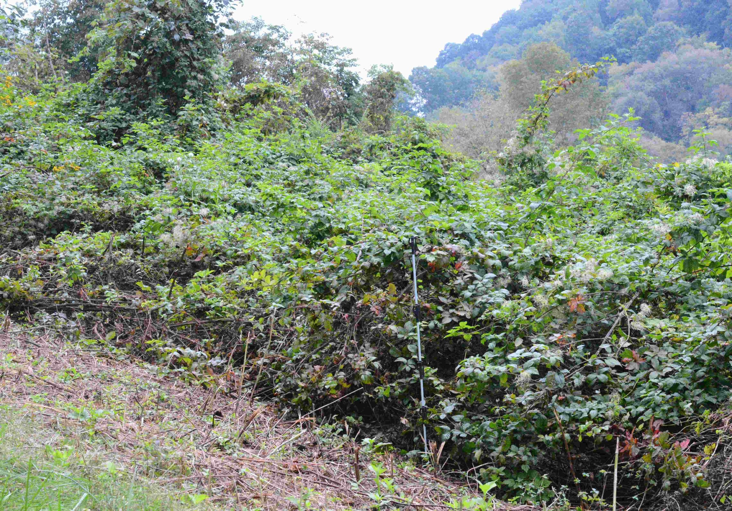

The Grillo dealer seems pretty confident that the Grillo/flail will cut this briar patch, but said it will be slow. Haven't heard from the Orec rep, but I suspect they'll say the same thing.
Trouble is, I know from experience that cutting brush with a walk behind on a hillside is a hard physical task. That's really why I'm interested in finding some kind of ride on brush cutter that will work on this slope.
Although I hate to spend an additional $18k for a PT on top of what I already spent on Kubotas, I'm having trouble thinking of a less expensive alternative.

I"m not sure if I should be getting a flail mower instead of a rotary brush mower. Is a flail mower really going to do a better job of mowing 4-6' tall briar patches in terms of being able to cut into the pile and then cutting its way through it instead of having to nibble away at it?
