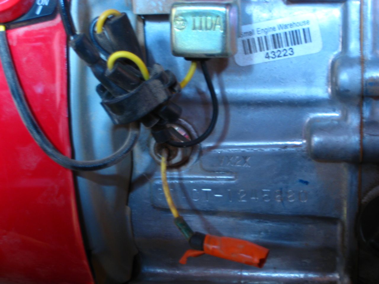

i read several post about making this change, thats why i decided to do it: didn't read any "issues" other than some had to disconnect the low oil sensor..hope i didn't miss something.

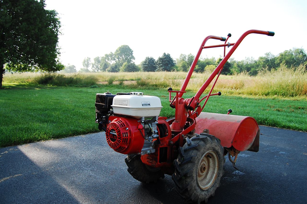

I replaced mine with the Honda version , i believe the HF is the clone of this motor . Install is very simple and I did have to disconnect the low oil switch .
I enclosed a photo of the low oil switch wire disconnected ( with the orange electrical tape ) I imagined it's about the same on the HF version .

have to admit, that honda engine looks good sittin on that tiller....an i bet it works great too. i am replacing a 8 hp kohler that has very low usage, but is hard to pull, an hard to start.

It does work well . I had a 6 horse tecumseh on mine that I tinker with for to long . i ordered the Honda from small engine warehouse , I think it was about $300.00 with free shipping last year .
I have found the new motor a lot quieter and has plenty of power . Best of luck in your motor swap :thumbsup:
