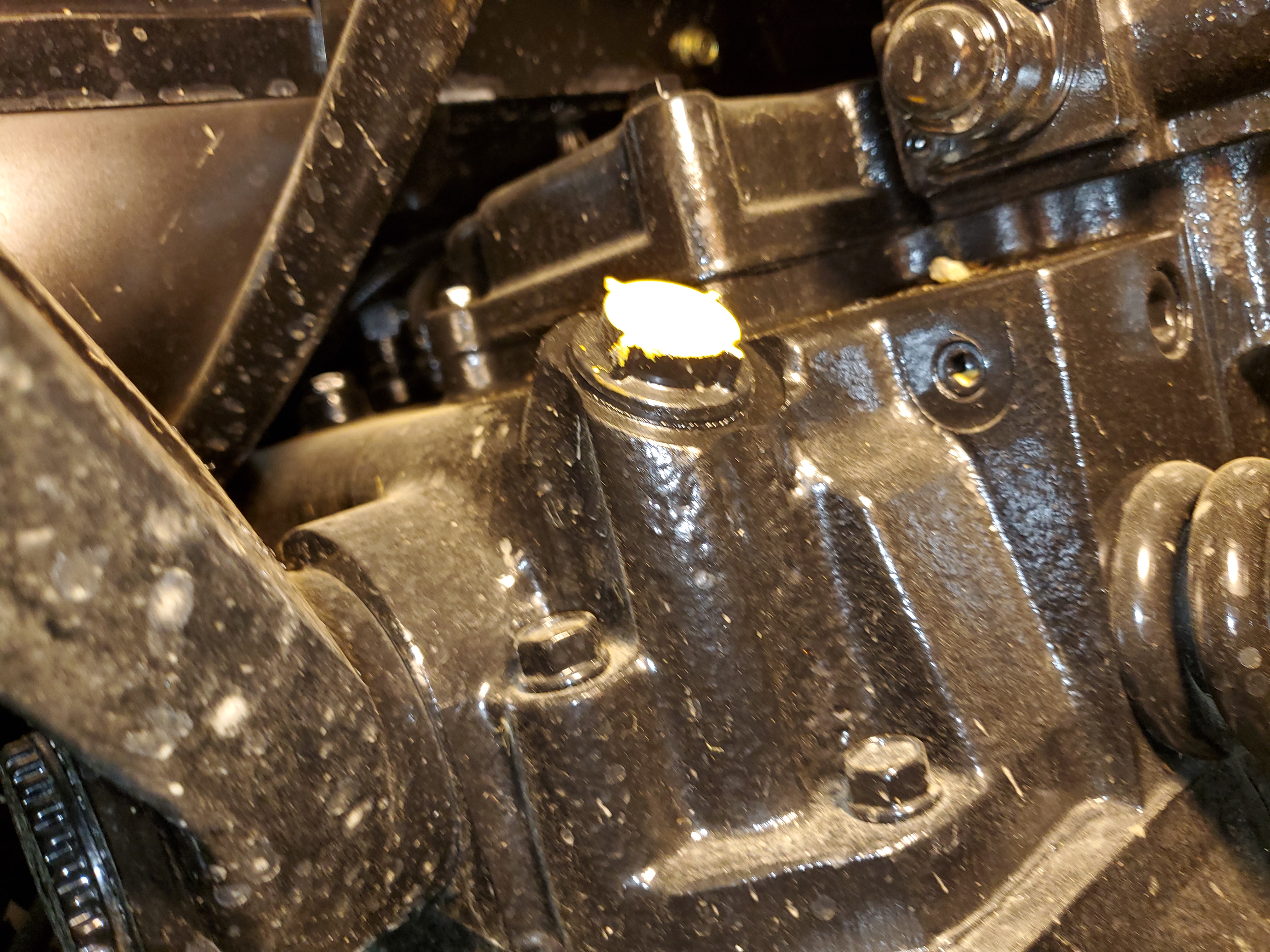

Looking for a little guidance - Is there a special tool or method to remove the hydraulic fluid filler plug at the rear of the tractor. Thought I would ask before tearing into it and breaking something. I have never seen anything with that type of head before.
