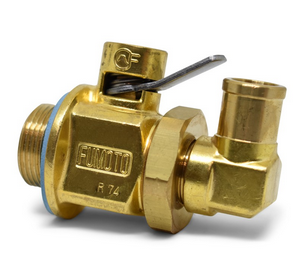

May I STRONGLY recommend that you get a Fumoto Valve to replace your oil drain plug. They thread in place of the plug, provide an easy to operate, but locking ball valve actuator and are available in straight or 90-degree options. I have them on 2 of my vehicles for easy and clean oil changes and you can drain the oil while warm to hot because you never touch it. In your case, you would get a 90-degree option with a nipple so that you can slide on a length of hose and drain that oil into a pan with ZERO MESS.
View attachment 627746 Buy Fumoto(R) Valve Online | Replace Oil Drain Plug
Once you find the model you need, you can order from Amazon. And since it would be located ABOVE the backhoe subframe, it is perfectly well protected from being impacted or damaged.
Do you by chance know the model # for the 90 degree oil plug that fits the RK55?
