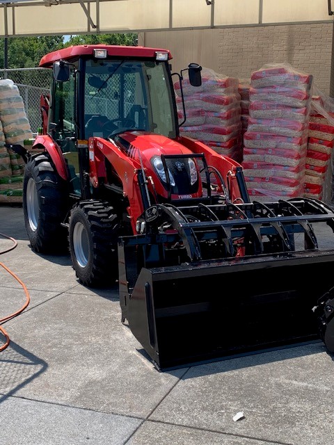

This is a long post and took me about a week to do the service, take pictures, communicate with RK, and edit. Please let me know if anything should be corrected. With my comments below, I am assuming the person doing their own service has a level of comfort and familiarity with fluid changes on a car, lawn mower, or other internal combustion engine. In addition, this is my own experience - RK is the ultimate authority on how their tractors should be serviced which is why YOU SHOULD READ THE MANUALS: https://www.rktractors.com/manuals/Operator Manuals/RK55 Hydrostatic Open Station & Cab Tractor.pdf https://www.rktractors.com/manuals/Loader Manuals/L110 Loader Operator Manual for RK55 Tractors.pdf https://www.rktractors.com/manuals/...Backhoe Operator Manual for RK55 Tractors.pdf In addition, the parts manual was very helpful in determining TYM part numbers, locations, and names https://www.rktractors.com/pdf/parts/RK55S RK55SC.pdf. It's a good practice to download all of these PDFs and keep them on your computer (you can print out the disposable pages you need and not worry about getting your hard-copy manuals messed up with oil and grease.) In other words, don't blame me if you do what I did and it's wrong!
My cab tractor has L110 loader, BH85 backhoe, optional 3rd remote, and 3rd function control.
Before servicing my tractor, I removed both the loader and backhoe to improve access, then ran it to operating temperature to warm up the fluids, lowered the grill guard, opened the hood, and removed the engine side panels.

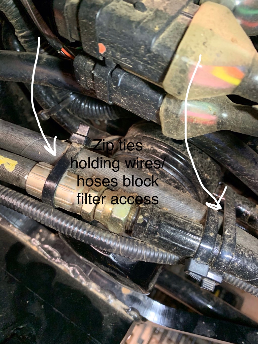

Engine Oil - fluid and filter changed. The magnetic drain plug had no signs of metal. If you have ever changed oil before, the procedure was normal with the following exceptions:
*The factory used two heavy-duty zip ties to hold two hydraulic lines and a wire to the engine oil filter housing's pipes. They had to be cut to get the spin-on filter off and on. In addition, the filter was WAY overtightened and painted at the factory after it was installed. Needed large sliding jaw pliers to remove after scoring paint at filter base. Filter was destroyed during removal.
*The owner's manual diagram (page 5-9) leads you to believe that there are two oil drain plugs - there is only one. It was painted over by the factory, but it came off easily since it had a washer. The backhoe subframe's front mounting plate covers the oil drain plug leaving a gap of about two inches between the plug's bottom and the plate's top. The mounting plate has two very large holes, but they do not line up with the drain plug offset by nearly two inches. If you tried to drain oil as it exists, you will have oil everywhere.
I used an upside-down lid from a 5-gallon bucket to divert the oil into the catch bucket (still messy, not as bad as it could have been), but for future engine oil changes, I purchased a funnel tray/sorting tray SKU37081 from Harbor Freight for $3.49 which should do the trick for catching and diverting the oil.

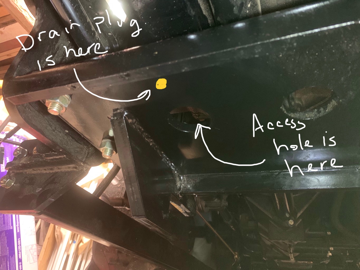

Transmission fluid - fluid and two filters changed. The single magnetic drain plug was painted over but was removed fairly easily. The magnet captured a few small "pencil shavings" on it that resembled manufacturing debris. Like the engine oil, the procedure was normal with the following exceptions:
*HUGE *HUGE* TYPO IN THE OWNER'S MANUAL LUBE CHART on page 5-10: do NOT use API GL-4 80W gear oil in the transmission case! Use the hydraulic fluid here https://www.rktractors.com/pdf/brochures/maintenanceproducts.pdf.
*Both filters were WAY overtightened and destroyed when removing. Unlike the smaller HST filter, the large hydraulic oil filter was installed then painted over at the factory making removal especially difficult. I scored the paint at the filter base and used the large sliding jaw pliers combined with a strap wrench to get it started.
I almost gave up and had prepared my drill in order to cross-drill a hole in the filter and put a bar through it before trying one last time.

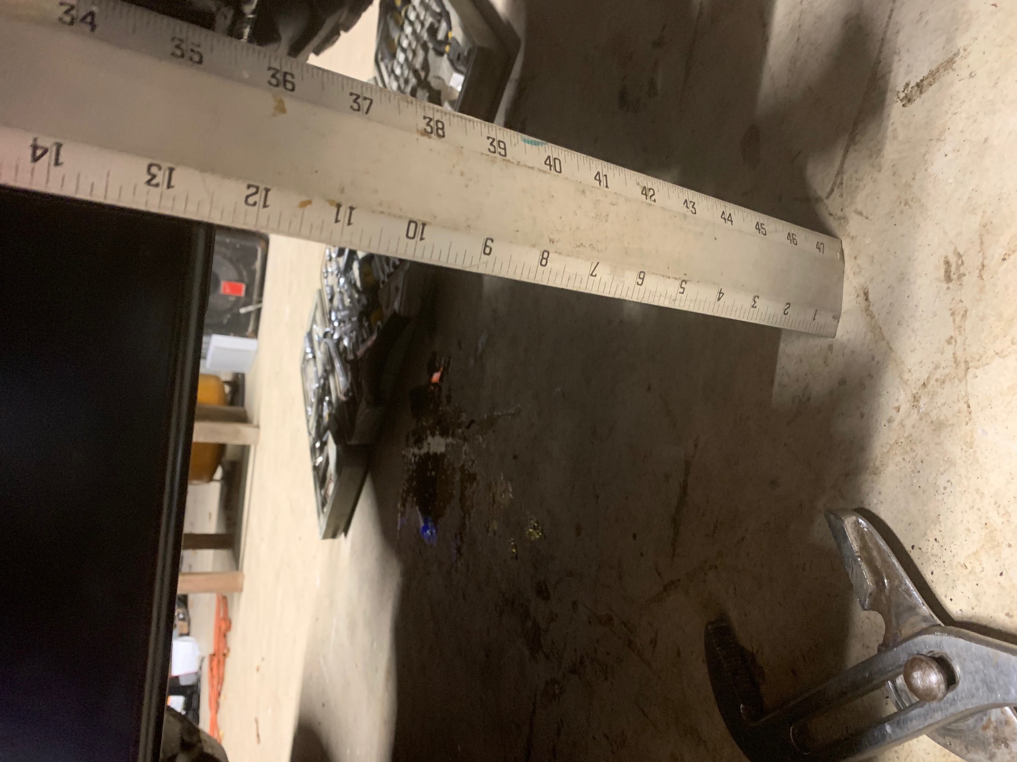

*Almost 10 gallons of fluid drained out. A 5-gallon bucket fits perfectly under the drain plug, BUT the subframes will not allow you to get it out without tipping it over; whatever catch basin you use, it has to be shorter than 12.5 inches. In addition, most containers are less than 10 gallons, so be prepared to temporarily reinstall the drain plug to change containers. The magnet is very strong and wants to stick to the transmission housing.
