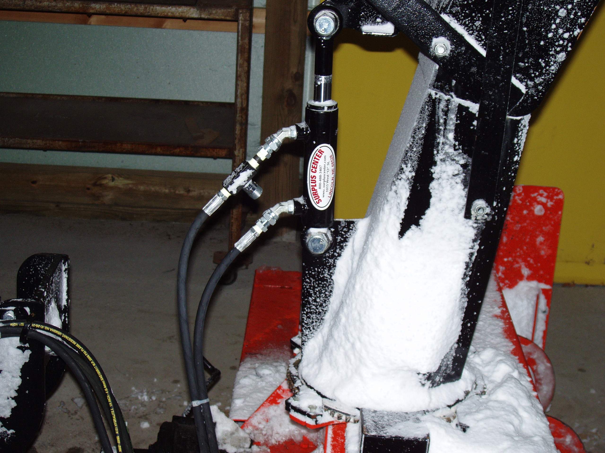

I'm also thinking about picking one of these up if they can offer me 100year 0% interest financing

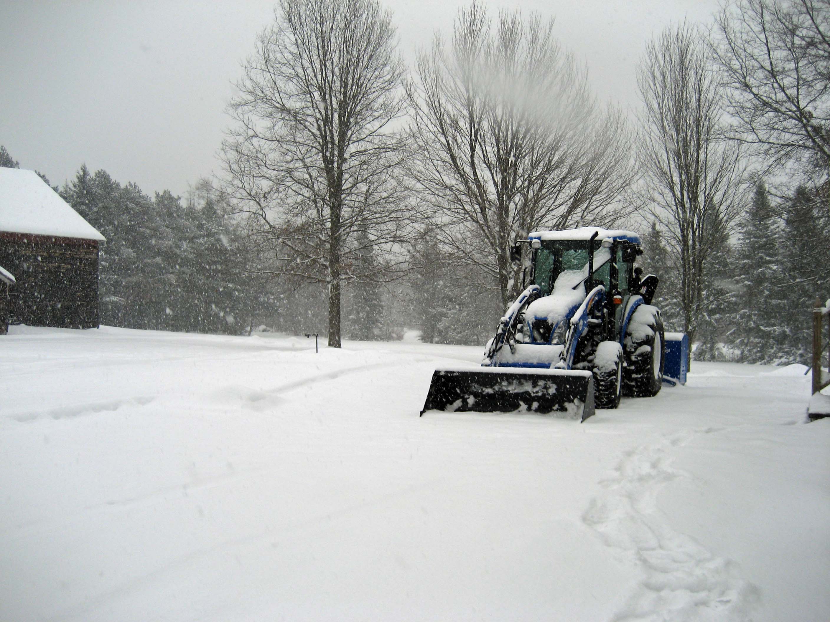

As I'm sitting here reading this outside my window snow is flying a little clipper that was supposed to just pass through has just dropped close to 6 inches of snow and is showing no signs of stopping I'll be snow blowing again today :). I lived in the country upstate New York my entire life so I'm used to snow. Your tractor in my opinion is fine you just need a snowblower front or rear that's your choice a rear snowblower will save you money it will take some getting used to backing up but it can be done, a set of chains, some kind of cab it will help keep you warm. Now if you still find that your tractor is overwhelmed talk to your dealer and tell him you need a larger unit, you wouldn't believe how may people have traded up including myself dealers love to make money on us ;-). One other quick note where I live now, my parents old house my father maintained the 1500 feet driveway and large back barn area for 20 years with a 432 gravelly basically a small lawnmower with a 40 inch front snowblower so it can be done the question is do you want to suffer or enjoy the winter its up to you personally I don't mind sacrificing money for the right things and be able to get out of my driveway and to work in the morning is pretty important, especially being so isolated from help and from where you're living I would think you would need it to it's one of those things you don't skimp on like the backup generator and large truck F350 4x4 take care PS a little picture of what it looks like today LOL that yard was clean
