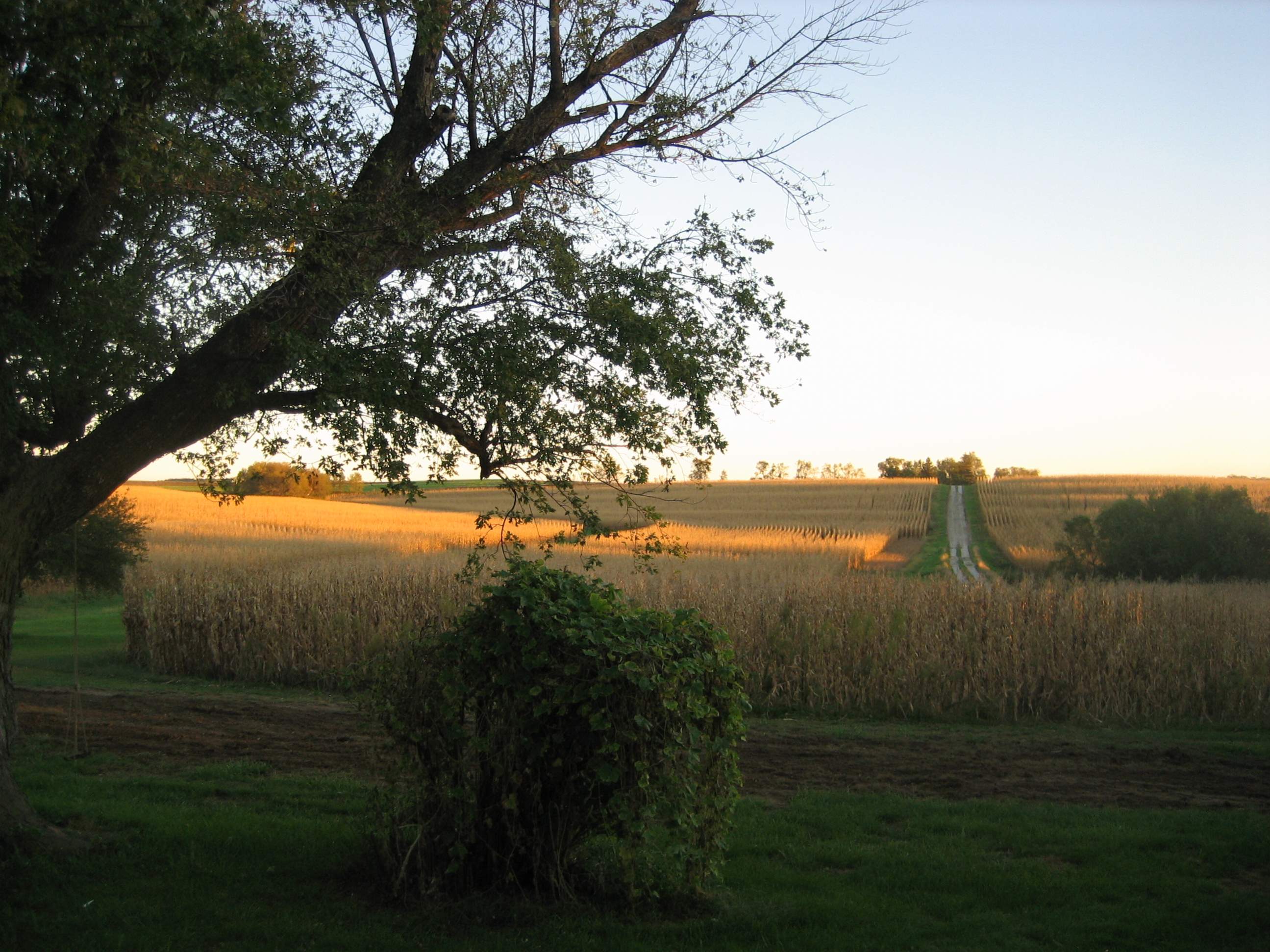

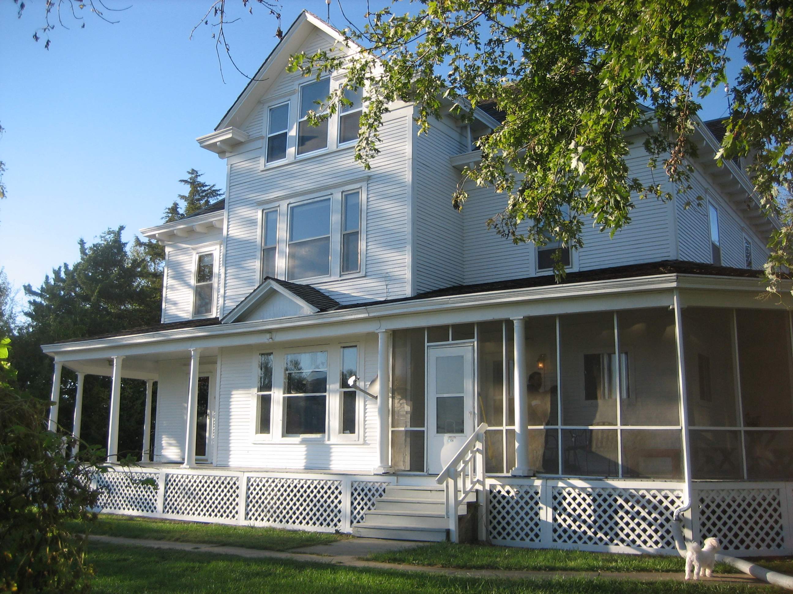

THANKS EVERYONE. And thanks for the nice comments about the house. If you are ever in Murdock, NE stop by (not in the winter unless you bring your tractor:laughing:)
Seems like we learn something new everyday since we moved to the country. We were cleaning out one of the outbuildings in the summer when we first moved in and we found rolls and rolls of old wooden snow fence. I shrugged it off and said "they must have hard winters back then". Well "they" now "us" still have hard winters it seems. Next year we will be putting up fencing as soon as the corn comes down.
This is what the place looks like minus the snow. Thank you again for all the advice.

Beautiful old farmhouse. Reminds me of my grandparent's place in central Wisconsin.

I just scanned the thread and didn't see any one recommended snow fence.
That would be my first line of defense for a wind swept area.
even a couple in a line if its always bad.
With the rear blade you have to have a place for the waste to go!
If you don't still have the snow fence, the orange plastic stuff works fine, and is a lot less work to haul around, and store.
Note where the bad areas are for next year. Set the fence about 50' back from the drive. Put the fence on the windward side of the posts, 10' on center, or less. Really bad areas may require two rows of fence, aprox. 30' apart.
Once you get it figured out, you may only have to plow occasionally. Even when you do get lots of snow, the wind will do a good job of blowing it away, instead of blowing it in.

For the lowest expense/effective ratio a front blower with your existing tractor and a snow fence to mitigate the drifting in the area depicted would work well, would easily cut the time to clear in half (I just finished a little more than half mile lane with a GC2600 and front blower albeit less snow 8 inches in 1.5 hours with a lot of jiggin around in a few places including my own good size car park area) and might actually turn that work into good fun.
