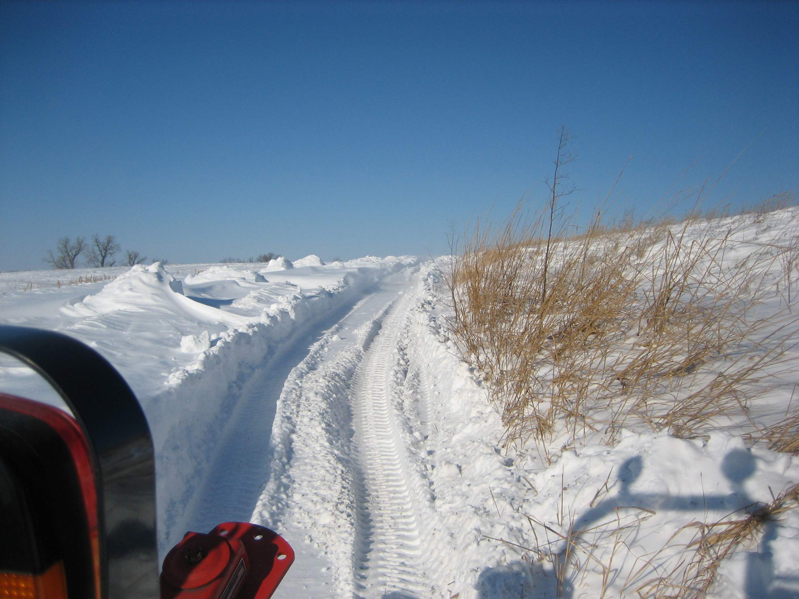

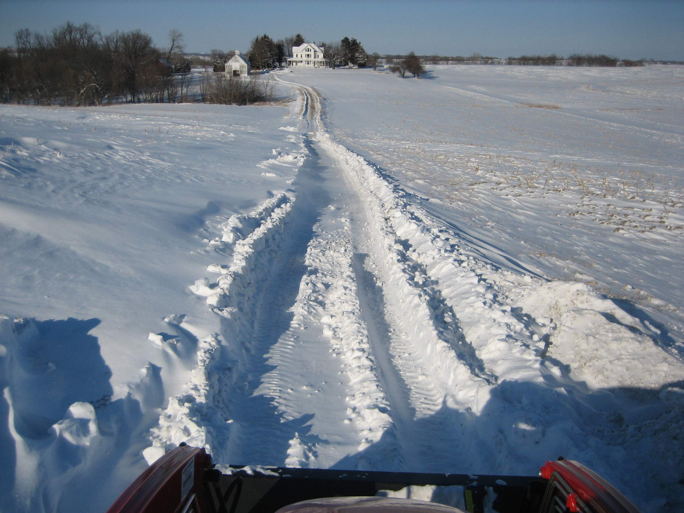

Had my first real snow and I failed to get out of my 1/4 mile lane. We had about 8 inches come down, I cleared that ok..then the wind came in. Overnight some parts of my lane piled up to 20-25 inches. I worked at it for about 4 hours and by time i got one spot clear the wind would cover it back up in a few hours. I had a hard time getting up my hill to try blading on the way down. After the wind died down I went back out and had a heck of a time. In the end I was bailed out by my neighbor with his Deere 8300 and massive rear bucket. It was very emasculating. Sitting there on my GC I felt like I just walked out of an NFL locker room shower.
I have a Massey GC2400 with an FEL and 4ft rear blade. The Blade would load up with snow and stop the tractor, the FEL was ok but I had nowhere to pivot and dump. I admit it, I am a city boy who just moved to the country and i have no idea what i am doing but I am willing to learn.
What am i doing wrong? Any advice would be greatly appreciated. Should I switch to a blower set up? Should I get a bigger tractor? Should I bribe my Neighbor with my excellent cooking?

you might have better luck with a snow blower.That way you can shoot it with the wind
/ Not enough tractor or bad strategy? #3
Tire chains give you the traction needed to handle deep snow with a back blade. Also try running with the blade at an angle so that the snow does not pile up in front of it.
If your neighbor has a pickup with a plow on the front, that is the best option. Bribery almost always works!

To be really, really honest, a subcut, armed with a 4' rear blade and a loader isn't much of a match against snow drifts, in open country like that. I can see from your one photo that you did indeed have your blade tilted to the max?
You DO need to blade very wide upon cleaning a drive. A blade wider, on either side, more than your normal "two track" drive width. Gotta strategize that you'll need to make it really wide, while you still can, early on.
You said you had it all cleaned, but overnight the wind drifted it back in?
Unless you were willing to go out every 3 hours during the night and re-clean in 3"-5" bits, there wasn't much hope. Yup, that was too much for your tractor.
Nebraska means winds and drifting. Go Big Red!! :)

Listen you received some good advice here now I'm going to tell you what you need to do. You have two options, one buy either a front or a rear pto snowblower,they will take care of almost all drifts. But as others have said front snowblower is $$$,Rear blower will work just fine but you need to be half turned in seat to see where your blowing snow.Second option would be a larger tractor, but even whith a large tractor and fel or plow you have banks of snow. That could work for you if you bank on the prevailing wind side, it would act like a snow fence. Hope this helps youj decide?

No, you don't need a bigger tractor. Get a 3PH snowblower. Mine really clears the snow, was chugging through 24 inches of 'reblown' snow today. Second season, and I remain impressed with the Puma. Reblown snow is what you get when you don't have room to toss it right here, so you blow it in front of you until you get past the side of the house. One foot quickly piles up to two or more.
The small tractor fits into places a bigger one couldn't go. I must say, the cab and heater make it almost too nice. And the electric twist-n-tilt spout are working great!
Yeah, blowing backward is not ideal, but I can spin around and dig with the bucket when I need to. Still my first choice in setups.

Just looking at your pictures (great looking place, by the way), you made your initial windrows on the upwind side just before the wind started and that set up the opportunity for drifting. Having seen where it drifts, try to remove snow the next time so your windrows and piles are on the prevailing downwind side and as far from the lane as possible. That may involve a lot of jockeying around with a small tractor and a blade. A snowblower is somewhat better because it can throw the snow away from your lane and you can aim it downwind and well out of the way. A 4x4 plow truck would be much quicker, but no matter what kind of equipment you have, leaving snow piles upwind of the road is an invitation for drifting. Snowfencing upwind of the places prone to drifting would also help.

I have basically the same tractor, with a front 6' plow blade mounted on the FEL arms, no chains, turf tires, 320' of gravel drive, that occasionally gets massive drifts, and I have no problem plowing it. It is however, pretty much flat land.
It defiantly looks like you could have really benefited from some properly installed, and placed, snow fence.
