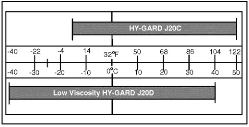

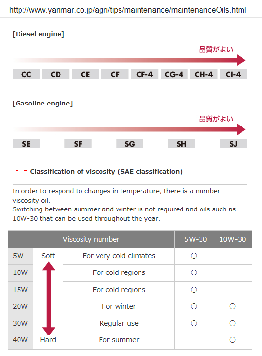

Per Yanmar
Your YM2500 painted JD green would be a john Deere 850. So, the same oil info is listed here
Hydraulic fluid is Yanmar TF500A, hard to locate around the county, yet John Deere J20C and brands that are 'equivalent' would work, not compatible.

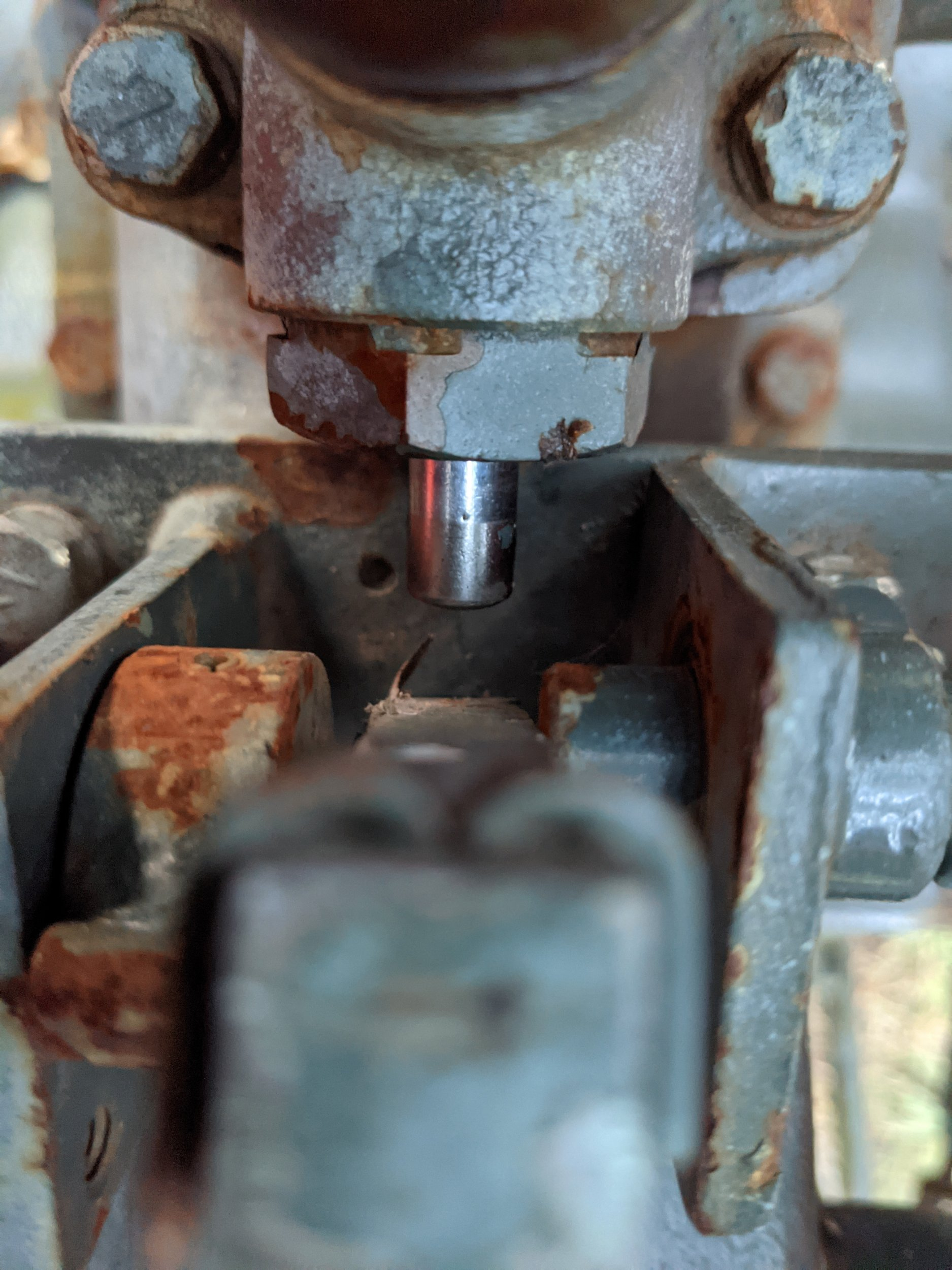

Ok, thank you for that Winston1 i will take a look and see what I can find out. So another thing I noticed is that the 3point went up but it's not wanting to go back down. I made sure that the lock was turned fully counter clock wise. Does it matter the rpms or should it go down if the tractor is off? Also should the pin fully extend and touch the lever? (See attached photo).
Sorry for the basic questions as this is my first tractor.
Hmmm, where is that little shiny lock pin located? It might be on my machine too. I just never paid any attention.
I know about the under seat tiny lever like this spot. Mine has to sit in that position, else it will not go up or down, depending what way it's flipped.
And there their is the HARD LOCK stop to the 3PT found here

Hi bmaverick so in the first picture you have it's under that metal shield you have. I guess mine did not come with it. Follow the spring. I will try moving the two levers as i was playing with them but could not find any documentation on them. So I was able to put it at 2200 rpms and drive around a bit. I will post an audio clip as how the motor sounds and you can tell me if it's normal.. Also i noticed the front loader stutters a bit during operation and the pump or something makes what sounds like a whining noise.

So I decided tonight to drain the hydraulic fluid and the milk shake did make me sad.. So apparently there is water in the system that i will now have to get out. I did read on some post to put diesel, ATF F, and alcohol into the case and run the tractor but not run the pto etc and I've also read to just use diesel and run all pto, lifts etc. Anyone have the best way of removing the water and starting over?
NO, please no alcohol in the system. ATF+4 is the go to on these Yanmar/John Deere compacts. And the newer 'clean' diesel works nicely now as it's low sulfur.
J20C is the mainstay Hy-Gard fluid to use. IF you live in higher elevations or harsh winters J20D is the formula to use.
Bummer about the milky white fluid. It would take 2 or 3 rinses to purge. Possibly more. Thus the 'clean' diesel of today is the most cost effect method.
Your YM2500 should be identical to flush and refill. See my posting here
