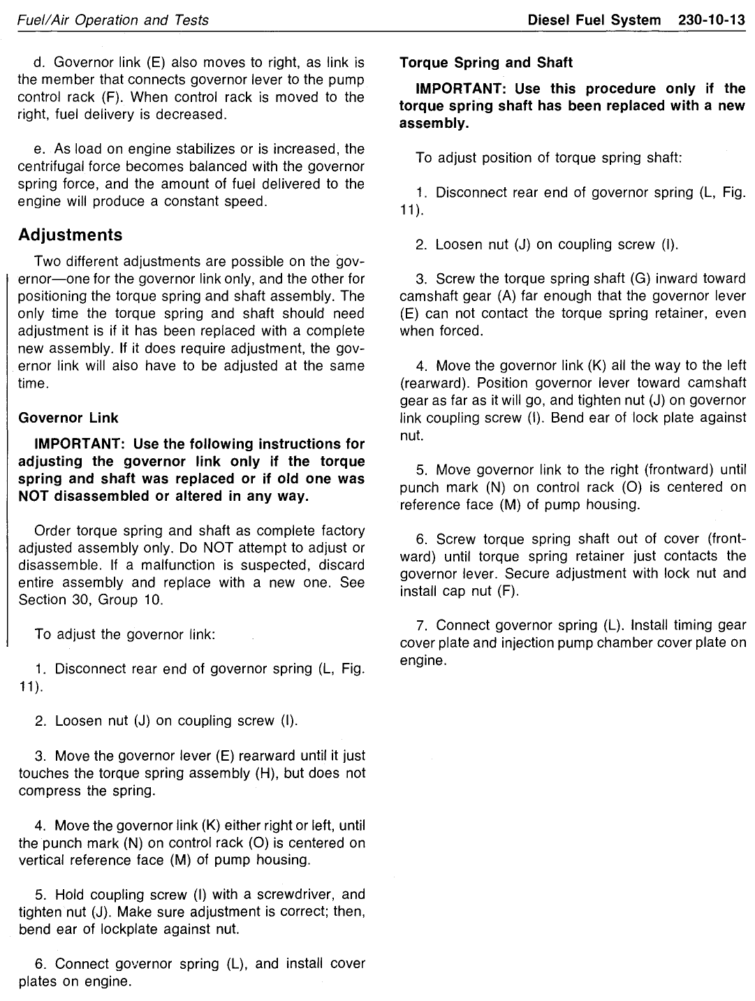

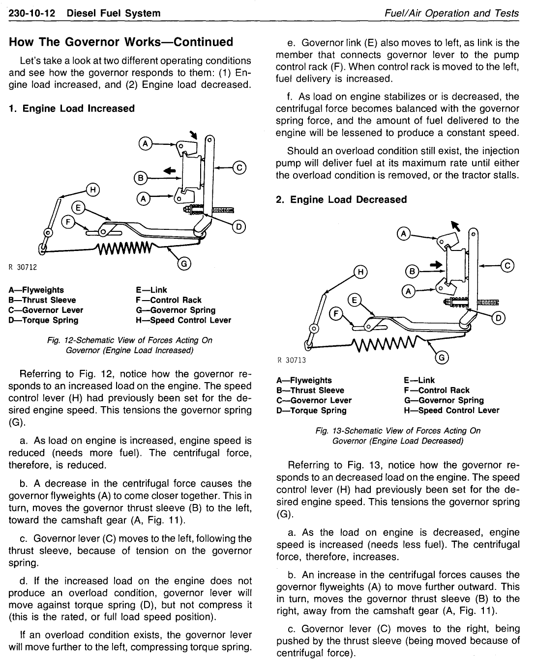

So this morning I closed every thing up put the filter in etc after letting it drain all night. put fluid in and started it up. So now the 3point works, and the loader with no noises and working smooth. I am going to post a video with it running shortly and hopefully it sounds normal for a 3cyl. :) the next thing to sort out is throttle control because if I press the accelerator it is sluggish to respond and when I let it go the idle drops down and will shut off the tractor if I don't press it back in full throttle. I've never owned a tractor and this might be normal. I did check the linkage and it looked all intact.

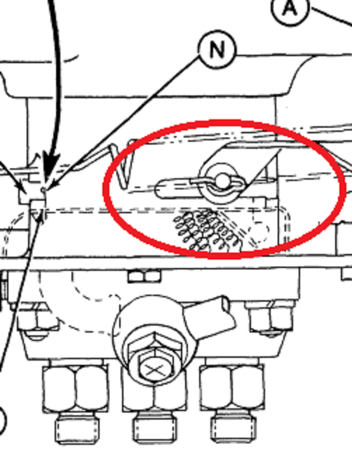

Per Winston's posted diagram, friction washers or a spring keeps the throttle lever from slipping back below idle. Mine slips from 1400rpms to just the idle detent. I know, I got to check mine out too. BUT, mine doesn't slipp past the detent to turn off. Thus, you have 2 issues to contend with.

So I had a bit of time to go out and see if i could get the idle sorted. But can't find the reason. If i drive the tractor around it runs fine but there is not pedal response and or you will hear it surge then drop in rpms. I took a video of me pressing the accelerator and then you can hear it fumble. I then save it by pulling the lever. I then slowly move the lever forward to try and get to a lower idle but you can hear it lower and surge till it eventually dies when the rps are around 1200. My next step is to put a clear hose and make sure there are no bubbles in the lines etc but i find it hard to believe as it runs awesome when at 2200 rpms or pto speed.
