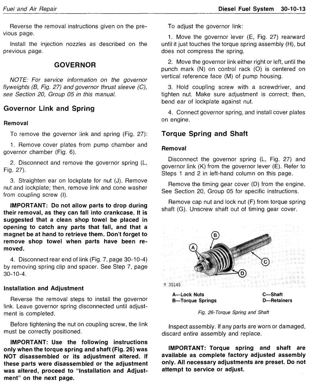

long time no update.

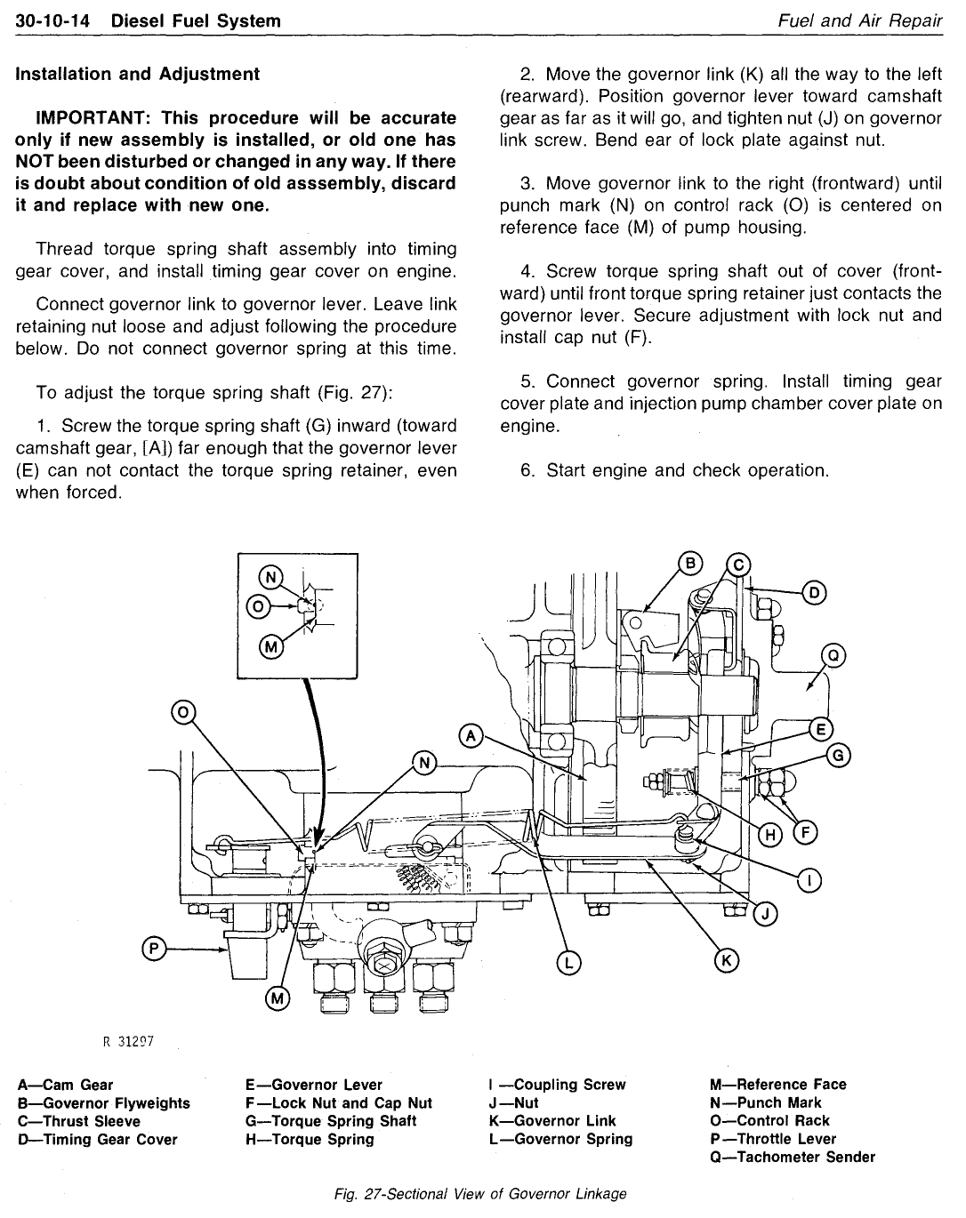

so I took the governor linkage cover off to inspect and it was LOOSE!!! :-/ but it could have been worse if the little nut fell into the motor so I am thankful to have caught it. Ok so looking at the repair manual it says there is supposed to be a mark on the sliding rail of the fuel pump but I am not able to find the punch mark on the slide so not sure what to do. any advise would be appreciated.

Snap a pix of the gov linkage cover. If it has no-gasket, I can take mine off too, measure from where my machine is set to on the sliding rail. This way, you can set your at the same distance and all should be good then. :)

So what page in the repair manual? I looked at Section 50 Group 20, and couldn't see it there. I'm still flipping PDF pages.
OK, Section 30 Group 10.13
