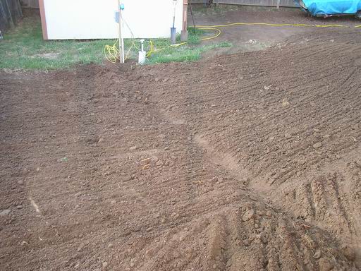

Attached is a pic of my backyard, following removal of a pool.

Attached is a pic of the ground worked up. I built a harrow type tool to create the effect. In addition, I tilled it twice a week apart prior to this.
Enjoy.

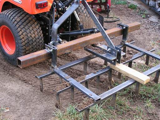

Here's the harrow I built.
