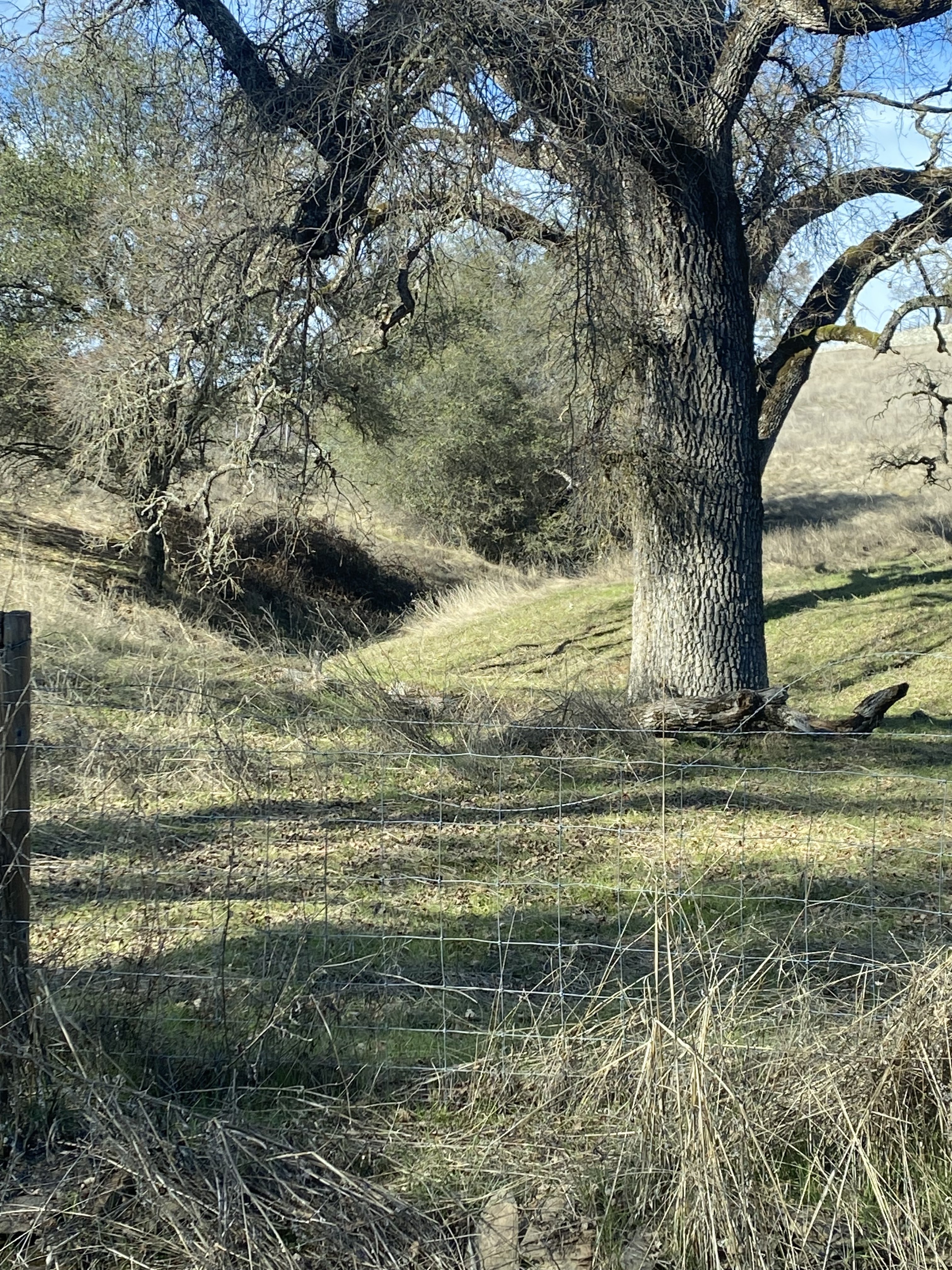

I recently purchased a LS MT242HE for our 20 acre property, along with a rotary mower and box scraper. This is the first tractor I’ve owned, but on our prior much larger property we owned a CTL for clearing, trail work, various projects. This property is more mowing ect so it seemed like a needed downsize.
We have an area on the property that is a small gulley with decent sloped hills on three sides. I’ve been thinking about hiring out a dozer to put in a small levee to create a livestock pond. It would probably be 50-100 cubic yards of dirt moved and then some grading. The few guys that I talked to wanted to bring in a D5 dozer and knock it put in a day or two, but charge around 20k.
Does this seem like something that could be down with my tractor and a box scraper? I don’t mind spending some time on it, but I also don’t want to end up tearing up the gully only to realize it’s out of scope.

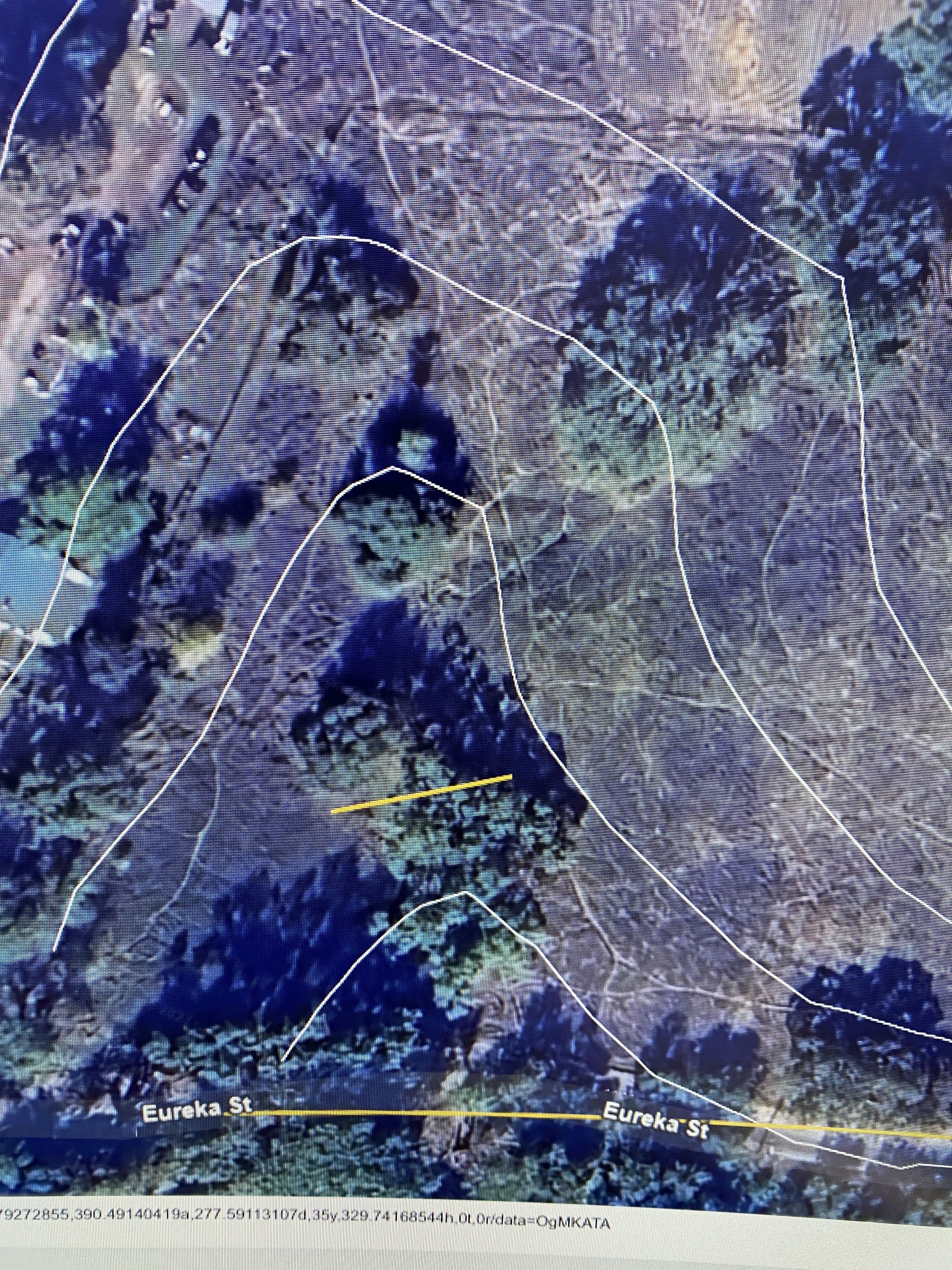

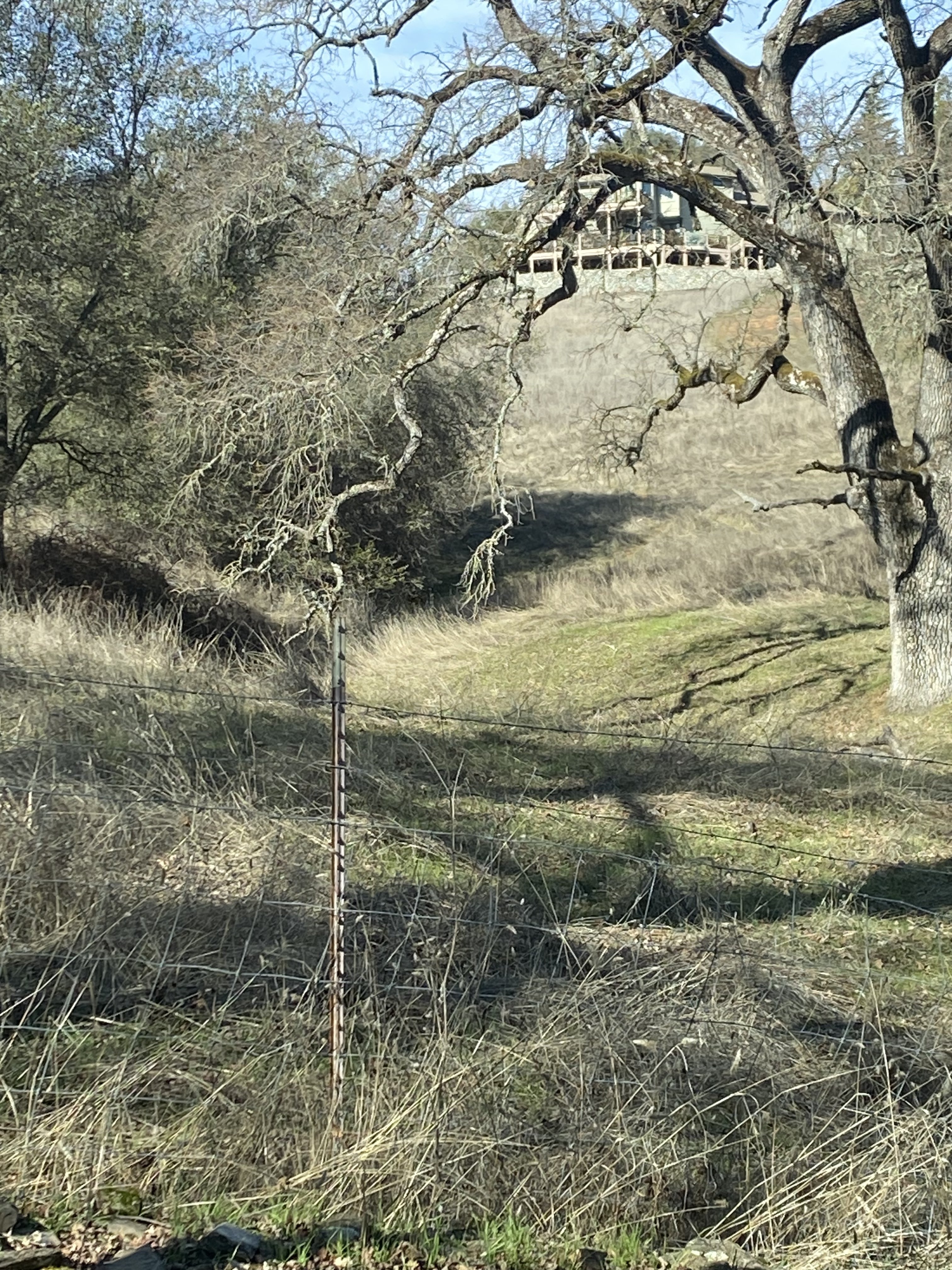

It's hard to see in the photos but the area already has three sides of the pond in place, it just needs a levee on the downstream side to start holding water. Dirt from the hill on the righthand side of the photos would just be brought downstream to the yellow line on the topo map. I don't think it would take more than 100 cubic yards moved, but I would have to scrape and compact the other three hillsides so I'd have to rent a sheepsfoot or something regardless.
Sounds like I'll just have to rent a few things this summer.
