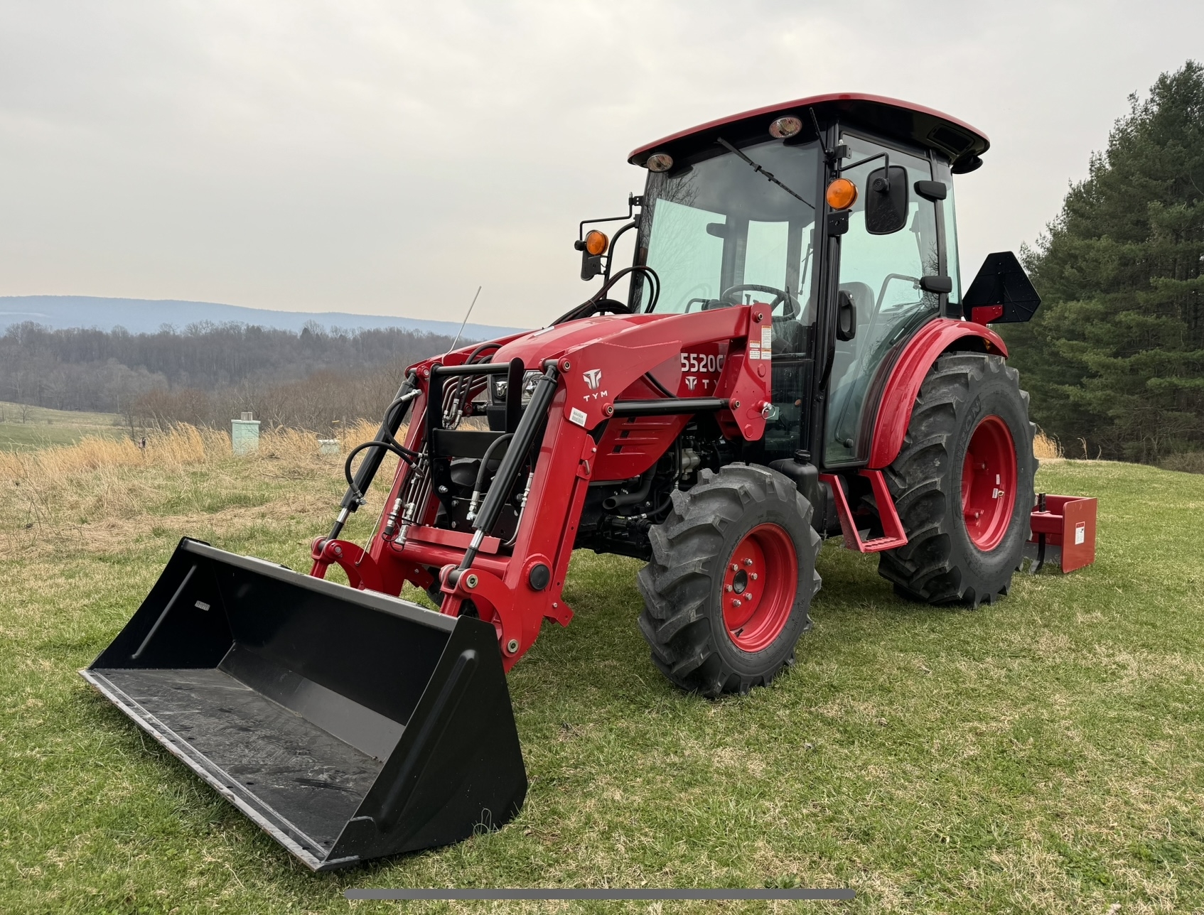

Hi All,
I’ve lurked around on this forum for quite some time, but the realistic possibility of being a tractor owner within the month prompted me to join and get some insight, and hopefully reinforce my thought process.
We moved onto 26 acres nearly three years ago now, but officially bought the house and property last year. Now that we own our little piece of ground, I am in need of my own tractor which leads me to you fine folks. Here are our needs:
  1. We have 3/4 mile long gravel road leading to the house, which despite being a township road is basically private and needs maintaining.
  2. We have a 10 acre field, and a 3 acre field which both need to be maintained. Father-in-law used them occasionally for pasture before he passed, but otherwise simply brush hogged them every year. This practice will continue until I can either pasture it more regularly (we don’t yet have any livestock) or I can put enough into the soil to improve the hay. It’s worth noting that the 3 acre field is very steep. I’m not sure I have the fortitude to brush hog it like my father-in-law did, so tractor stability will come into play.
  3. Ultimately, I would like to get livestock. We’ll likely either get a few horses, or a small beef cow herd, so I’d like a tractor with a loader that can safely move a reasonably sized round bale.
  4. I also want to have the ability to make hay, likely using a square baler, or if able a small round baler.
  5. Finally, I have a ton of small project ideas around the house that a tractor would help with including landscaping, minor dirt work, etc.
Based on that, I’ve made my tractor criteria:
  1. 40+ horsepower
  2. 4 wheel drive (we’re in the mountains of PA)
  3. FEL
  4. Cab (this is admittedly a want)
To get those criteria, I cannot justify paying for a Deere or a Kubota. I’m a fan of both and would buy either if I find a deal, but new prices are astronomical and I have yet to find a good deal on a used one. My local Massey dealer is also way too expensive, and I had a very bad experience with the local LS dealer when they came to look at one of my late father-in-law’s tractors that we sold.
We have two TYM dealers within a reasonable drive. I like both and they have led me to the Branson 5520c. (I don’t like the layout of the TYM T’s.) There is an open house at one of the dealerships in two weeks, at which I expect to purchase.
We do have a local kioti dealer and I will check them out before pulling the trigger, but I like the thought of the kukje engine in the Branson with minimal electronics, and I’m partial to red.
My question for you all then, is whether this is a good fit, a good tractor, or if there are better alternatives to consider.
Thanks in advance!
TLDR.
Need to brush hog, maintain gravel road, and lift a round bale on 26 acres. Pick me a better tractor than a Branson 5520c.

I have yet to see anyone with a cab express regret about getting it. But I do wonder if stepping up in size to a comparably priced, but open station Branson 5835 might be a worthwhile tradeoff.
I’m hoping I’ve overestimated my needs with the 5520, but don’t want to shortly replace this tractor because I bought too small.
I have a 3520 - so same size tractor with smaller engine (and too small, so I wish I’d have gotten a more powerful tractor). I find the tractor too light (and underpowered) when doing roadwork.
Trying to understand the work you want/need to do, I think you’d be better off with the 5835. And all I’ve ever heard is that nobody ever regrets buying a larger tractor. I wish I had.

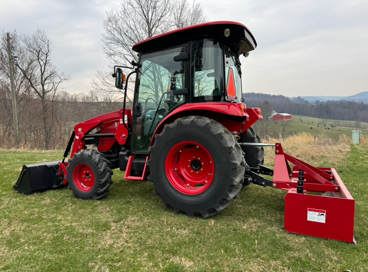

I sure appreciate all these responses! What a great forum!
I went and checked out the Kiotis and Mahindras last Friday. I’m comfortable crossing Kioti off the list, but I was impressed by the Mahindra. Fit and finish wasn’t great, but it’s a lot of tractor for the money and seems to be simple and solid. I drove a 5155, which despite the missing cab, outweighs the Branson by a pretty good margin. They also don’t have DPF or DEF, but rather DOC, which I guess is just a catalytic converter. Though touted as not having emissions equipment, I imagine that converter will go bad at some point and is not likely an inexpensive replacement.
I’m trying to balance this tool to manage farm type duties, as well as regular homeowner stuff, such as mulch. I hope that’s not a mistake. The weight of that Mahindra would put a hurting on the lawn trying to do homeowner stuff with it, and bigger would just make that worse. Open house at the dealer with all the Bransons is this coming weekend. Really looking forward to getting the full comparison then.

My Branson 25 series weighs 7100 lbs and you're right, weight is a factor for traveling over lawns, doing "homeowner" stuff, etc. Right now our frost is out of the ground and everything is soft and soggy. If I were to drive mine across my lawn in these conditions I would make one heck of a mess. Further, no matter time of year, there is a large portion of my front yard I can't drive over for risk of collapsing my septic drain field. I'll have to wait until everything dries out and hardens up before I tackle a few backyard projects I need to deal with this spring.
