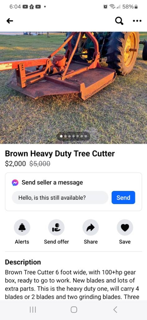

Keep an eye out for a Brown Tree Cutter, 6 ft cutter. They are 5x the attachment of a King Kutter/Bushog, ext. They aren't cheap, but if you're cutting 3"plus stuff routinely, they are the way to go

Something like this, although far from cheap, when you compare vs a brand new, light-medium duty bushhog, is miles ahead. New, I think it's in the $6-8k range.
Overkill if we are talking grass and not small trees/heavy brush.
Overkill if we are talking grass and not small trees/heavy brush.View attachment 879346
Yes, Brown Tree cutters are awesome. Need a bit of PTO horsepower though to operate one. Probably minimum of 50-60 PTO horsepower (haven’t looked at the specs to confirm though).
