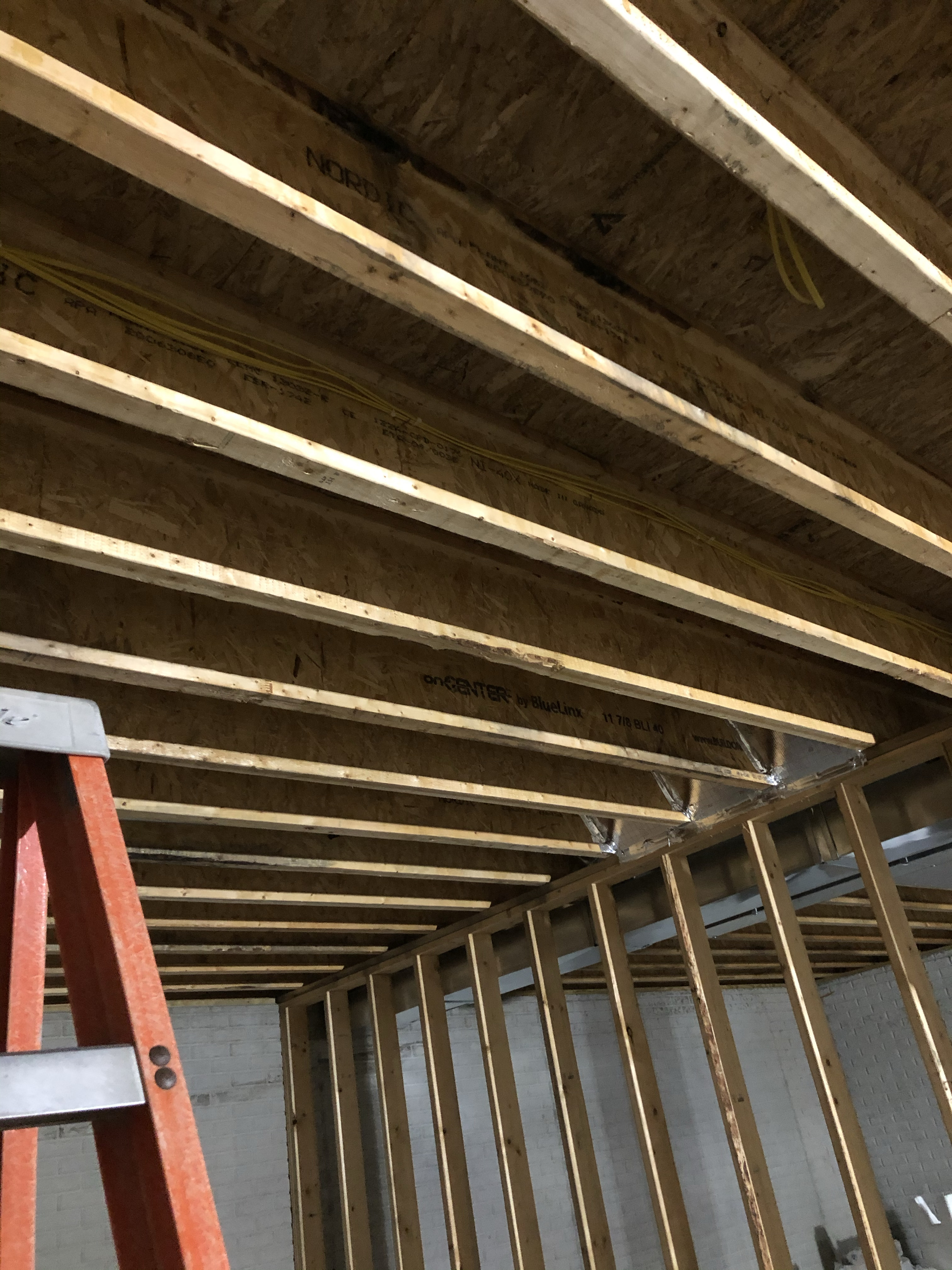

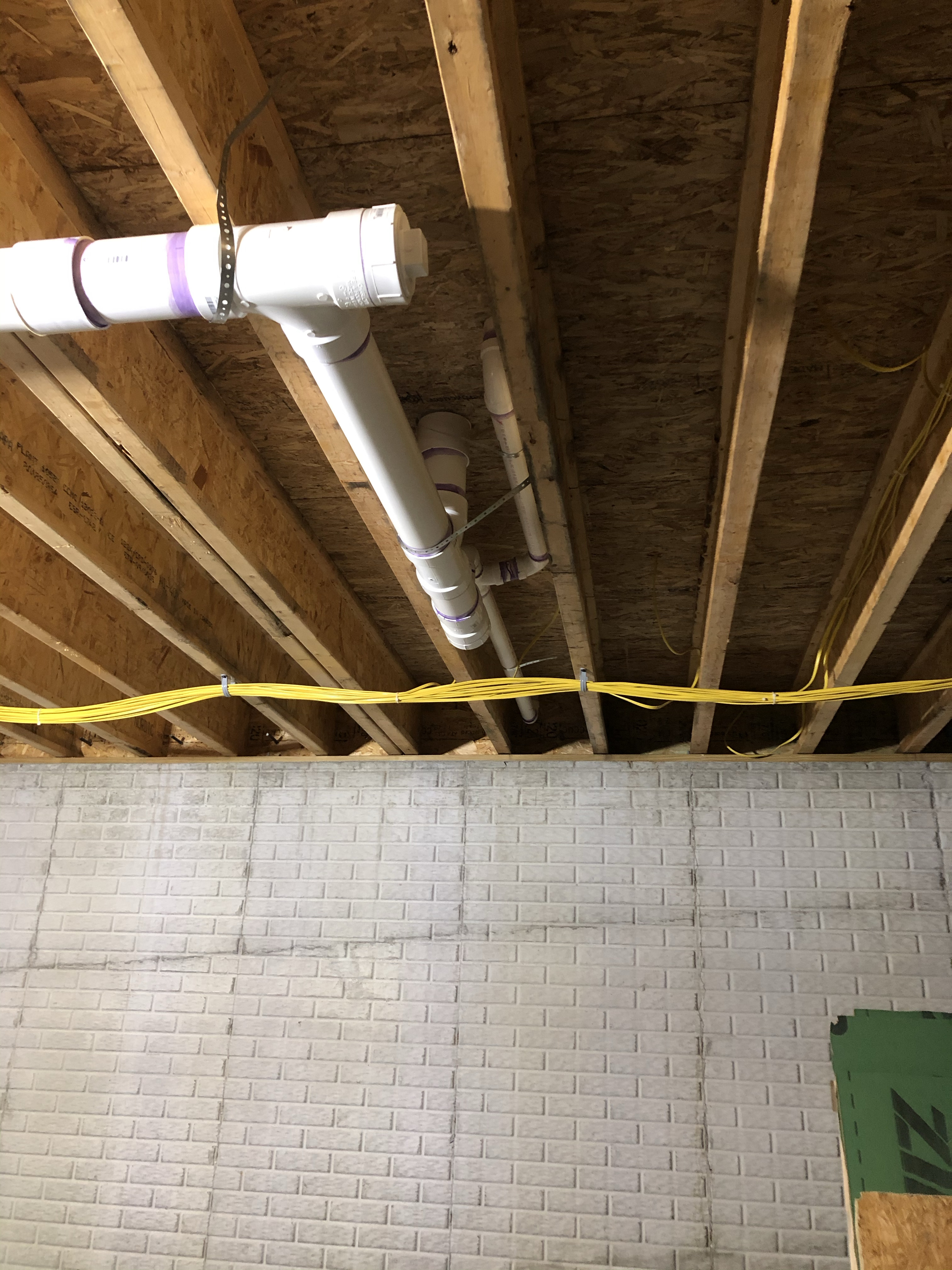

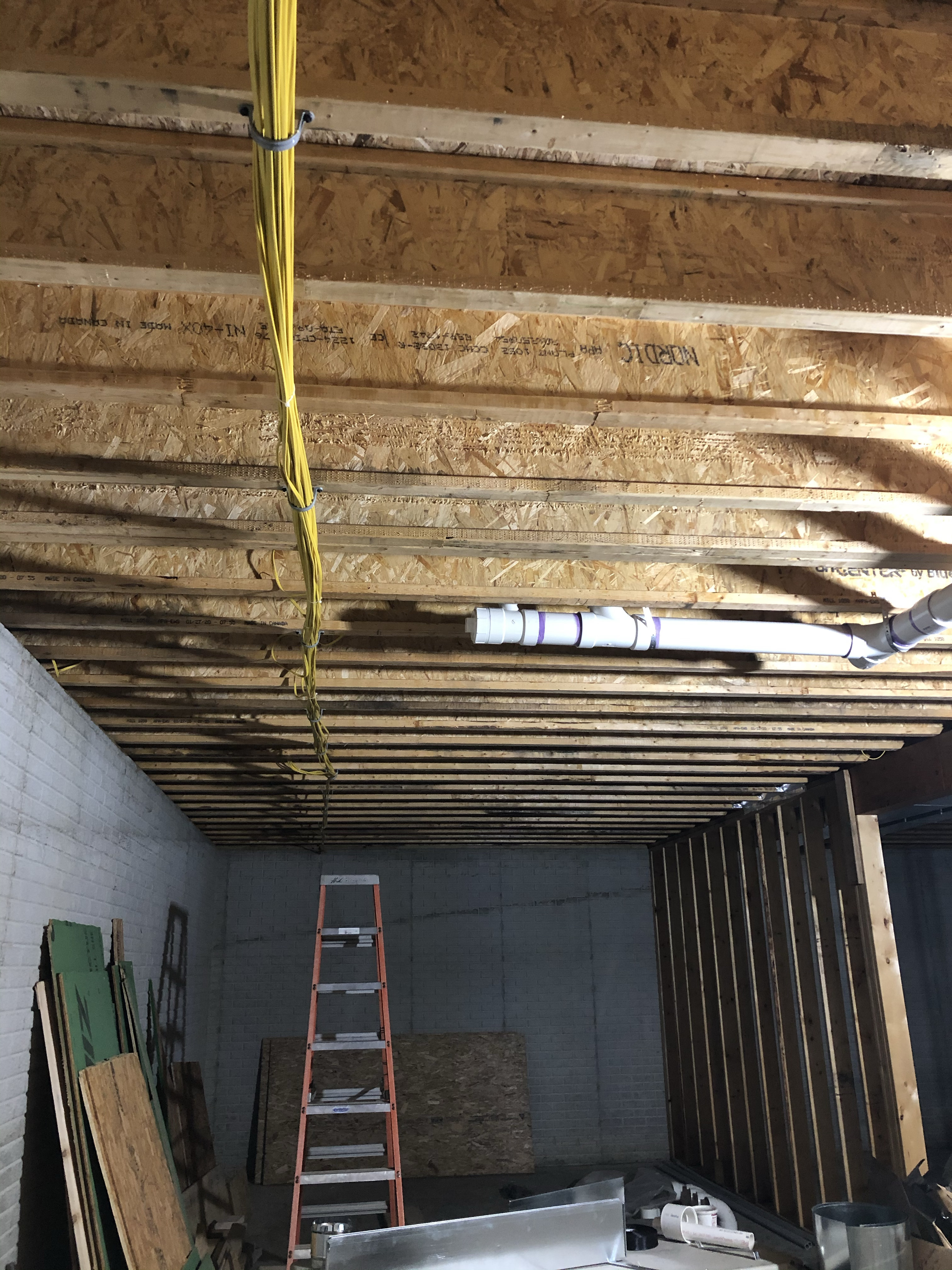

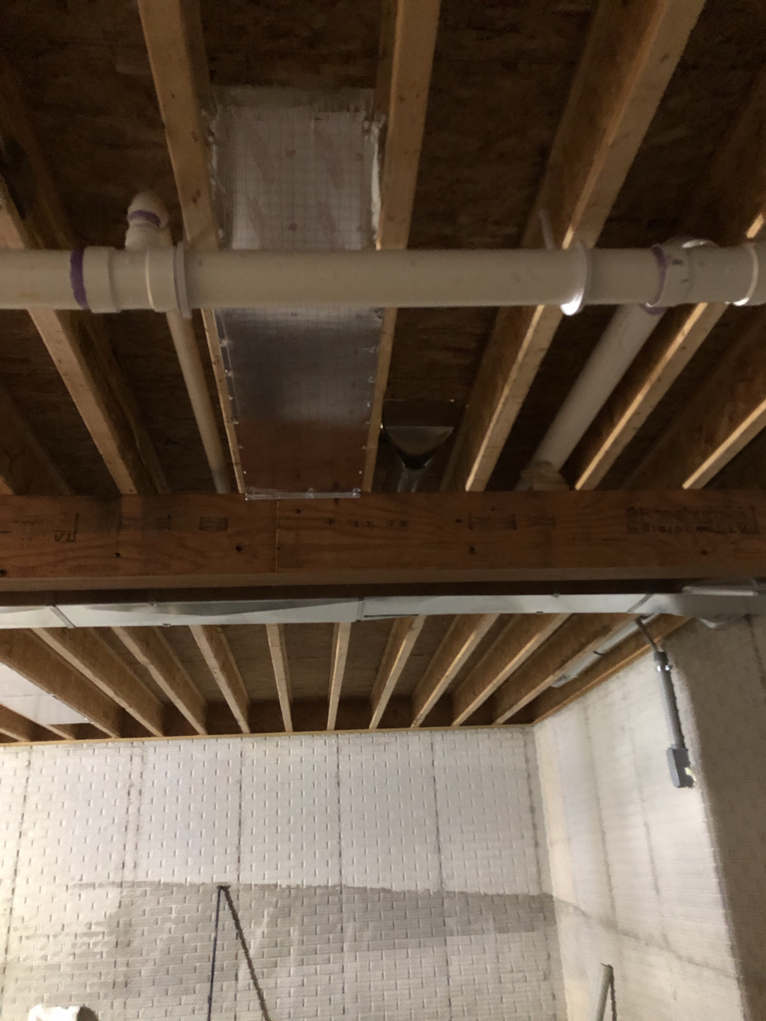

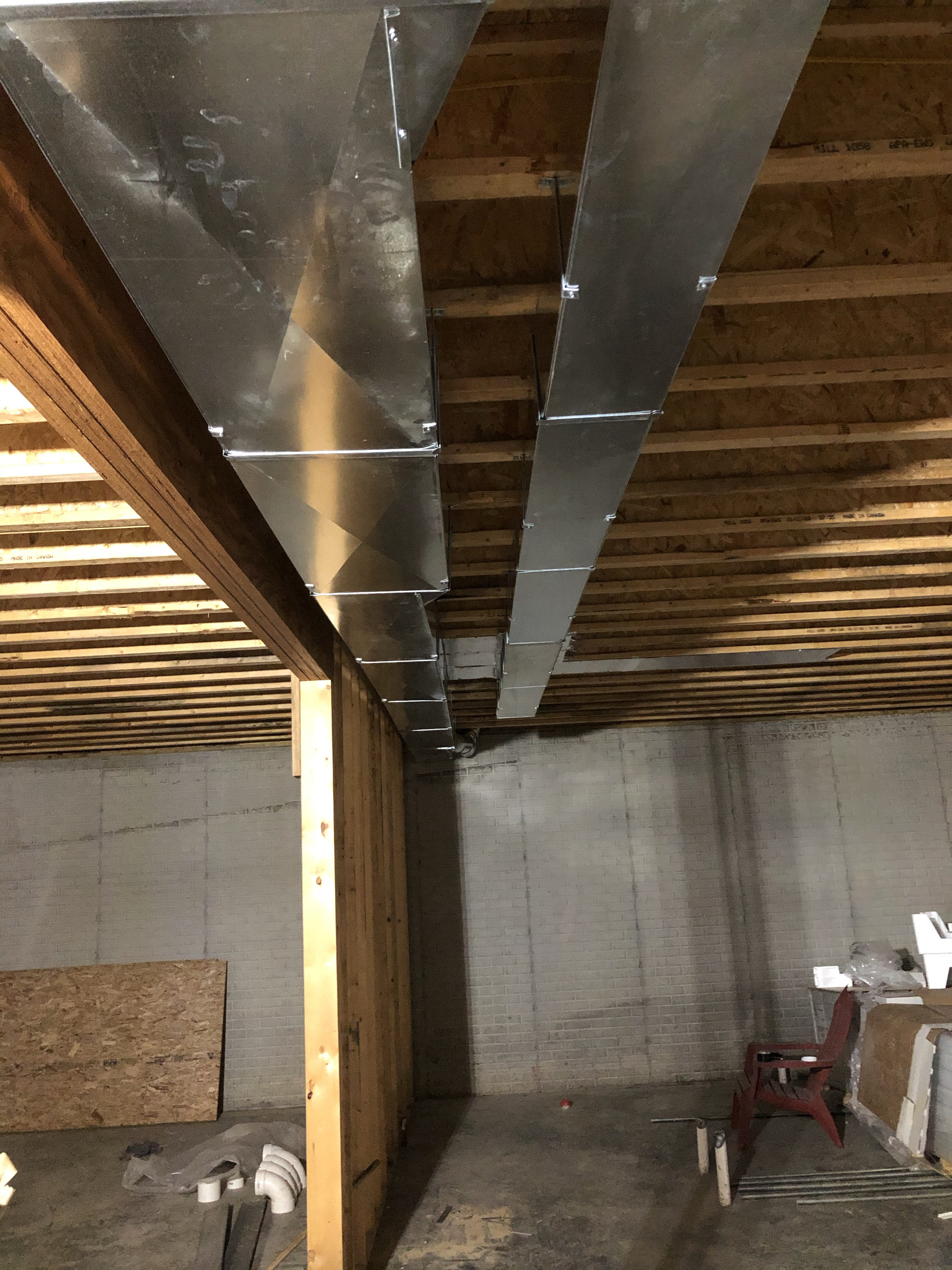

I’ve lacked in posts lately, it’s just been super busy. We have worked non stop, but it’s seems like we never get enough done.
Electrical is about 90% done, just working out some lighting. We want plenty of lighting in the vaulted ceilings but I’m having trouble with layout and figuring how much is enough vs. too much and what to switch together vs. separate. This is especially true in the kitchen, I’ve never wired a house with vaulted ceilings in the kitchen and I’m having trouble deciding what will work best.
Half the house plumbing drains are complete. We had a nice day today, so I took the afternoon off and cut the plumbing vents through the roof. The metal roof made it challenging. 8/12 is steep for metal, and staying on it, even with ropes, is difficult. I guess I need a full harness to make using both hands easier. Got both vents installed and hooked the one side up to the finish plumbing drains.
HVAC is finished until I get the pad poured for the outside unit. Nice to check that off the list.
A few pics of the work.

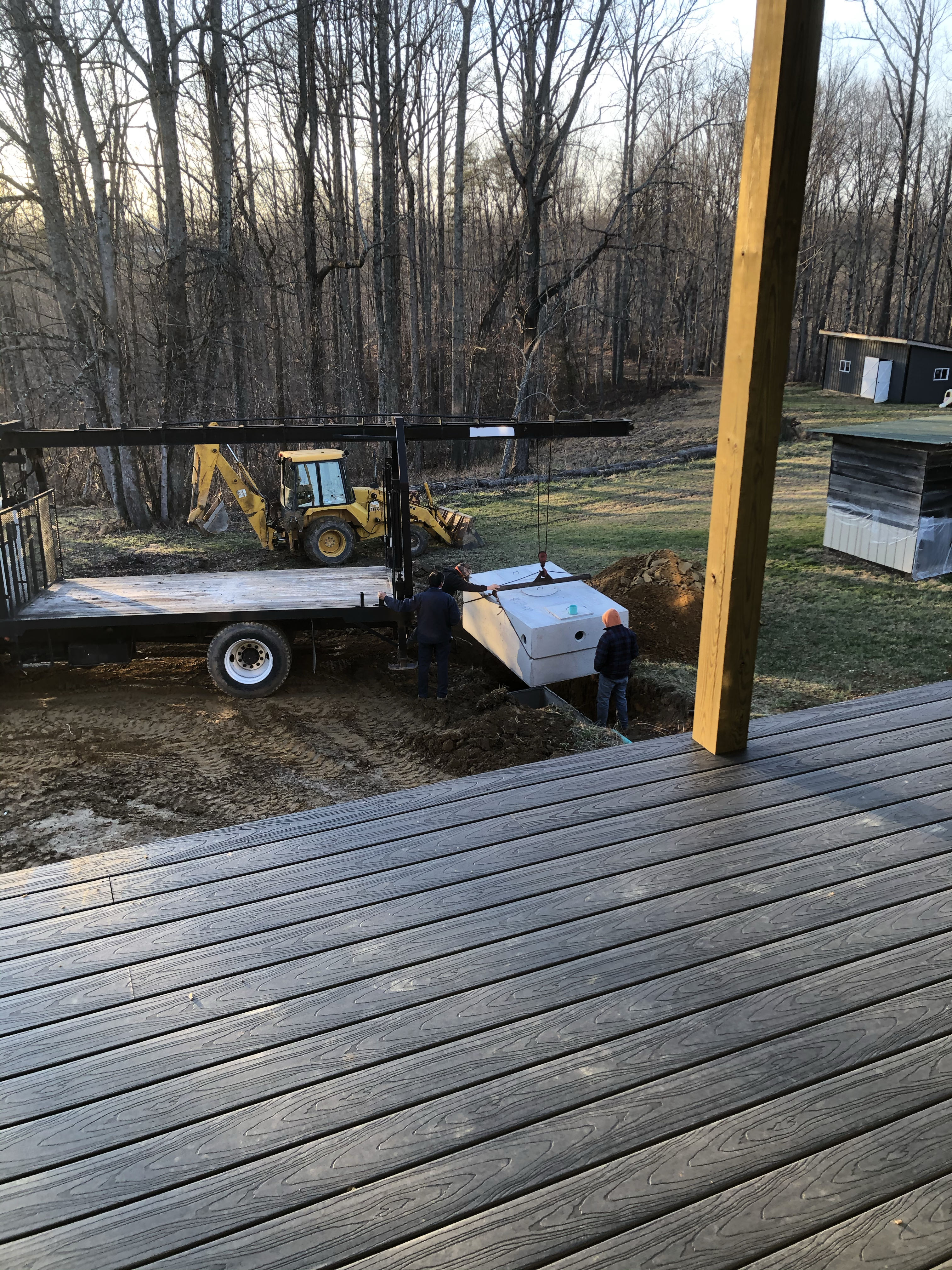

I was planning on installing the septic myself, as I’ve done multiple times before, but decided I don’t have the time and hired it out. They showed up unexpectedly about 3:30 today and within an hour or so had the hole dug, tank set, hooked up to the sewer line coming out of the house, and buried. Those guys don’t mess around, it was their second system of the day, taking advantage of the nice January weather. They will complete the install of the aerator and drain field tomorrow.

What is the size of that tank?
Looks kinda small in the pictures.

1200 gallons. It’s two Pieces, bottom half is already in the hole. Looks pretty big in person. There will be another tank that houses the aerator, not sure on its size, and 900 sq. ft. of leach field. Unfortunately, it’ll all be buried before I get home to take pictures.

Try to get someone to take pictures for you!
Pictures can be VERY helpful if you should have future septic problems.
1200 gallons should be good for up to, and including, 4 bedrooms.
No garbage disposal....EVER !!!
