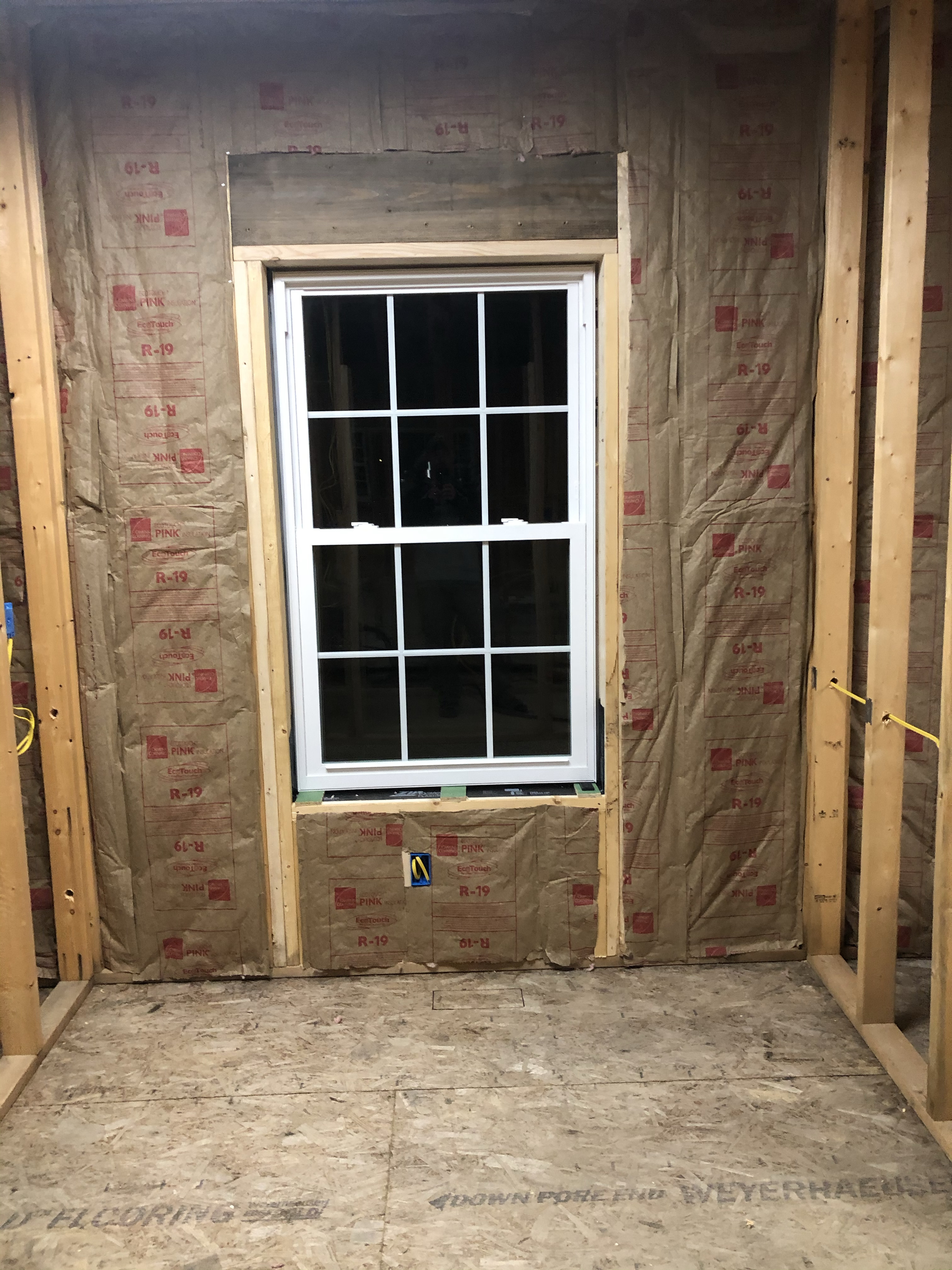

Merry Christmas!!
The window looks nice.
   / New House Build in WV #262
Windows look great. Are you you weathertight now?

Slow progress but we are getting there. Wiring is about 85% done. AEP showed up unexpectedly on Tuesday and hooked power up. They told me the day before that it would be the end of January, so that was a nice surprise.
I hooked a circuit up in the panel and installed a recept so I don’t need an extension cord from the current house. I may work on getting the rest of the circuits in the panel tomorrow.
Wife and her dad started insulating outside walls that are ready. Hopefully they will continue with that tomorrow.
Wife’s closet
Master bedroom
