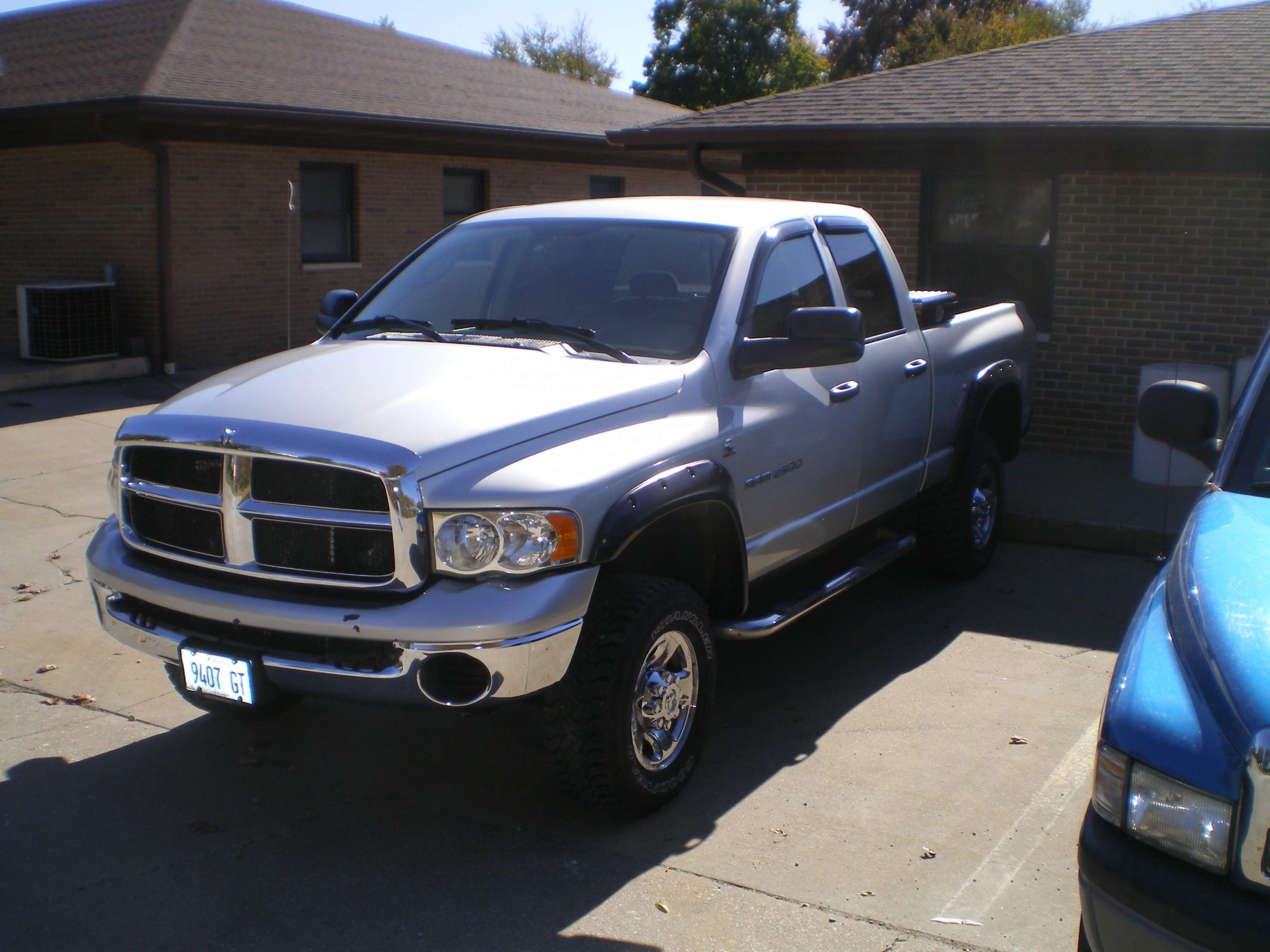

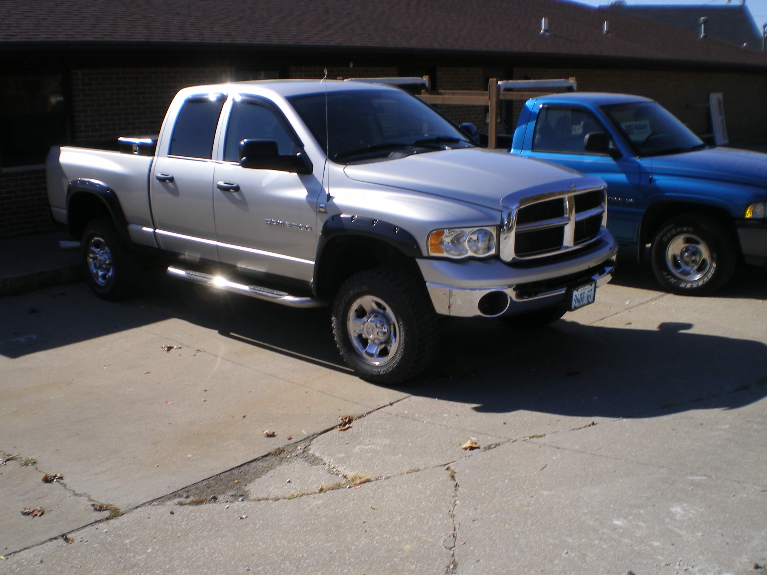

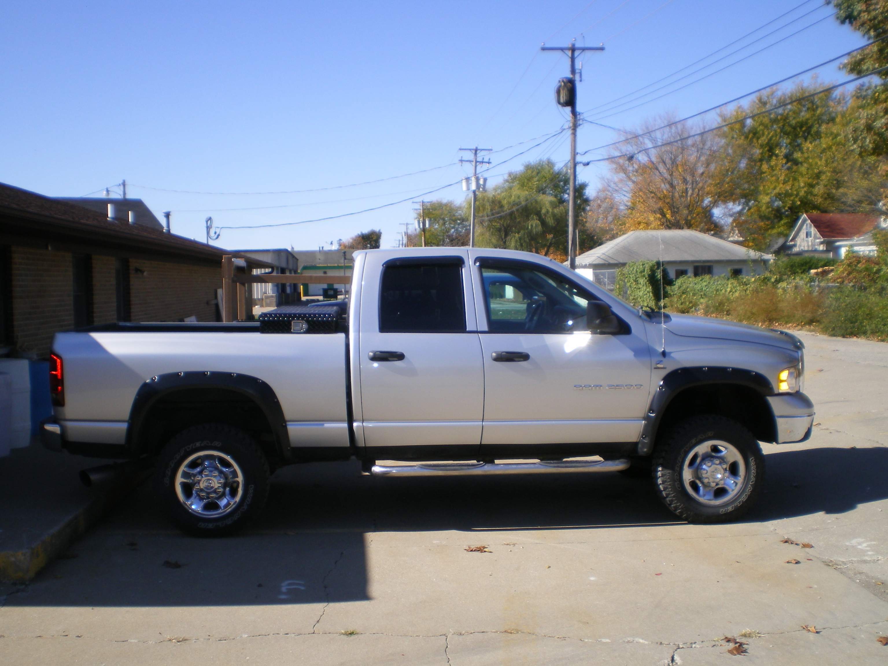

Here is a picture of my new to me 2004 Dodge Ram. Its a 3/4 ton, 305 hp 24 valve 5.9 Cummins. Its an automatic, 4.10 gears, has an Edge Chip and an Air Raid Jr. setup on it. It has also had some kind of exhaust work on it, but I'm not sure what kind. I also think, but I'm not sure, that it has a leveling kit. It has 106,000 miles on it, the interior is in great shape, the exterior is what I would call fair to good, it has a few battle scars. So far I've been happy with it, I've just put a few miles on it, but I'm getting around 20 mpg driving back and forth to work and such. I tried a couple of engine photos, but they came out blurry.

Great lookin truck. Same color as mine. Looks leveled to me. I think the stock downpipe on that year was 3.5". If your aftermarket is turbo back its probably 4" or bigger.

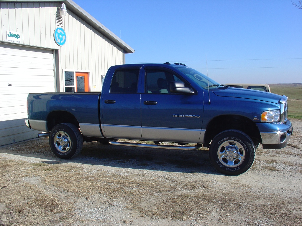

Cats came into play with late model '04s as a part of the higher HP change. Early model '04s did not have a Cat.
I tell early '04s from late '04s at a glance by the location of the Cummins emblem. My early '04 had the emblem at the front of the fender. My buddies late '04 has the emblem where the OPs emblem is. I think you can see the difference in my attached picture.
I think the OP meant he suspected it came from the factory with a Cat and that it had been removed along with the muffler.

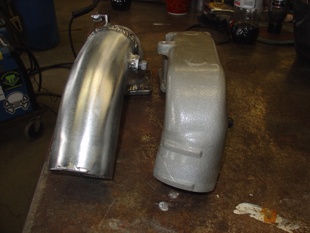

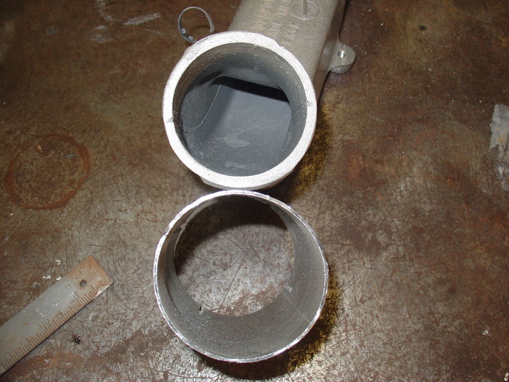

I purchased a 5" MBRP system with muffler, took out the baffle in the intake tube, built a manifold tube, added an Edge module to mine and consistantly got 22 mpg on the highway at 70 mph. My 7.3 Powerstroke won't get close to that.
I attached a pic of the manifold tube modification. It really helped low end torque.

My truck says 12/03 on the door, so I don't know if it had a cat or not from the factory. You are correct, my emblems are back farther on the truck. The decal on the engine says 305 horsepower. I was thinking the higher output ones were 325 or 335, but I'm not sure.
