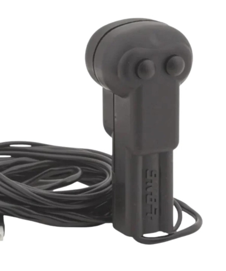

No, my wr long came with a replacement grip for the joystice with 2 buttons. There was one pipe fitting that is eliminated in my install. Had to remove seat to get to it.
Did not know this. Last one I saw didnt.

If it came with the Joystick w/ the buttons, pretty sure it was the Kioti kit.

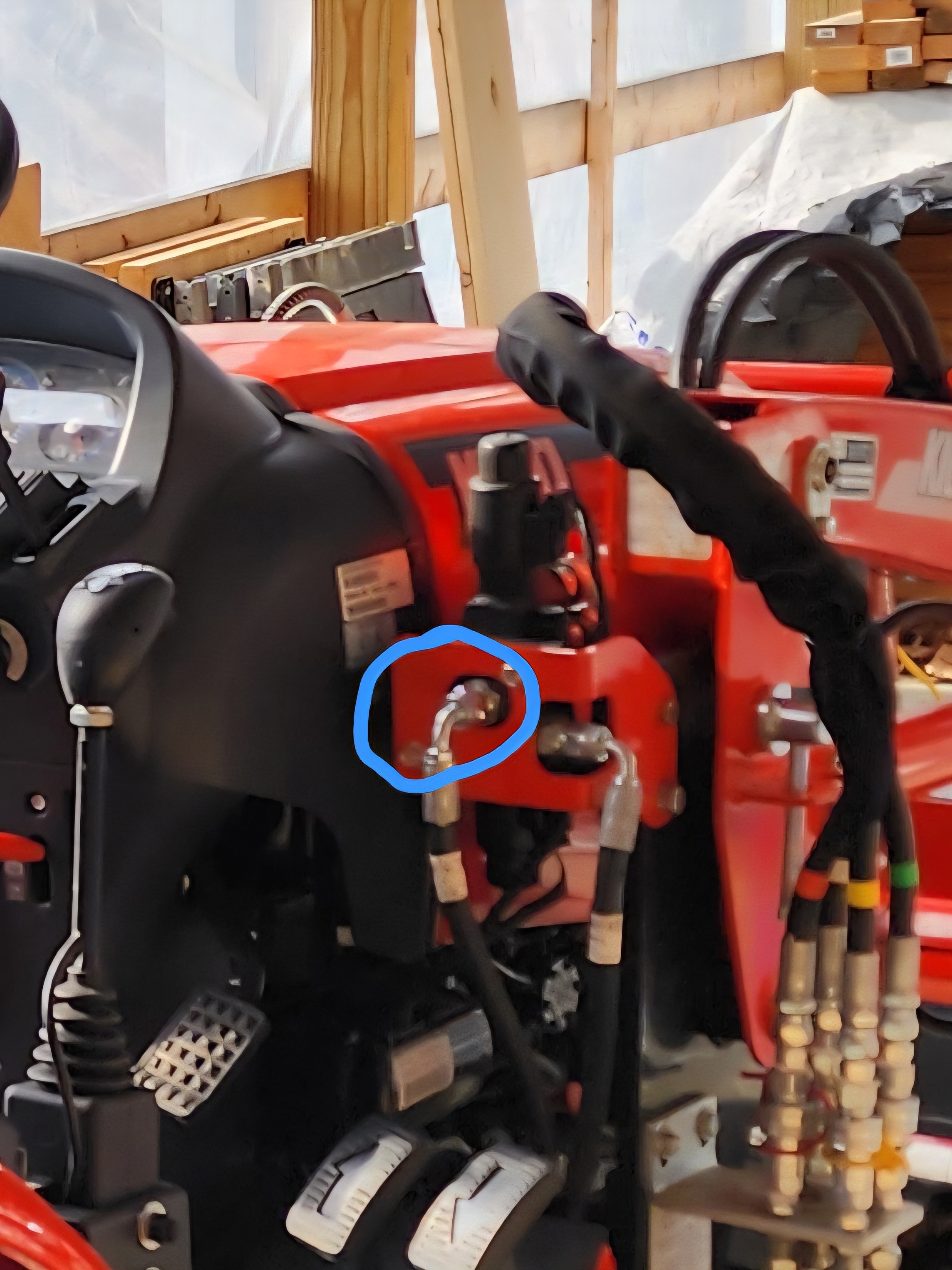

The valve is installed under the right step.
The KIOTI 3rd Function Valve for a CX2510 does not mount under the right step. The KIOTI Valve mounts to the RH Front Loader Bracket.

I do not know hydraulics, but wanted to chime in on the joystick. The buttons are for 3rd function, whatever it may be. Up/down, open/close etc.
dealer told me to install 3rd function, they sell a kit that attaches to joystick to run to hydraulics. Maybe it's just a Kioti brand of what aftermarkets sell. Doesn't sound like that dealer is too promising. Good luck. New Kioti here, only issue is with me getting used to it, and comparing to last tractor. Guess they don't all operate identically. I do miss the fancy seat that my NH had.

Does the valve they installed look like this?
Hope this helps
