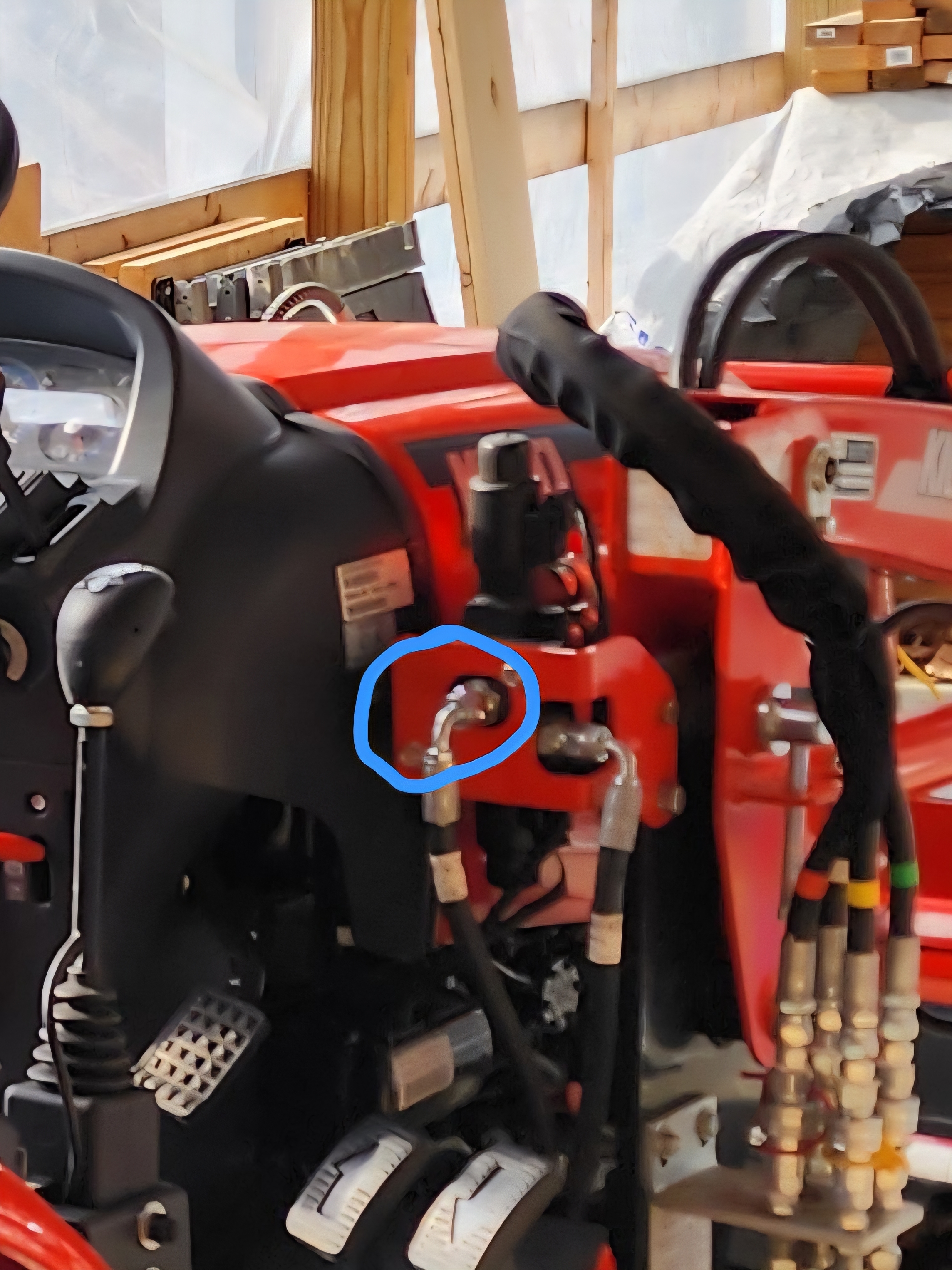

Thank you for your input, but all that is pretty much Greek to us. We did not install the valve ourselves as we requested that the 3rd function be put on the tractor we had just bought before it was delivered.
Understand about possibility of blockage or debris. Will check it out.
This gets extremely hot, wouldn't want to hold onto it for long.View attachment 5207983
This is the KIOTI 3rd Function Kit for the CK2510 / CX2510 tractors. You had mentioned in your previous post it was "under the right step". This is the loader bracket mounted 3rd Function Valve.
Obviously, this should get warm, but not hot. As previously mentioned, make sure the P and T ports are plumbed properly. P port on the 3rd Function Valve from the Joystick Valve Power Beyond, T port back to the the port the original Power Beyond pipe was removed from. If plumbed properly, 2 other possibilities; the 3rd Function Valve is constantly powered, from either faulty switches or improper harness installation, or if the tractor has Rear Remotes, the lever is not in neutral.

Here is a link to a Summit install of a 3rd function on a CX, it will give you something to compare your setup to.
To the OP are you aware of how to operate your 3rd function? You should have two seperate switchs each switch will activate one solenoid, one to (open) while held, the other to (close) while held. The solinoids should not be energized unless you are holding a switch.
